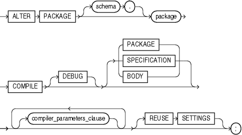

The ALTER PACKAGE statement explicitly recompiles a package specification, body, or both. Explicit recompilation eliminates the need for implicit run-time recompilation and prevents associated run-time compilation errors and performance overhead.
Because all objects in a package are stored as a unit, the ALTER PACKAGE statement recompiles all package objects together. You cannot use the ALTER PROCEDURE statement or ALTER FUNCTION statement to recompile individually a procedure or function that is part of a package.
This statement does not change the declaration or definition of an existing package. To redeclare or redefine a package, use the CREATE PACKAGE Statement, or the CREATE PACKAGE BODY Statement with theOR REPLACE clause.For you to modify a package, the package must be in your own schema or you must have ALTER ANY PROCEDURE system privilege.
Keyword and Parameter Descriptions
Specify the schema containing the package. If you omit schema, then the database assumes the package is in your own schema.
Specify the name of the package to be recompiled.
You must specify COMPILE to recompile the package specification or body. The COMPILE keyword is required.
During recompilation, the database drops all persistent compiler switch settings, retrieves them again from the session, and stores them at the end of compilation. To avoid this process, specify the REUSE SETTINGS clause.
If recompiling the package results in compilation errors, then the database returns an error and the body remains invalid. You can see the associated compiler error messages with the SQL*Plus command SHOW ERRORS.
See Also:
Recompiling a Package: ExamplesSpecify SPECIFICATION to recompile only the package specification, regardless of whether it is invalid. You might want to recompile a package specification to check for compilation errors after modifying the specification.
When you recompile a package specification, the database invalidates any local objects that depend on the specification, such as procedures that call procedures or functions in the package. The body of a package also depends on its specification. If you subsequently reference one of these dependent objects without first explicitly recompiling it, then the database recompiles it implicitly at run time.
Specify BODY to recompile only the package body regardless of whether it is invalid. You might want to recompile a package body after modifying it. Recompiling a package body does not invalidate objects that depend upon the package specification.
When you recompile a package body, the database first recompiles the objects on which the body depends, if any of those objects are invalid. If the database recompiles the body successfully, then the body becomes valid.
Specify PACKAGE to recompile both the package specification and the package body if one exists, regardless of whether they are invalid. This is the default. The recompilation of the package specification and body lead to the invalidation and recompilation of dependent objects as described for SPECIFICATION and BODY.
Specify DEBUG to instruct the PL/SQL compiler to generate and store the code for use by the PL/SQL debugger. Specifying this clause has the same effect as specifying PLSQL_DEBUG = TRUE in the compiler_parameters_clause.
See Also:
Oracle Database PL/SQL Packages and Types Reference for information about debugging packagesThis clause has the same behavior for a package as it does for a function. See the ALTER FUNCTION compiler_parameters_clause.
This clause has the same behavior for a package as it does for a function. See the ALTER FUNCTION clause REUSE SETTINGS.
