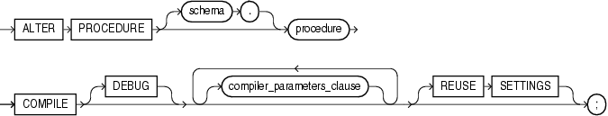

The ALTER PROCEDURE statement explicitly recompiles a standalone stored procedure. Explicit recompilation eliminates the need for implicit run-time recompilation and prevents associated run-time compilation errors and performance overhead.
To recompile a procedure that is part of a package, recompile the entire package using the ALTER PACKAGE Statement).
This statement does not change the declaration or definition of an existing procedure. To redeclare or redefine a standalone stored procedure, use the CREATE PROCEDURE Statement with theOR REPLACE clause.The ALTER PROCEDURE statement is very similar to the ALTER FUNCTION statement. See ALTER FUNCTION Statement for more information.

Specify the schema containing the procedure. If you omit schema, then the database assumes the procedure is in your own schema.
Specify the name of the procedure to be recompiled.
Specify COMPILE to recompile the procedure. The COMPILE keyword is required. the database recompiles the procedure regardless of whether it is valid or invalid.

Recompiling a Procedure: ExampleSpecify DEBUG to instruct the PL/SQL compiler to generate and store the code for use by the PL/SQL debugger. Specifying this clause is the same as specifying PLSQL_DEBUG = TRUE in the compiler_parameters_clause.

This clause has the same behavior for a procedure as it does for a function. See the ALTER FUNCTION clause REUSE SETTINGS.
