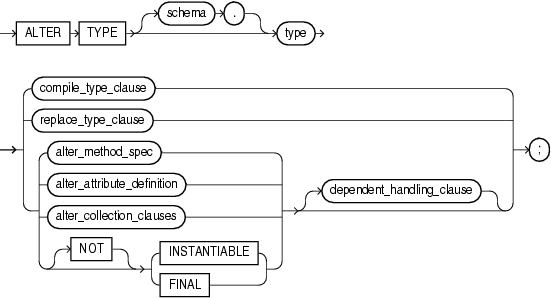

The ALTER
TYPE
statement adds or drops member attributes or methods. You can change the existing properties (FINAL
or INSTANTIABLE
) of an object type, and you can modify the scalar attributes of the type.
You can also use this statement to recompile the specification or body of the type or to change the specification of an object type by adding new object member subprogram specifications.
The object type must be in your own schema and you must have CREATE
TYPE
or CREATE
ANY
TYPE
system privilege, or you must have ALTER
ANY
TYPE
system privileges.
(compile_type_clause ::=, replace_type_clause ::=, alter_method_spec ::=, alter_attribute_definition::=, alter_collection_clauses::=, dependent_handling_clause ::=)
element_spec ::=
(inheritance_clauses::=, subprogram_spec::=, constructor_spec::=, map_order_function_spec::=, pragma_clause ::=)
(procedure_spec::=, function_spec::=)
pragma_clause ::=
(map_order_function_spec::=, subprogram_spec::=)

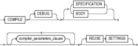

Specify COMPILE
to compile the object type specification and body. This is the default if neither SPECIFICATION
nor BODY
is specified.
During recompilation, the database drops all persistent compiler switch settings, retrieves them again from the session, and stores them at the end of compilation. To avoid this process, specify the REUSE
SETTINGS
clause.
If recompiling the type results in compilation errors, then the database returns an error and the type remains invalid. You can see the associated compiler error messages with the SQL*Plus command SHOW
ERRORS
Specify DEBUG
to instruct the PL/SQL compiler to generate and store the code for use by the PL/SQL debugger. Specifying this clause has the same effect as specifying PLSQL_DEBUG
= TRUE
in the compiler_parameters_clause
Specify SPECIFICATION
to compile only the object type specification.
Specify BODY
to compile only the object type body.
This clause has the same behavior for a type as it does for a function. See the ALTER
FUNCTION
compiler_parameters_clause.
FUNCTION
clause REUSE SETTINGS.

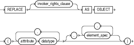

The REPLACE
clause lets you add new member subprogram specifications. This clause is valid only for object types, not for nested tables or varrays.
Specify an object attribute name. Attributes are data items with a name and a type specifier that form the structure of the object.
Specify the elements of the redefined object.

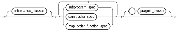

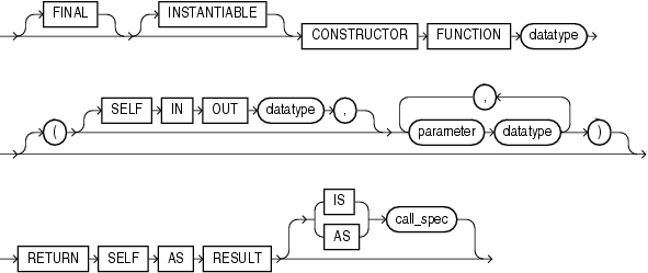

inheritance_clauses The inheritance_clauses
have the same semantics in CREATE
TYPE
and ALTER
TYPE
statements.
subprogram_spec The
MEMBER
and STATIC
clauses let you specify for the object type a function or procedure subprogram which is referenced as an attribute.
You must specify a corresponding method body in the object type body for each procedure or function specification.
See Also:
CREATE TYPE Statement for a description of the difference between member and static methods, and for examples
Overloading PL/SQL Subprogram Names for information about overloading subprogram names within a package
procedure_spec Enter the specification of a procedure subprogram.
function_spec Enter the specification of a function subprogram.

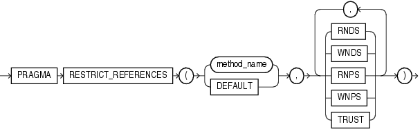

pragma_clause The pragma_clause
is a compiler directive that denies member functions read/write access to database tables, packaged variables, or both, and thereby helps to avoid side effects.
This clause has been deprecated. Oracle recommends against using this clause unless you must do so for backward compatibility of your applications. the database now runs purity checks at run time. If you must use this clause for backward compatibility of your applications, see its description in CREATE TYPE Statement.Restriction on Pragmas The pragma_clause
is not valid when dropping a method.
See Also:
Oracle Database Advanced Application Developer's Guide for more information about pragmasmap_order_function_spec You can declare either one MAP

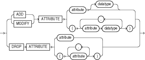

The alter_attribute_definition
clause lets you add, drop, or modify an attribute of an object type. In one ALTER
TYPE
statement, you can add, drop, or modify multiple member attributes or methods, but you can reference each attribute or method only once.
ADD ATTRIBUTE The name of the new attribute must not conflict with existing attributes or methods in the type hierarchy. the database adds the new attribute to the end of the locally defined attribute list.
If you add the attribute to a supertype, then it is inherited by all of its subtypes. In subtypes, inherited attributes always precede declared attributes. Therefore, you might need to update the mappings of the implicitly altered subtypes after adding an attribute to a supertype.
See Also:
Adding a Collection Attribute: ExampleDROP ATTRIBUTE When you drop an attribute from a type, the database drops the column corresponding to the dropped attribute as well as any indexes, statistics, and constraints referencing the dropped attribute.
You need not specify the data type of the attribute you are dropping.
Restrictions on Dropping Type Attributes Dropping type attributes is subject to the following restrictions:
You cannot drop an attribute inherited from a supertype. Instead you must drop the attribute from the supertype.
You cannot drop an attribute that is part of a partitioning, subpartitioning, or cluster key.
You cannot drop an attribute of a primary-key-based object identifier of an object table or a primary key of an index-organized table.
You cannot drop all of the attributes of a root type. Instead you must drop the type. However, you can drop all of the locally declared attributes of a subtype.
MODIFY ATTRIBUTE This clause lets you modify the data type of an existing scalar attribute. For example, you can increase the length of a VARCHAR2
or RAW
attribute, or you can increase the precision or scale of a numeric attribute.
Restriction on Modifying Attributes You cannot expand the size of an attribute referenced in a function-based index, domain index, or cluster key.

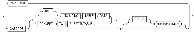

Use this clause to indicate whether any further subtypes can be created for this type:
Specify FINAL
if no further subtypes can be created for this type.
Specify NOT
FINAL
if further subtypes can be created under this type.
If you change the property between FINAL
and NOT
FINAL
, then you must specify the CASCADE
clause of the dependent_handling_clause to convert data in dependent columns and tables.

The dependent_handling_clause
lets you instruct the database how to handle objects that are dependent on the modified type. If you omit this clause, then the ALTER
TYPE
statement will terminate if type
has any dependent type or table.
Specify INVALIDATE
to invalidate all dependent objects without any checking mechanism.
the database does not validate the type change, so you should use this clause with caution. For example, if you drop an attribute that is a partitioning or cluster key, then you will be unable to write to the table.Specify the CASCADE
clause if you want to propagate the type change to dependent types and tables. the database terminates the statement if any errors are found in the dependent types or tables unless you also specify FORCE
If you change the property of the type between FINAL
and NOT
FINAL
, then you must specify this clause to convert data in dependent columns and tables. See [NOT] FINAL.
INCLUDING TABLE DATA Specify INCLUDING
TABLE
DATA
to convert data stored in all user-defined columns to the most recent version of the column type. This is the default.
You must specify this clause if your column data is in Oracle database version 8.0 image format. This clause is also required if you are changing the type property betweenFINAL
and NOT
FINAL
For each attribute added to the column type, the database adds a new attribute to the data and initializes it to null.
For each attribute dropped from the referenced type, the database removes the corresponding attribute data from each row in the table.
If you specify INCLUDING
TABLE
DATA
, then all of the tablespaces containing the table data must be in read/write mode.
If you specify NOT
INCLUDING
TABLE
DATA
, then the database upgrades the metadata of the column to reflect the changes to the type but does not scan the dependent column and update the data as part of this ALTER
TYPE
statement. However, the dependent column data remains accessible, and the results of subsequent queries of the data will reflect the type modifications.

exceptions_clause Specify FORCE
if you want the database to ignore the errors from dependent tables and indexes and log all errors in the specified exception table. The exception table must already have been created by executing the DBMS_UTILITY.CREATE_ALTER_TYPE_ERROR_TABLE
