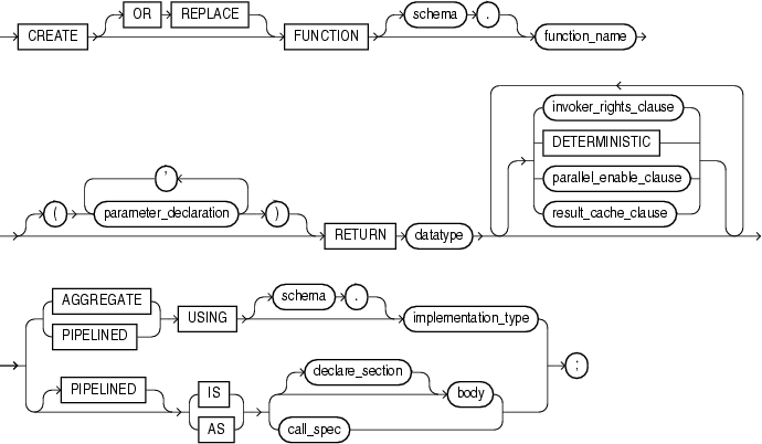

The CREATE FUNCTION statement creates or replaces a standalone stored function or a call specification.
A standalone stored function is a function (a subprogram that returns a single value) that is stored in the database.

Specify OR REPLACE to re-create the function if it already exists. Use this clause to change the definition of an existing function without dropping, re-creating, and regranting object privileges previously granted on the function. If you redefine a function, then the database recompiles it.
Users who had previously been granted privileges on a redefined function can still access the function without being regranted the privileges.
If any function-based indexes depend on the function, then the database marks the indexes DISABLED.
Specify the schema to contain the function. If you omit schema, then the database creates the function in your current schema.
Specify the name of the function to be created.
For datatype, specify the data type of the return value of the function. The return value can have any data type supported by PL/SQL.
Oracle SQL does not support calling of functions with Boolean parameters or returns. Therefore, if your user-defined functions will be called from SQL statements, you must design them to return numbers (0 or 1) or character strings ('TRUE' or 'FALSE').The data type cannot specify a length, precision, or scale. The database derives the length, precision, or scale of the return value from the environment from which the function is called.
If the return type is ANYDATASET and you intend to use the function in the FROM clause of a query, then you must also specify the PIPELINED clause and define a describe method (ODCITableDescribe) as part of the implementation type of the function.
You cannot constrain this data type (with NOT NULL, for example).

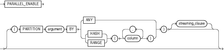

PARALLEL_ENABLE is an optimization hint indicating that the function can be executed from a parallel execution server of a parallel query operation. The function should not use session state, such as package variables, as those variables are not necessarily shared among the parallel execution servers.
The optional PARTITION argument BY clause is used only with functions that have a REF CURSOR argument type. It lets you define the partitioning of the inputs to the function from the REF CURSOR argument.
Partitioning the inputs to the function affects the way the query is parallelized when the function is used as a table function in the FROM clause of the query. ANY indicates that the data can be partitioned randomly among the parallel execution servers. Alternatively, you can specify RANGE or HASH partitioning on a specified column list.
The optional streaming_clause lets you order or cluster the parallel processing by a specified column list.
ORDER BY indicates that the rows on a parallel execution server must be locally ordered.
CLUSTER BY indicates that the rows on a parallel execution server must have the same key values as specified by the column_list.
expr identifies the REF CURSOR parameter name of the table function on which partitioning was specified, and on whose columns you are specifying ordering or clustering for each slave in a parallel query execution.
The columns specified in all of these optional clauses refer to columns that are returned by the REF CURSOR argument of the function.
