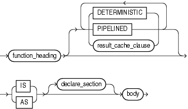

A function is a subprogram that returns a single value. You must declare and define a function before invoking it. You can either declare and define it at the same time, or you can declare it first and then define it later in the same block.
This topic applies to functions that you declare and define inside a PL/SQL block or package, which are different from standalone stored functions that you create with the CREATE FUNCTION Statement.(parameter_declaration ::=, datatype ::=)
(body ::=, declare_section ::=)

Specify DETERMINISTIC
to indicate that the function returns the same result value whenever it is invoked with the same values for its parameters. This helps the optimizer avoid redundant function calls: If a stored function was invoked previously with the same arguments, the optimizer can elect to use the previous result.

Only DETERMINISTIC
functions can be invoked from a function-based index or a materialized view that has query-rewrite enabled. For more information and possible limitations of the DETERMINISTIC

PIPELINED
specifies to return the results of a table function iteratively. A table function returns a collection type (a nested table or varray) with elements that are SQL data types. You can query table functions using the TABLE
