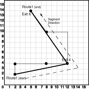

SDO_UTIL.SIMPLIFY(
geometry IN SDO_GEOMETRY,
threshold IN NUMBER
tolerance IN NUMBER DEFAULT 0.0000005
) RETURN SDO_GEOMETRY;
Simplifies the input geometry, based on a threshold value, using the Douglas-Peucker algorithm.
Geometry to be simplified.
Threshold value to be used for the geometry simplification. Should be a positive number. (Zero causes the input geometry to be returned.) If the input geometry is geodetic, the value is the number of meters; if the input geometry is non-geodetic, the value is the number of units associated with the data.
As the threshold value is decreased, the returned geometry is likely to be closer to the input geometry; as the threshold value is increased, fewer points are likely to be in the returned geometry. See the Usage Notes for more information.
Tolerance value (see Section 1.5.5). Must not be greater than threshold; and for better performance, should not be the same as threshold. If you do not specify a value, the default value is 0.0000005.
This function also convert arcs to line stings, eliminates duplicate vertices, and corrects many overlapping edge polygon problems. The reason this function sometimes fixes problems is that it internally calls the SDO_UTIL.RECTIFY_GEOMETRY function at the end of the simplification process to ensure that a valid geometry is returned.
This function is useful when you want a geometry with less fine resolution than the original geometry. For example, if the display resolution cannot show the hundreds or thousands of turns in the course of a river or in a political boundary, better performance might result if the geometry were simplified to show only the major turns.
If you use this function with geometries that have more than two dimensions, only the first two dimensions are used in processing the query, and only the first two dimensions in the returned geometry are to be considered valid and meaningful. For example, the measure values in a returned LRS geometry will probably not reflect actual measures in that geometry. In this case, depending on your application needs, you might have several options after the simplification operation, such as ignoring the new measure values or redefining the new LRS geometry to reset the measure values.
This function uses the Douglas-Peucker algorithm, which is explained in several cartography textbooks and reference documents. (In some explanations, the term tolerance is used instead of threshold; however, this is different from the Oracle Spatial meaning of tolerance.)
The returned geometry can be a polygon, line, or point, depending on the geometry definition and the threshold value. The following considerations apply:
A polygon can simplify to a line or a point and a line can simplify to a point, if the threshold value associated with the geometry is sufficiently large. For example, a thin rectangle will simplify to a line if the distance between the two parallel long sides is less then the threshold value, and a line will simplify to a point if the distance between the start and end points is less than the threshold value.
In a polygon with a hole, if the exterior ring or the interior ring (the hole) simplifies to a line or a point, the interior ring disappears from (is not included in) the resulting geometry.
Topological characteristics of the input geometry might not be maintained after simplification. For a collection geometry, the number of elements might increase, to prevent overlapping of individual elements. In all cases, this function will not return an invalid geometry.
The following example simplifies the road shown in Figure 7-20 in Section 7.7. Because the threshold value (6) is fairly large given the input geometry, the resulting LRS line string has only three points: the start and end points, and (12, 4,12). The measure values in the returned geometry are not meaningful, because this function considers only two dimensions.
SELECT SDO_UTIL.SIMPLIFY(
  SDO_GEOMETRY(
    3302,  -- line string, 3 dimensions (X,Y,M), 3rd is linear ref. dimension
    NULL,
    NULL,
    SDO_ELEM_INFO_ARRAY(1,2,1), -- one line string, straight segments
    SDO_ORDINATE_ARRAY(
      2,2,0,   -- Starting point - Exit1; 0 is measure from start.
      2,4,2,   -- Exit2; 2 is measure from start.
      8,4,8,   -- Exit3; 8 is measure from start.
      12,4,12,  -- Exit4; 12 is measure from start.
      12,10,NULL,  -- Not an exit; measure automatically calculated and filled.
      8,10,22,  -- Exit5; 22 is measure from start.
      5,14,27)  -- Ending point (Exit6); 27 is measure from start.
  6, -- threshold value for geometry simplification
  0.5  -- tolerance
) FROM DUAL;
SDO_UTIL.SIMPLIFY(SDO_GEOMETRY(3302,--LINESTRING,3DIMENSIONS(X,Y,M),3RDISLINEARR
SDO_GEOMETRY(3302, NULL, NULL, SDO_ELEM_INFO_ARRAY(1, 2, 1), SDO_ORDINATE_ARRAY(
2, 2, 0, 12, 4, 12, 5, 14, 27))
Figure 32-1 shows the result of this example. In Figure 32-1, the thick solid black line is the resulting geometry, the thin solid light line between the start and end points is the input geometry, and the thin dashed line with the arrowhead at the end shows the direction of the segment.
