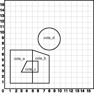

The scenario is a soft drink manufacturer that has identified geographical areas of marketing interest for several products (colas). The colas could be those produced by the company or by its competitors, or some combination. Each area of interest could represent any user-defined criterion: for example, an area where that cola has the majority market share, or where the cola is under competitive pressure, or where the cola is believed to have significant growth potential. Each area could be a neighborhood in a city, or a part of a state, province, or country.
Figure 2-1 shows the areas of interest for four colas.
Figure 2-1 Areas of Interest for the Simple Example
Example 2-1 performs the following operations:
Creates a table (COLA_MARKETS) to hold the spatial data
Inserts rows for four areas of interest (cola_a, cola_b, cola_c, cola_d)
Updates the USER_SDO_GEOM_METADATA view to reflect the dimensional information for the areas
Creates a spatial index (COLA_SPATIAL_IDX)
Performs some spatial queries

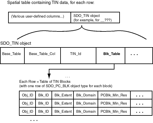

This section describes the following object types related to support for triangulated irregular networks (TINs):
SDO_TIN
SDO_TIN_BLK_TYPE
SDO_TIN_BLK
The description of a TIN is stored in a single row, in a single column of object type SDO_TIN in a user-defined table. The object type SDO_TIN is defined as:
CREATE TYPE sdo_tin AS OBJECT (base_table VARCHAR2(70), base_table_col VARCHAR2(1024), tin_id NUMBER. blk_table VARCHAR2(70), ptn_params VARCHAR2(1024), tin_extent SDO_GEOMETRY, tin_tol NUMBER, tin_tot_dimensions NUMBER, tin_domain SDO_ORGSCL_TYPE, tin_break_lines SDO_GEOMETRY, tin_stop_lines SDO_GEOMETRY, tin_void_rgns SDO_GEOMETRY, tin_val_attr_tables SDO_STRING_ARRAY, tin_other_attrs XMLTYPE);
The SDO_TIN type has the attributes shown in Table 2-4.
Table 2-4 SDO_TIN Type Attributes
| Attribute | Explanation |
| BASE_TABLE | Name of the base table containing a column of type SDO_TIN |
| BASE_TABLE_COL | Name of the column of type SDO_TIN in the base table |
| TIN_ID | ID number for the TIN. (This unique ID number is generated by Spatial.) |
| BLK_TABLE | Name of the table that contains information about each block in the TIN. This table contains the columns shown in Table 2-5. |
| PTN_PARAMS | Parameters for partitioning the TIN |
| TIN_EXTENT | SDO_GEOMETRY object representing the spatial extent of the TIN (the minimum bounding object enclosing all objects in the TIN) |
| TIN_TOL | Tolerance value for objects in the TIN. (For information about spatial tolerance, see Section 1.5.5.) |
| TIN_TOT_DIMENSIONS | Total number of dimensions in the TIN. Includes spatial dimensions and any nonspatial dimensions, up to a maximum total of 9. |
| TIN_DOMAIN | (Not currently used.) |
| TIN_BREAK_LINES | (Not currently used.) |
| TIN_STOP_LINES | Line string or multiline string SDO_GEOMETRY object representing the stop line or lines in the TIN. Stop lines typically indicate places where the elevation lines are not continuous, such as the slope from the top to the bottom of a cliff. Such regions are to be excluded from the TIN. |
| TIN_VOID_RGNS | (Not currently used.). |
| TIN_VAL_ATTR_TABLES | SDO_STRING_ARRAY object specifying the names of any value attribute tables for the TIN. Type SDO_STRING_ARRAY is defined as  |
| TIN_OTHER_ATTRS | XMLTYPE object specifying any other attributes of the TIN |
Figure 2-2 shows the storage model for TIN data, in which the TIN block table (specified in the BLK_TABLE attribute of the SDO_TIN type) stores the blocks associated with the SDO_TIN object.
The TIN block table contains the columns shown in Table 2-5.
Table 2-5 Columns in the TIN Block Table
| Column Name | Data Type | Purpose |
| BLK_ID | NUMBER | ID number of the block. |
| BLK_EXTENT | SDO_GEOMETRY | Spatial extent of the block. |
| BLK_DOMAIN | SDO_ORGSCL_TYPE | (Not currently used.) |
| PCBLK_MIN_RES | NUMBER | For point cloud data, the minimum resolution level at which the block is visible in a query. The block is retrieved only if the query window intersects the spatial extent of the block and if the minimum - maximum resolution interval of the block intersects the minimum - maximum resolution interval of the query. Usually, lower values mean farther from the view point, and higher values mean closer to the view point. |
| PCBLK_MAX_RES | NUMBER | For point cloud data, the maximum resolution level at which the block is visible in a query. The block is retrieved only if the query window intersects the spatial extent of the block and if the minimum - maximum resolution interval of the block intersects the minimum - maximum resolution interval of the query. Usually, lower values mean farther from the view point, and higher values mean closer to the view point. |
| NUM_POINTS | NUMBER | For point cloud data, the total number of points in the POINTS BLOB |
| NUM_UNSORTED_POINTS | NUMBER | For point cloud data, the number of unsorted points in the POINTS BLOB |
| PT_SORT_DIM | NUMBER | For point cloud data, the number of spatial dimensions for the points (2 or 3) |
| POINTS | BLOB | For point cloud data, BLOB containing the points. Consists of an array of points, with the following information for each point:
| TR_LVL | NUMBER | (Not currently used.) |
| TR_RES | NUMBER | (Not currently used.) |
| NUM_TRIANGLES | NUMBER | Number of triangles in the TRIANGLES BLOB. |
| TR_SORT_DIM | NUMBER | (Not currently used.) |
| TRIANGLES | BLOB | BLOB containing the triangles. Consists of an array of triangles for the block:
For each BLOB in the POINTS column of the TIN block table:
The total size is (tdim+1)*8, where tdim is the total dimensionality of each block.
The total size should be less than 5 MB for Oracle Database Release 11.1.0.6 or earlier; it should be less than 12 MB for Oracle Database Release 11.1.0.7 or later.
You can use an attribute name in a query on an object of SDO_TIN. Example 2-4 shows part of a SELECT statement that queries the TIN_EXTENT attribute of the TERRAIN column of a hypothetical LANDSCAPES table.
When you perform a clip operation using the SDO_TIN_PKG.CLIP_TIN function, an object of SDO_TIN_BLK_TYPE is returned, which is defined as TABLE OF SDO_TIN_BLK.
The attributes of the SDO_TIN_BLK object type are the same as the columns in the TIN block table, which is described in Table 2-5 in Section 2.5.2.

Figure 2-3 illustrates the rectangle that represents cola_a in the example in Section 2.1.
In the SDO_GEOMETRY definition of the geometry illustrated in Figure 2-3:
SDO_GTYPE = 2003. The 2 indicates two-dimensional, and the 3 indicates a polygon.
SDO_SRID = NULL.
SDO_POINT = NULL.
SDO_ELEM_INFO = (1, 1003, 3). The final 3 in 1,1003,3 indicates that this is a rectangle. Because it is a rectangle, only two ordinates are specified in SDO_ORDINATES (lower-left and upper-right).
SDO_ORDINATES = (1,1, 5,7). These identify the lower-left and upper-right ordinates of the rectangle.

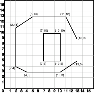

Figure 2-4 illustrates a polygon consisting of two elements: an exterior polygon ring and an interior polygon ring. The inner element in this example is treated as a void (a hole).
In the SDO_GEOMETRY definition of the geometry illustrated in Figure 2-4:
SDO_SRID = NULL.
SDO_POINT = NULL.
SDO_ELEM_INFO = (1,1003,1, 19,2003,1). There are two triplet elements: 1,1003,1 and 19,2003,1.
1003 indicates that the element is an exterior polygon ring; 2003 indicates that the element is an interior polygon ring.
19 indicates that the second element (the interior polygon ring) ordinate specification starts at the 19th number in the SDO_ORDINATES array (that is, 7, meaning that the first point is 7,5).
SDO_ORDINATES = (2,4, 4,3, 10,3, 13,5, 13,9, 11,13, 5,13, 2,11, 2,4, 7,5, 7,10, 10,10, 10,5, 7,5).
The area (SDO_GEOM.SDO_AREA function) of the polygon is the area of the exterior polygon minus the area of the interior polygon. In this example, the area is 84 (99 - 15).
The perimeter (SDO_GEOM.SDO_LENGTH function) of the polygon is the perimeter of the exterior polygon plus the perimeter of the interior polygon. In this example, the perimeter is 52.9193065 (36.9193065 + 16).

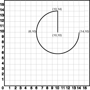

Figure 2-5 illustrates a crescent-shaped object represented as a compound line string made up of one straight line segment and one circular arc. Four points are required to represent this shape: points (10,10) and (10,14) describe the straight line segment, and points (10,14), (6,10), and (14,10) describe the circular arc.
In the SDO_GEOMETRY definition of the geometry illustrated in Figure 2-5:
SDO_GTYPE = 2002. The first 2 indicates two-dimensional, and the second 2 indicates one or more line segments.
SDO_SRID = NULL.
SDO_POINT = NULL.
SDO_ELEM_INFO = (1,4,2, 1,2,1, 3,2,2). There are three triplet elements: 1,4,2, 1,2,1, and 3,2,2.
The first triplet indicates that this element is a compound line string made up of two subelement line strings, which are described with the next two triplets.
The second triplet indicates that the line string is made up of straight line segments and that the ordinates for this line string start at offset 1. The end point of this line string is determined by the starting offset of the second line string, 3 in this instance.
The third triplet indicates that the second line string is made up of circular arcs with ordinates starting at offset 3. The end point of this line string is determined by the starting offset of the next element or the current length of the SDO_ORDINATES array, if this is the last element.
SDO_ORDINATES = (10,10, 10,14, 6,10, 14,10).

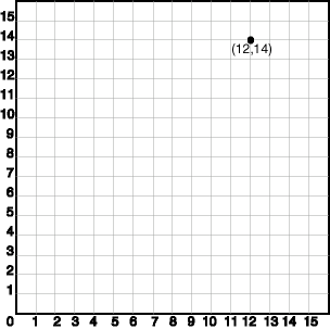

Figure 2-7 illustrates a point-only geometry at coordinates (12,14).
In the SDO_GEOMETRY definition of the geometry illustrated in Figure 2-7:
SDO_GTYPE = 2001. The 2 indicates two-dimensional, and the 1 indicates a single point.
SDO_SRID = NULL.
SDO_POINT = SDO_POINT_TYPE(12, 14, NULL). The SDO_POINT attribute is defined using the SDO_POINT_TYPE object type, because this is a point-only geometry.
For more information about the SDO_POINT attribute, see Section 2.2.3.
SDO_ELEM_INFO and SDO_ORDINATES are both NULL, as required if the SDO_POINT attribute is specified.

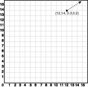

An oriented point is a special type of point geometry that includes coordinates representing the locations of the point and a virtual end point, to indicate an orientation vector that can be used for rotating a symbol at the point or extending a label from the point. The main use for an oriented point is in map visualization and display applications that include symbols, such as a shield symbol to indicate a highway.
To specify an oriented point:
Use an SDO_GTYPE value (explained in Section 2.2.1) for a point or multipoint geometry.
Specify a null value for the SDO_POINT attribute.
In the SDO_ELEM_INFO array (explained in Section 2.2.4), specify an additional triplet, with the second and third values (SDO_ETYPE and SDO_INTERPRETATION) as 1 and 0. For example, a triplet of 3,1,0 indicates that the point is an oriented point, with the third number in the SDO_ORDINATES array being the first coordinate, or x-axis value, of the end point reflecting the orientation vector for any symbol or label.
In the SDO_ORDINATES array (explained in Section 2.2.5), specify the coordinates of the end point for the orientation vector from the point, with values between -1 and 1. The orientation start point is assumed to be (0,0), and it is translated to the location of the physical point to which it corresponds.
Figure 2-8 illustrates an oriented point geometry at coordinates (12,14), with an orientation vector of approximately 34 degrees (counterclockwise from the x-axis), reflecting the orientation coordinates 0.3,0.2. (To have an orientation that more precisely matches a specific angle, refer to the cotangent or tangent values in the tables in a trigonometry textbook.) The orientation vector in this example goes from (0,0) to (0.3,0.2) and extends onward. Assuming i=0.3 and j=0.2, the angle in radians can be calculated as follows: angle in radians = arctan (j/i). The angle is then applied to the physical point associated with the orientation vector.
In the SDO_GEOMETRY definition of the geometry illustrated in Figure 2-8:
SDO_SRID = NULL.
SDO_POINT = NULL.
SDO_ELEM_INFO = (1,1,1, 3,1,0). The final 1,0 in 3,1,0 indicates that this is an oriented point.
SDO_ORDINATES = (12,14, 0.3,0.2). The 12,14 identifies the physical coordinates of the point; and the 0.3,0.2 identifies the x and y coordinates (assuming 12,14 as the origin) of the end point of the orientation vector. The resulting orientation vector slopes upward at about a 34-degree angle.
Example 2-12 shows a SQL statement that inserts the geometry illustrated in Figure 2-8 into the database.
Example 2-12 SQL Statement to Insert an Oriented Point Geometry
INSERT INTO cola_markets VALUES(
  91,
  'oriented_point',
  SDO_GEOMETRY(
    2001,
    NULL,
    NULL,
    SDO_ELEM_INFO_ARRAY(1,1,1, 3,1,0),
    SDO_ORDINATE_ARRAY(12,14, 0.3,0.2)));
