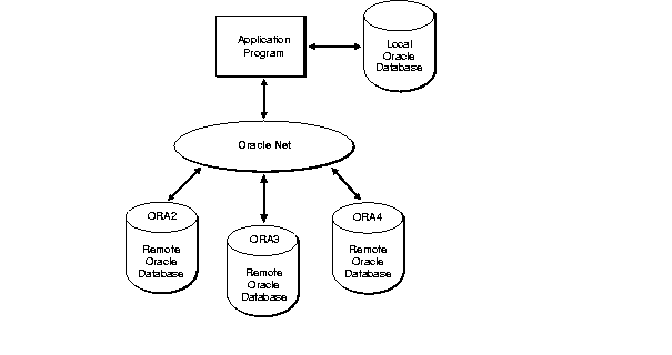

The communicating points in a network are called nodes. Oracle Net lets you transmit information (SQL statements, data, and status codes) over the network from one node to another.
A protocol is a set of rules for accessing a network. The rules establish such things as procedures for recovering after a failure and formats for transmitting data and checking errors.
The Oracle Net syntax for connecting to the default database in the local domain is simply to use the service name for the database.
If the service name is not in the default (local) domain, you must use a global specification (all domains specified). For example:
HR.US.ORACLE.COM
Pro*C/C++ supports distributed processing through Oracle Net. Your application can concurrently access any combination of local and remote databases or make multiple connections to the same database. In Figure 3-1, an application program communicates with one local and three remote Oracle databases. ORA2, ORA3, and ORA4 are simply logical names used in CONNECT statements.
By eliminating the boundaries in a network between different machines and operating systems, Oracle Net provides a distributed processing environment for Oracle tools. This section shows you how Pro*C/C++ supports distributed processing through Oracle Net. You learn how your application can
Directly or indirectly access other databases
Concurrently access any combination of local and remote databases
Make multiple connections to the same database
For details on installing Oracle Net and identifying available databases, refer to the Oracle Database Net Services Administrator's Guide and your system-specific Oracle documentation.
Each node has a default database. If you specify a database name, but no domain in your CONNECT statement, you connect to the default database on the named local or remote node.
A default connection is made by a CONNECT statement that has no AT clause. The connection can be to any default or nondefault database at any local or remote node. SQL statements without an AT clause are executed against the default connection. Conversely, a nondefault connection is made by a CONNECT statement that has an AT clause. SQL statements with an AT clause are executed against the nondefault connection.
All database names must be unique, but two or more database names can specify the same connection. That is, you can have multiple connections to any database on any node.

With explicit connections, you connect to another database directly, giving the connection a name that will be referenced in SQL statements. You can connect to several databases at the same time and to the same database multiple times.
In the following example, you connect to a single nondefault database at a remote node:
/* declare needed host variables */ char username[10] = "scott"; char password[10] = "tiger"; char db_string[20] = "NYNON"; /* give the database connection a unique name */ EXEC SQL DECLARE DB_NAME DATABASE; /* connect to the nondefault database */ EXEC SQL CONNECT :username IDENTIFIED BY :password AT DB_NAME USING :db_string;
The identifiers in this example serve the following purposes:
The host variables username and password identify a valid user.
The host variable db_string contains the Oracle Net syntax for connecting to a nondefault database at a remote node.
The undeclared identifier DB_NAME names a nondefault connection; it is an identifier used by Oracle, not a host or program variable.
The USING clause specifies the network, machine, and database associated with DB_NAME. Later, SQL statements using the AT clause (with DB_NAME) are executed at the database specified by db_string.

    FROM emp@db_link
    WHERE DEPTNO = :dept_number;
The database link is not related to the database name used in the AT clause of an embedded SQL statement. It simply tells Oracle where the nondefault database is located, the path to it, and what Oracle username and password to use. The database link is stored in the data dictionary until it is explicitly dropped.
In our example, the default Oracle Server logs on to the nondefault database through Oracle Net using the database link db_link. The query is submitted to the default Server, but is "forwarded" to the nondefault database for execution.
To make referencing the database link easier, you can interactively create a synonym as follows:
EXEC SQL CREATE SYNONYM emp FOR emp@db_link;
Then, your program can query the nondefault EMP table, as follows:
EXEC SQL SELECT ENAME, JOB INTO :emp_name, :job_title
    FROM emp
In the following example, you connect to two nondefault databases concurrently. First, you execute the following sequence of statements to define two database links and create two synonyms:
EXEC SQL CREATE DATABASE LINK db_link1
    CONNECT TO username1 IDENTIFIED BY password1
        USING 'NYNON';
EXEC SQL CREATE DATABASE LINK db_link2
    CONNECT TO username2 IDENTIFIED BY password2
        USING 'CHINON';
EXEC SQL CREATE SYNONYM emp FOR emp@db_link1;
EXEC SQL CREATE SYNONYM dept FOR dept@db_link2;
Then, your program can query the nondefault EMP and DEPT tables, as follows:
EXEC SQL SELECT ENAME, JOB, SAL, LOC
    FROM emp, dept
    WHERE emp.DEPTNO = dept.DEPTNO AND DEPTNO = :dept_number;
Oracle executes the query by performing a join between the nondefault EMP table at db_link1 and the nondefault DEPT table at db_link2.
