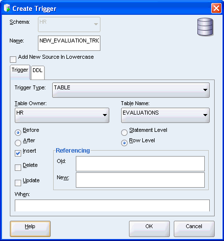

In the following task, you will use the SQL Developer Connection navigation hierarchy to create a trigger new_evaluation, which checks if a new row should be added to the evaluations table, based on whether a row for the same employee exists for the identical time period.
Example 5-3 Generating Primary Keys FOR EACH ROW Triggers; BEFORE Option
In the Connections navigation hierarchy, right-click Triggers.
From the drop-down, select New Trigger.
In the Create Trigger window, set the following parameters:
Set Name to new_evaluation_trigger.
In the Trigger pane: set Trigger Type to TABLE, set Table Owner to HR, set Table Name to evaluations, select Before, select Insert, and select Row Level.
Click OK.
The new_evaluation pane opens with the following code.
Note that the tile of the pane is in italic font, which indicates that the trigger is not saved in the database.
CREATE OR REPLACE TRIGGER new_evaluation BEFORE INSERT ON evaluations FOR EACH ROW BEGIN NULL; END;
From the File menu, select Save to save the new trigger. Alternatively, use the CTRL + S key combination.
