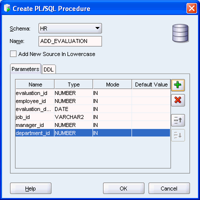

You will create a procedure add_evaluation that creates a new row in the evaluations table.
In the Connections navigation hierarchy, right-click Procedures.
Select New Procedure.
In the New Procedure window, set the following parameters:
In the Parameters tab, click the Add Column icon ('plus' sign) and specify the first parameter of the procedure. Set Name to eval_id, set Type to NUMBER, set Mode to IN, and leave Default Value empty.
Similarly, add the following parameters, in this order:
employee_id: set Type to NUMBER, set Mode to IN, and leave Default Value empty.
evaluation_date: set Type to DATE, set Mode to IN, and leave Default Value empty.
job_id: set Type to VARCHAR2, set Mode to IN, and leave Default Value empty.
manager_id: set Type to NUMBER, set Mode to IN, and leave Default Value empty
department_id: set Type to NUMBER, set Mode to IN, and leave Default Value empty
Click OK.
The ADD_EVALUATION pane opens with the following code.
Note that the tile of the pane is in italic font, which indicates that the procedure is not saved in the database.
CREATE OR REPLACE PROCEDURE ADD_EVALUATION ( evaluation_id IN NUMBER , employee_id IN NUMBER , evaluation_date IN DATE , job_id IN VARCHAR2 , manager_id IN NUMBER , department_id IN NUMBER ) AS BEGIN NULL; END ADD_EVALUATION;

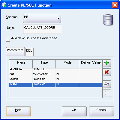

In the New Function window, set the following parameters:
In the Parameters pane, set the <return> Type to NUMBER.
cat: set Type to VARCHAR2, set Mode to IN, and leave Default Value empty.
score: set Type to NUMBER, set Mode to IN, and leave Default Value empty
weight: set Type to NUMBER, set Mode to IN, and leave Default Value empty
Click OK.

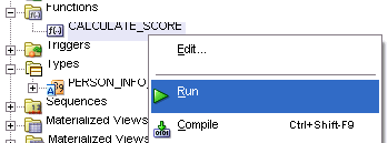

You will test the function calculate_score.
In the Connections navigator hierarchy, right-click the calculate_score function. Select Run.
In the Run PL/SQL window, click inside the PL/SQL Block pane, and edit the assignments for the score and weight variables. The new code is in bold font.
v_Return := CALCULATE_SCORE(
    CAT => CAT,
    SCORE => 8,
    WEIGHT => 0.2
Click OK.
In the Running - Log pane, note the following results:
Connecting to the database hr_conn. v_Return = 1.6 Process exited. Disconnecting from the database hr_conn.

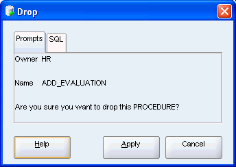

You can delete a procedure or function from the database using either the Connection Navigator, or the SQL DROP statement.

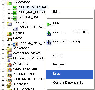

You will drop the procedure ADD_EVALUATION.
In the Connections navigator hierarchy, right-click the ADD_EVALUATION function.
Select Drop.
In the Drop window, click Apply.
In the Confirmation dialog box, click OK.
You dropped the ADD_EVALUATION procedure from the database.

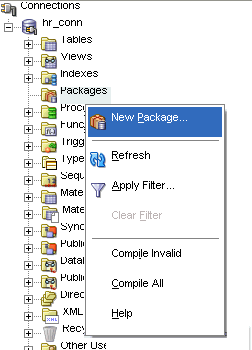

To create a package in SQL Developer navigation hierarchy:
In the Connections navigation hierarchy, right-click Packages.
Select New Package.

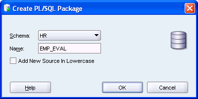

In the Create PL/SQL Package dialog, set the following parameters:
The emp_eval pane opens with the following code:
CREATE OR REPLACE PACKAGE emp_eval AS /* TODO enter package declarations (types, exceptions, methods etc) here */ END emp_eval;
Note that the title of the pane is in italic font, which indicates that the package is not saved to the database.
From the File menu, select Save to compile and save the new package. Alternatively, use the CTRL + S key combination.
In the Messages - Log pane, the system confirms that the package was created:
EMP_EVAL Compiled.
Note that the title of the emp_eval pane is in regular font, not italic; this indicates that the procedure is saved to the database.

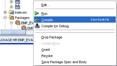

Compile the package specification.
You will see the following message that confirms that the package compiled correctly.
EMP_EVAL Compiled.

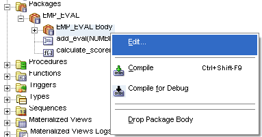

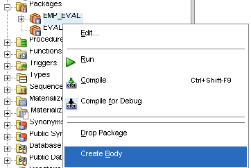

You will create a package body for emp_eval by specifying some functions and procedures.
In the Connections navigation hierarchy, right-click emp_eval.
Select Create Body.
In the emp_eval Body pane, you can see the automatically generated code for the package body.
CREATE OR REPLACE PACKAGE BODY emp_eval AS PROCEDURE eval_department(department_id IN NUMBER) AS BEGIN /* TODO implementation required */ NULL; END eval_department; FUNCTION calculate_score(evaluation_id IN NUMBER , performance_id IN NUMBER) RETURN NUMBER AS BEGIN /* TODO implementation required */ RETURN NULL; END calculate_score; END emp_eval;
Compile and save the package body.
You will see the following message that confirms that the package body compiled correctly.
EMP_EVAL Body Compiled.

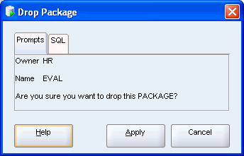

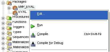

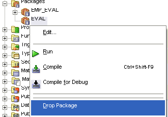

You can delete a package from the database either by using the Connections navigator hierarchy or the SQL DROP statement. When you drop a package, you remove from the database both the package specification and its package body.
In the Connections navigator hierarchy, select Packages, and then right-click the EVAL package.
Select Drop Package.
In the Drop Package dialog, click Apply.
In the Confirmation dialog, click OK.

Right-click EMP_EVAL Body.
Select Edit.
emp_eval Body pane appears.

In the Connections navigation hierarchy, right-click the emp_eval package, and select Compile. Alternatively, use the Ctrl+Shift+F9 keyboard shortcut.
The following message appears in the Messages-Log pane:

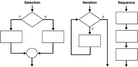

Control structures are the most powerful feature of the PL/SQL extension to SQL. They let you manipulate data and process it using conditional selection, iterative control, and sequential statements. Conditional selection is a situation where you may have different types of data values, and may need to perform different processing steps. Iterative control is a situation where you need to perform repetitive process steps on similar data. In general, all the lines of code in your programs run sequentially; sequential control means that you are choosing to execute an alternate labeled programming branch (GOTO statement).
This section will only cover conditional selection and iterative program flow structures, such as IF...THEN...ELSE, CASE, FOR...LOOP, WHILE...LOOP, and LOOP...EXIT WHEN.

Conditional selection structures test an expression that evaluates to a BOOLEAN value TRUE or FALSE. Depending on the value, control structures execute the assigned sequence of statements. There are two general selection control mechanisms: IF...THEN...ELSE and its variations, and the CASE statement.

Iteration structures, or loops, execute a sequence of statements repeatedly. There are three basic types of loops, the FOR...LOOP, the WHILE...LOOP, and the LOOP...EXIT WHEN.
