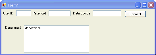

Open Form1 in Design view. From the View menu, select Designer.
From the View menu, select Toolbox.
From the Toolbox, select a Label and drag it onto Form1.
From the View menu, select Properties Window.
In the Properties window, change the Text of the label to Department.
From the Toolbox, under Window forms, select a ListBox and drag it onto Form1.
In the Properties window, under Design, change the Name to departments.

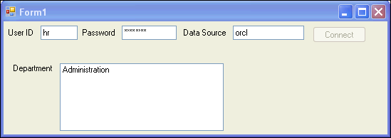

Run the application. Enter the login and data source.
After you connect, the departments list box shows Administration, the correct name for department number 10 in the HR schema, as requested by the SELECT statement.

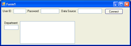

Move the ListBox named Departments to the right.
From the Toolbox, select a TextBox and drag it onto Form1, under the label that says Department.
In the Properties window, change Name to departmentID.

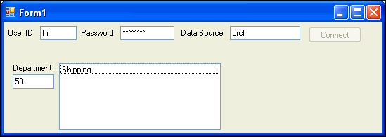

Save and run the application.
Enter the login information, and a typical department number, such as 50, from the HR schema.
Click Connect.
The application returns the name of the department that corresponds to the department ID.

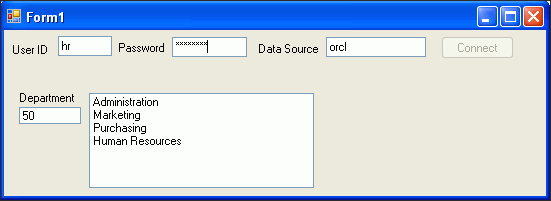

Enter the login information and enter 50 for the department.
Click Connect.
The application returns the name of the departments that correspond to the query.

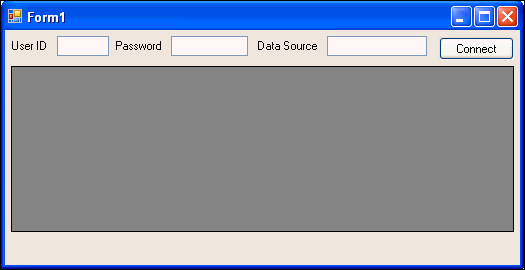

At this point, the DataSet contains a client copy of the database data. In this section, you will add a button that enables client data changes to be saved back to the database. The following section will show you how to test updating, inserting, and deleting the data.

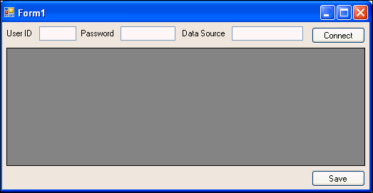

To enable saving data from the DataSet to the database:
From the Toolbox, drag and drop a Button onto Form1.
In the Properties window, change the Name of the button to save.
Change the Text property to Save.
At the top of the Properties Window, click Events (the lightning bolt). In the list of events, select the click event. In the second column, enter the event name, save_Click.

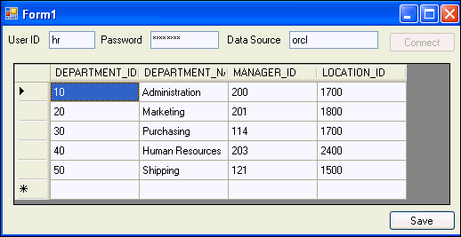

Run the application, entering the login and data source.
After you successfully connect to the database, the data grid is populated with the results of the query.

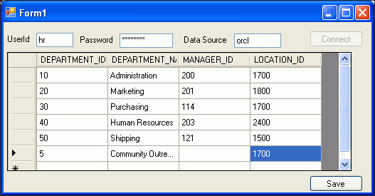

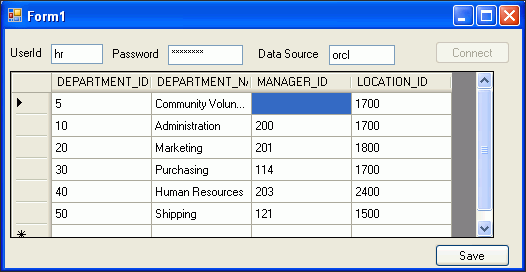

Run the application you created in the last section, entering the login and data source, and connecting to the database.
At the bottom of the data grid, enter a new record at the * prompt:
For DEPARTMENT_ID, enter 5.
For DEPARTMENT_NAME, enter Community Outreach.
Leave MANAGER_ID without a value.
For LOCATION_ID, enter 1700.
Click Save.

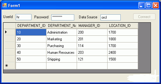

Run the application again, and connect to the database.
Note that the new department is at the top of the DEPARTMENTS table, in numerical order by DEPARTMENT_ID.
Change the name of the department to Community Volunteers, and click the Save button.
Repeat Step 4, run the application again, and connect to the database, and note that the name of the department is changed.

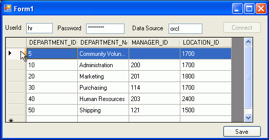

Select the entire record you just changed (click the cursor icon in the far left column), and delete it using the Delete key. Click the Save button.
Repeat Step 4, run the application again, and connect to the database, and note that the new record is no longer part of the DEPARTMENTS table.
