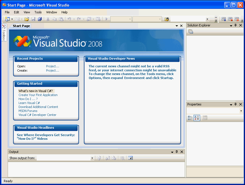

Start Visual Studio.
Open the Start menu, select All Programs, and then select Microsoft Visual Studio 2008.
The Microsoft Visual Studio IDE environment appears.

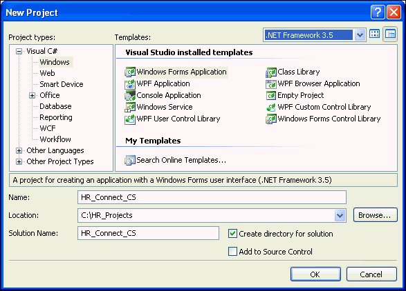

In the Start Page, under the Recent Projects heading, click Create: Project.
Alternatively, from the File menu, select New, and then select Project.
A New Project dialog box appears.
In Project Types, select the type of project you are creating:
Visual C#:
Visual C#: Windows
Visual Basic:
Other Languages: Visual Basic: Windows
In Templates, select Windows Forms Application.
In the Name field, enter the appropriate name.
Visual C#:
HR_Connect_CS
Visual Basic:
HR_Connect_VB
The abbreviation CS indicates C# projects and VB indicates Visual Basic projects.
In Location, enter the directory where you want to save the files.
For this guide, enter this directory C:\HR_Projects.
In Solution Name, the appropriate name, HR_Connect_CS or HR_Connect_VB should appear.
A solution can contain several projects; when it contains only one project, you can use the same name for both.
Check Create directory for solution.
Click OK.
The project is created.

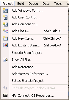

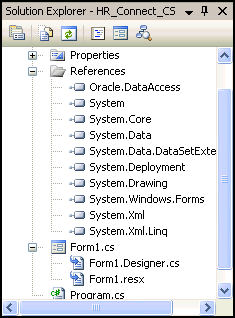

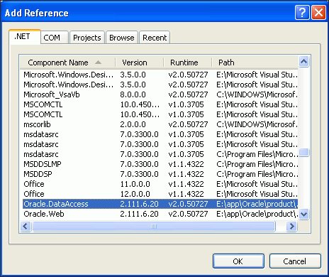

This section shows you how to add a reference to the Oracle.DataAccess.dll file, which contains the data provider, Oracle Data Provider for .NET.
From the Project menu, select Add Reference.
The Add Reference windows appears.
In the Add Reference window, under the .NET tab, select Oracle.DataAccess. Click OK.
Note that the new reference appears in the Solution Explorer.

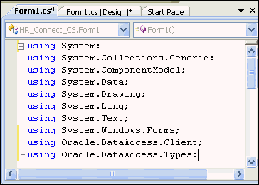

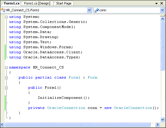

You can add Oracle namespace directives that allow you to indicate an assembly's namespaces within the module. To do this, add C# using statements or Visual Basic Imports statements, at or near the top of a code file.
Adding a reference makes the namespace available within the application. Adding a namespace directive within the application code makes the namespace more visible and allows for additional scoping.To add Oracle namespace directives:
With Form1 active, from the View menu select Code.
Alternatively, you can use the F7 keyboard shortcut.
Add the following statements to the list of declarations depending on the language you are using.
Visual C#:

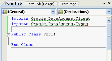

Add with other using statements, before the namespace.
using Oracle.DataAccess.Client; using Oracle.DataAccess.Types;
Visual Basic:.
Add to the top of the file, in the declarations section.
Imports Oracle.DataAccess.Client Imports Oracle.DataAccess.Types

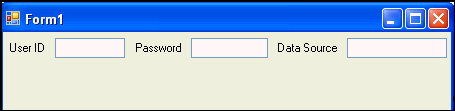

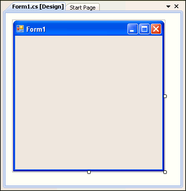

You can create a user interface by adding the toolbox controls to the design form. This interface accepts connection information from the user.
From the View menu, select Designer.
This opens Form1, in design view, if it is not already open.
You will toggle between Code and Designer a lot. The keyboard shortcuts are F7 and shift- F7 respectively.
From the View menu, select Toolbox.

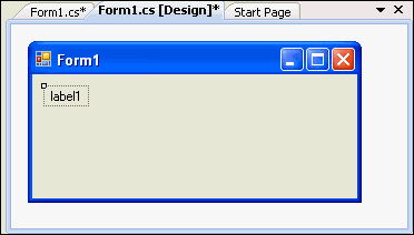

In the Toolbox, expand Common Controls.

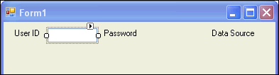

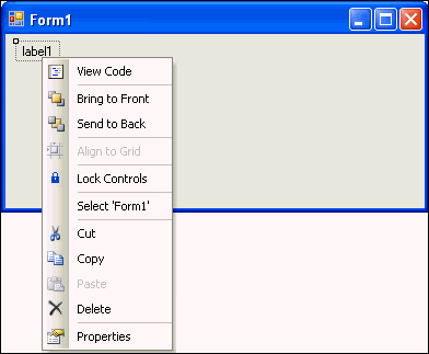

In the Toolbox, select Label, and drag it onto the Form1.
On Form1, right-click label1.
From the menu, select Properties, if the Properties Window is not already visible.
The Properties Window appears.
In the Properties Window, change the Text property from label1 to User ID.
Repeat steps 4 through 7 twice, placing two more labels on Form 1 and changing their text properties to Password and Data Source.
In the Toolbox, select TextBox, and drag it onto the Form1, next to the User ID label.
In the Properties Window, change the Name property to userID.
Repeat steps 9 and 10 twice, positioning two more text boxes next to the existing labels, and setting the Name property to password and dataSource.
Select the text box next to the Password label. In the Properties Window, scroll to the PasswordChar property and set it to an asterisk (*).
This masks the password during entry.

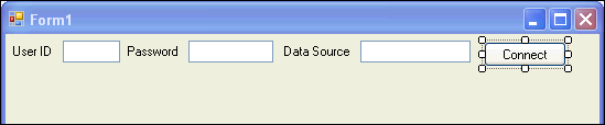

From the Toolbox, select Button and drag it onto Form1.
In the Properties Window, change the Text property of the button from button1 to Connect, and change the Name property to connect.
Save.

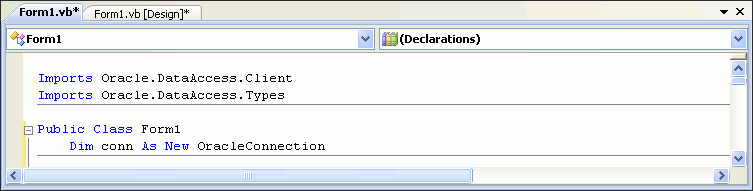

Visual C#: Add the class variable conn to the Form1 class right after the public Form1() block with this code.
private OracleConnection conn = new OracleConnection();
Visual Basic: Add the conn class variable in the Form1 class declaration, using this code.
Public Class Form1 Dim conn As New OracleConnection

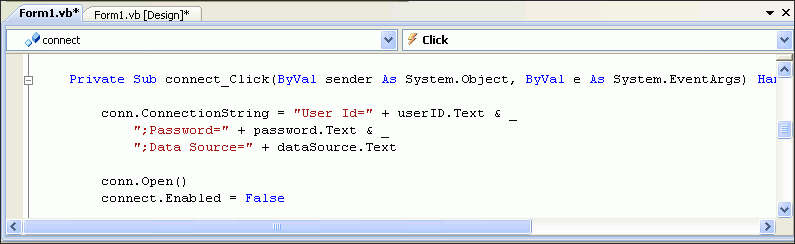

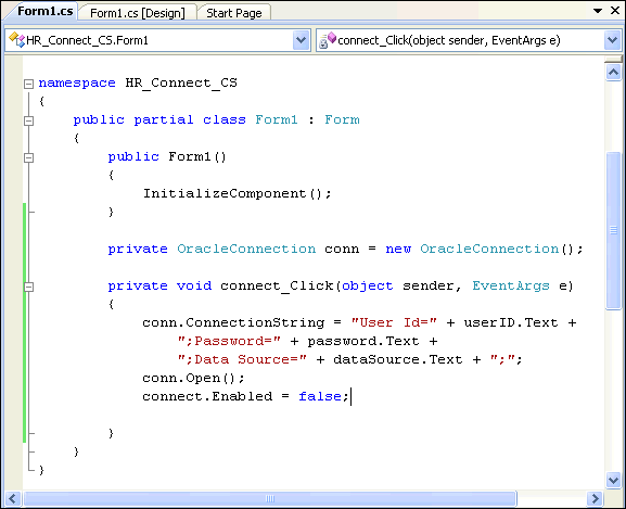

Double-click the Connect button on Form1 to open the code window to the connect_Click() method.
Insert the code indicated into the connect_Click() method.
Visual C#:
conn.ConnectionString = "User Id=" + userID.Text + ";Password=" + password.Text + ";Data Source=" + dataSource.Text + ";"; conn.Open();
Visual Basic:
conn.ConnectionString = "User Id=" + userID.Text & _ ";Password=" + password.Text & _ ";Data Source=" + dataSource.Text conn.Open()
Note: Before a connection can be opened, it must be built from user input for the User ID, Password, and Data Source. The Open() method makes the actual connection.
Set the Enabled attribute of the button to false by inserting the indicated code at the end of the connect_Click() method.
This disables the Connect button, which is a good practice once a connection is successfully made.

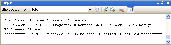

From the Build menu, select Build Solution.
Ensure that there are no errors reported in the output window, available from the View menu.
The following graphics shows a typical output result.
If there are any errors indicated, from the View menu, select Error List and fix the errors.

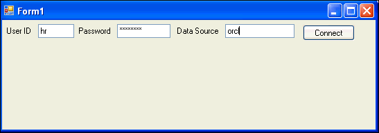

From the Debug menu, select Start Without Debugging to run the application.
In the Form1 application, enter the User ID, Password, and Data Source.
Click Connect.
This is where the application makes use of the tnsnames.ora file. See "Configuring a NET Connect Alias".
Once the connection is opened, the Connect button is disabled. You have succeeded in implementing a connection to an Oracle Database instance.

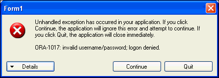

Applications must be able to handle run-time errors gracefully. For example, if you try to log in using an incorrect password, the application you developed so far cannot establish a connection to the database, and exits with the following unhandled exception error, ORA-1017: invalid username/password, logon denied.
You must reselect Start Without Debugging to try this with a different password.

Run the application again, as described in section "Compiling and Running the Application", and attempt to connect using an incorrect password. This time, the application catches the error and displays it in a pop-up window, ORA-1017: invalid username/password; logon denied.
