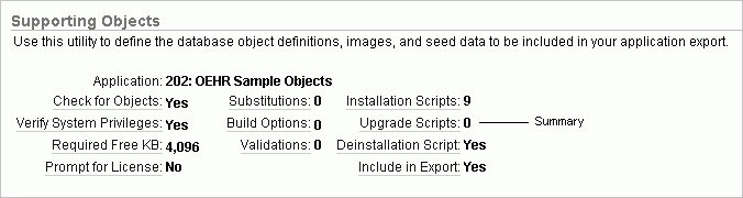

You create a packaged application on the Supporting Objects page.
To access the Supporting Objects Page application:
On the Workspace home page, click the Application Builder icon.
Select the application.
The Application home page appears.
Click the Supporting Objects icon.
The Supporting Objects page appears.
The top of the Supporting Objects page displays the application name and indicates current selections for the following: Check for Objects, Verify System Privileges, Required Free KB, Prompt for License, Substitutions, Build Options, Validations, Installation Scripts, Upgrade Scripts, Deinstallation Script, and Include in Export.
The rest of the page is divided into four categories.
Use the links under Installation to define the following types of information:
Prerequisites. Defines built-in checks required prior to installing the application, including required free disk space, required system privileges, and schema object restrictions.

Click Supporting Objects.
From the Tasks list, click Upgrade Supporting Objects.
Follow the on-screen instructions.

You can view a log of recent installation and deinstallation by clicking View Install Summary on the Tasks list on the Supporting Objects page. Note that this log only displays results from the most recent installation or deinstallation that occurred during the current Application Express session.
To view the Install Summary:
On the Tasks list on the right side of the page, click View Install Summary.
A Summary page appears.
