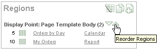

You can quickly change the order that regions display, edit a region title, or change a region template by clicking the Reorder Regions icon on the Page Definition. The Reorder Regions icon displays as light green down and up arrows and displays to the right of Display Point.
To edit regions using the Reorder Regions icon:
Navigate to the appropriate Page Definition. See "Accessing a Page Definition".
Under Regions, click the Reorder Regions icon.
The Reorder Regions page appears. Use this page to edit the region title or select a new template.
In Region, enter a new title.
From Template, select a new template.
To change the order in which regions display, click the up and down arrows in the far right column.
Click Apply Changes.
