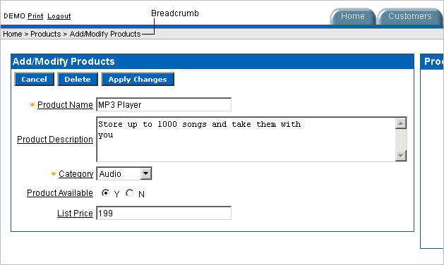

Breadcrumbs provide users with hierarchical navigation. A breadcrumb is a hierarchical list of links that display using templates. You can display a breadcrumb as a list of links or as a breadcrumb path.
Topics in this section include:
A breadcrumb trail indicates where the user is within the application from a hierarchical perspective. In addition, users can click a specific breadcrumb link to instantly view the page. You use breadcrumbs as a second level of navigation at the top of each page, complementing other user interface elements such as tabs and lists.
You can create breadcrumbs while creating a page, or manually by running the Create Breadcrumb Wizard.

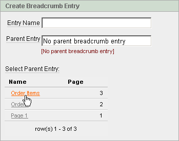

The Create Breadcrumb Entry form appears.
In Entry Name, enter a name for the breadcrumb.
For Parent Entry:
To specify a parent, select a parent page from the Select Parent Entry list.
If this breadcrumb does not have a parent, select No parent breadcrumb entry.
Follow the on-screen instructions.

The Reparent Entries page appears.
Use the navigation bar to edit or filter the view:
Breadcrumb - Identify the breadcrumb you wish to edit and click Go.
Start With - Make a selection to restrict your view to a subset of the breadcrumb hierarchy and click Go.
From Reparent to, select the new parent.
Select the breadcrumbs entries you wish to move and click Reparent Checked Entries.
You can view the Breadcrumb Utilization and Breadcrumb History reports by clicking the appropriate tab at the top of the Breadcrumbs page.
The Utilization and History buttons only appear after you create a breadcrumb.Click Utilization to access the Breadcrumb Utilization report. This report lists breadcrumbs by page. Click the page number to go to a specific page.
Click History to view the Breadcrumb History report. This report lists recent changes to breadcrumbs.

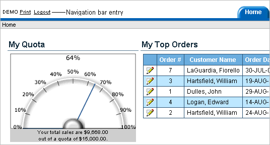

Navigation bar entries offer an easy way to move users between pages in an application. For example, a navigation entry enables you to display a link from an image or text. The associated page template determines the location of a navigation bar.
See Also:
Customizing TemplatesA navigation bar entry can be an image, text, or an image with text beneath it. You must supply the images and text to use in the navigation bar entries.
Navigation bars are different from other shared components in that you do not need to reference them on a page-by-page basis. If your page template includes the #NAVIGATION_BAR#
substitution string, the Application Express engine automatically includes any defined navigation bars when it renders the page.
See Also:
"Supported Page Template Substitution Strings" on using the#NAVIGATION_BAR#
substitution stringBefore adding a navigation bar, you must create entries for the navigation bar. To do so, access the Navigation Bar page from either the Page Definition or from the Shared Components page.
