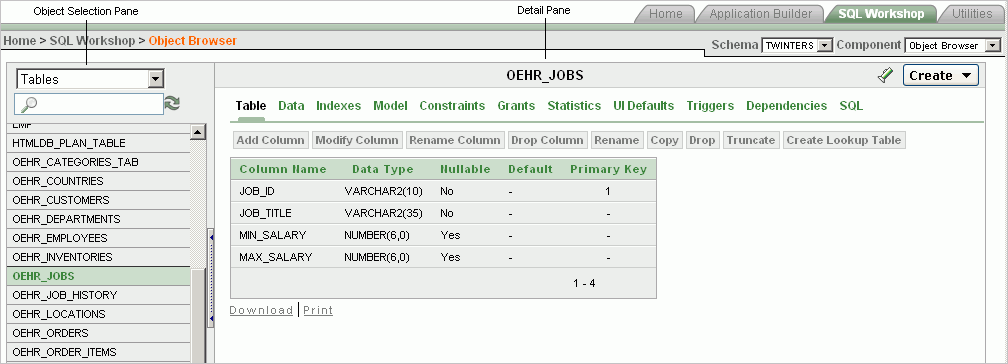

Oracle Database SQL Language ReferenceThe Object Browser page is divided into two sections:
Object Selection pane displays on the left side of the Object Browser page and lists database objects of a selected type within the current schema. You can further narrow the results by filtering on the object name.
Detail pane displays to the right of the page and displays detailed information about the selected object. To view object details, select an object in the Object Selection pane. Click the tabs at the top of the Detail pane to view additional details about the current object. To edit an object, click the appropriate button.

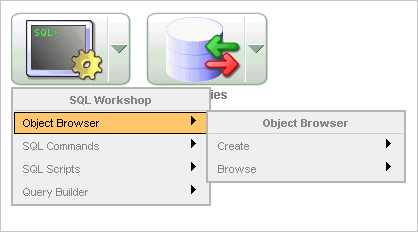

To access Object Browser:
Log in to the Workspace home page.
Click SQL Workshop.
To view Object Browser you can either:
Click SQL Workshop and then Object Browser to drill-down to the Object Browser.
Click the down arrow on the right side of the SQL Workshop icon to view a drop down menu. Then select the Object Browser menu option.
For the purposes of consistency, this document uses the primary navigation path (or drill-down approach) when explaining navigation.The Object Selection pane displays on the left side of the Object Browser page and lists database objects by type with the current schema. You can filter the view by selecting an object type or entering a case insensitive search term.

To search for a database object in the Object Selection pane:
On the Workspace home page, click SQL Workshop and then Object Browser.
Object Browser appears.
Select an object type from the Object list.
The list of objects that appears depends upon the available objects in the current schema. Note that any object having a red bar adjacent to it is invalid.
To search for an object name, enter a case insensitive search term in the Search field.
To view all objects, leave the search field blank.
Once you locate the database object you want to view, simply select it. The selected object displays in the Detail pane. If no object is selected, the Detail pane is blank.
You can hide the Object Selection pane by selecting the Hide Objects control. This control displays on the right side of the Object Selection pane. If the Object Selection pane appears, selecting this control hides it. Similarly, if the Object Selection pane is hidden, selecting this control causes the pane to reappear.

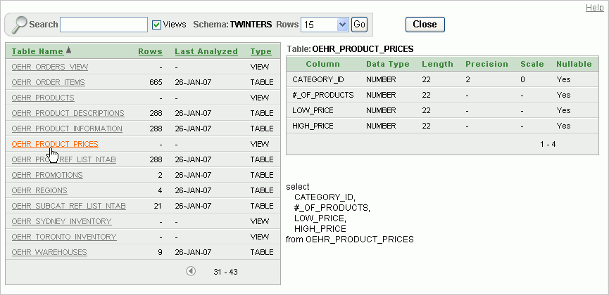

The Find Tables icon resembles a flashlight. Click this icon to view tables within the currently selected schema.
To view tables within the current schema:
Navigate to either Object Browser or SQL Commands.
From the Schema list, select a schema (optional).
Click the Find Tables icon.
The Table Finder appears. A search bar displaying the selected schema displays at the top of the page and contains the following controls:
Search. Search for a table name. Enter case insensitive keywords in the Search field and click Go. To view all tables, leave the Search field blank and click Go.
Rows. Determine how many rows display in the resulting report. To change the number of rows that display, make a selection from the list and click Go.
Views. Select the Views checkbox and click Go to include views in the resulting report.
The Table Finder report appears displaying the table name, the number of rows, last analyzed date, and the object type.
Select a table name.
A table definition appears on the right side of the page.
This report displays the column names, data type, length, precision, and scale as well as the SQL necessary to re-create the table appears at the bottom of the page.

To view a table description:
From the Object list, select Tables.
From the Object Selection pane, select a table.
The table description appears.
Click the tabs at the top of the page to view different reports about the table. Table 16-1 describes all available views.
Table 16-1 Available Views for Tables
| View | Description |
Table |
Displays details of the first 31 columns including the column name, data type, nullable status, default value, and primary key. While viewing table details you can add, modify, delete, or rename a column. Additionally, you can drop, rename, copy, or truncate the table as long as the referencing table has no records and create a lookup table. To export the data as a comma-delimited file (.csv) file, click the Download link. See Also: "Editing a Table" |
