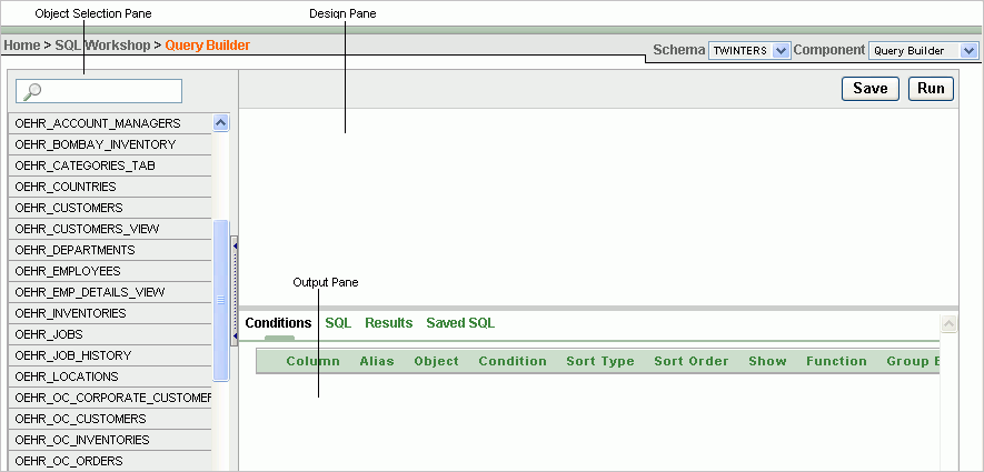

Query Builder's graphical user interface enables database developers to build SQL queries without the need for manual SQL coding. Using Query Builder, you can search and filter database objects, select objects and columns, create relationships between objects, view formatted query results, and save queries with little or no SQL knowledge.
See Also:
"Using the Query Finder"The Query Builder page is divided into three sections:
Object Selection pane displays on the left side of the page and contains a list objects from which you can build queries. Only objects in the current schema display.
Design pane displays to the right of the Object Selection pane and above the Conditions, SQL, Results, and Saved SQL tabs. When you select an object from the Object Selection pane, it appears in the Design pane.
Output pane displays below the Design pane. Once you select objects and columns, you can create conditions, view the generated SQL, or view query results.

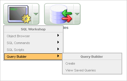

To access Query Builder:
Log in to the Workspace home page.
Click SQL Workshop.
To view Query Builder you can either:
Click SQL Workshop and then Query Builder.
Click the down arrow on the right side of the SQL Workshop icon to view a drop down menu. Then select the Query Builder menu option.

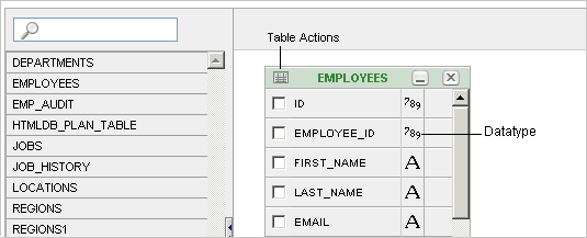

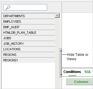

The Object Selection pane displays on the left side of the Query Builder page and lists tables, views, and materialized views within the current schema.
Topics in this section include:
Use the Object Selection pane to search for and view tables, views, and materialized views within the current schema.
To search or filter objects:
On the Workspace home page, click SQL Workshop and then Query Builder.
Query Builder appears.
In the search field at the top of the pane, enter a case insensitive query.
To view all tables or views within the currently selected schema, leave the search field blank.
You can hide the Object Selection pane by selecting the Hide Table or Views control. By hiding the Object Selection pane, you can increase the size of the Design and Result panes.
The Hide Table or Views control displays on the right side of the Object Selection pane. If the Object list appears, selecting this control hides it. Similarly, if the Object list is hidden, selecting this control causes the pane to reappear.

You add an object to the Design pane by selecting it from the Object Selection pane.
To add an object to the Design pane:
Select an object from the Object Selection pane.
The selected object appears in the Design Pane. Note that a graphical representation of the datatype displays to the right of the column name.
Select the columns to be included in your query by clicking the check box to the left of the column name.
When you select a column you are indicating it will be used in the query. As you select a column, it appears on the Conditions tab. Note that the Show check box on the Conditions tab controls whether a column is included in query results. Be default, this check box is selected.
To select the first twenty columns, click the Table Actions icon in the upper left corner of the object. The Actions window appears. Select Check All.

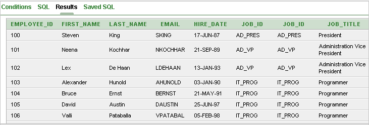

To execute the query and view results, click Run.
Tip:
You can also execute a query by pressing CTRL + ENTER.The Results pane displays the query results.

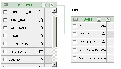

You can create relationships between objects by creating a join. A join identifies a relationship between two or more tables, views, or materialized views.
When you write a join query, you specify a condition that conveys a relationship between two objects. This condition is called a join condition. A join condition determines how the rows from one object will combine with the rows from another object.
Query Builder supports inner, outer, left, and right joins. An inner join (also called a simple join) returns the rows that satisfy the join condition. An outer join extends the result of a simple join. An outer join returns all rows that satisfy the join condition and returns some or all of those rows from one table for which no rows from the other satisfy the join condition.

Identify the columns you want to join.
You create a join by selecting the Join column adjacent to the column name. The Join column displays to the right of the datatype, beneath the Remove icon. When your cursor is in the appropriate position, the following help tip displays:
Click here to select column for join
Select the appropriate Join column for the first object.
When selected, the Join column displays as a dark gray. To deselect a Join column, simply select is again or press ESC.
Select the appropriate Join column for the second object.
Tip:
You can also join two objects by dragging and dropping. Select a column in the first table and then drag and drop it onto a column in another table.
When joined, a green line connects the two columns.
Select the columns to be included in your query. You can view the SQL statement resulting from the join by positioning the cursor over the green line.

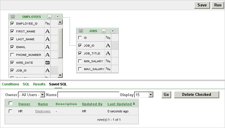

As you create new queries, you can save them by clicking the Save button in the Design pane. Once you save a query, you can access it later in the Saved SQL view.
To save a query:
Build a query:
Select objects from the Object Selection pane.
Add objects to the Design pane and select columns.
Execute the query.
Click Save.
Enter a name and description and click Save.
The saved query displays in the Saved SQL view.
Note that Query Builder does not support duplicate query names. If you open an existing query, keep the existing name, and save it again, Query Builder over-writes the existing query. If you change the name of an existing query and save it again,Query Builder saves the query again under the new name.
Once you save a query, you can access it in the Saved SQL view.
To edit a Saved SQL query:
Select the Saved SQL tab.
To filter the display, you can:
Make a selection from the Owner list and click Go.
Enter a search query in the Name field and click Go.
To edit a query, select the appropriate name.
The saved query appears. The selected objects display in the Design pane and the Conditions view appears.

Once you select objects and determine what columns to include in your query, you execute a query by:
Clicking the Run button (or pressing CTRL + ENTER)
Selecting the Results tab
The Results view appears, displaying formatted query results. To export the report as a comma-delimited file (.csv) file, click the Download link at the bottom of the page.
