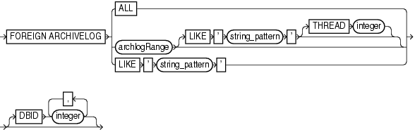

Use the foreignlogRecordSpecifier subclause to specify a set of foreign archived redo logs for use in RMAN operations.
Foreign archived redo logs are received by a logical standby database for a LogMiner session. Unlike normal archived logs, foreign archived logs have a different DBID. For this reason, they cannot be backed up or restored on a logical standby database.
A logical standby database creates foreign archived logs in the flash recovery area if the following conditions are met:
A flash recovery area is configured on the logical standby database.
One of the LOG_ARCHIVE_DEST_n initialization parameters is set to 'LOCATION=USE_DB_RECOVERY_FILE_DEST' with a proper VALID_FOR setting to receive foreign archived logs.
The COMPATIBLE initialization parameter is set to a value greater than or equal to 11.0.0.
The semantics are exactly the same as for archivelogRecordSpecifier except that the logs are foreign archived redo logs.
