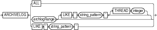

Use the archivelogRecordSpecifier subclause to specify a set of archived redo logs for use in RMAN operations.
archlogRange::=
This subclause specifies either all archived redo logs or logs whose filenames match a specified pattern.
| Syntax Element | Description |
ALL |
Specifies all available archived logs. |
LIKE 'string_pattern' |
Specifies all archived logs that match the specified string_pattern. You can use the same pattern matching characters that are valid in the LIKE operator in the SQL language to match multiple files.

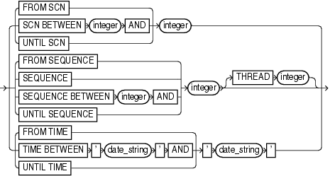

This subclause specifies a range of archived redo logs by SCN, time, restore point (which is a label for a timestamp or SCN), or log sequence number. This subclause is useful for identifying the point to which you want the database to be recoverable.
RMAN queries the V$ARCHIVED_LOG or RC_ARCHIVED_LOG view to determine which logs to include in the range. When you specify a time, SCN, or restore point, RMAN determines the range according to the contents of the archived redo logs, not when the logs were created or backed up. When you specify the range by log sequence number, then RMAN uses the sequence number to determine the range.
Table 3-1 explains how RMAN determines which logs are in the range. The columns FIRST_TIME, NEXT_TIME, and so on refer to columns in V$ARCHIVED_LOG. For example, if you specify FROM SCN 1000 UNTIL SCN 2000, then RMAN includes all logs whose V$ARCHIVED_LOG.NEXT_SCN value is greater than 1000 and whose V$ARCHIVED_LOG.FIRST_SCN value is less than or equal to 2000.

Oracle Database Reference to learn how to use theNLS_LANG and NLS_DATE_FORMAT environment variables to specify time format| Syntax Element | Description |
FROM SCN integer |
Specifies the beginning SCN for a range of archived redo log files. If you do not specify the UNTIL SCN parameter, then RMAN includes all available log files beginning with SCN specified in the FROM SCN parameter. |
SCN BETWEEN integer AND integer |
Specifies the beginning and ending SCN for a range of logs. This syntax is semantically equivalent to FROM SCN integer1 UNTIL SCN integer2. |
UNTIL SCN integer |
Specifies the ending SCN for a range of archived redo log files (see Table 3-1 for the rules determining the range). |
FROM SEQUENCE integer |
Specifies the beginning log sequence number for a sequence of archived redo log files (see Table 3-1 for the rules determining the range).
Note: You can specify all log sequence numbers in a thread by using the syntax shown in Example 3-6. |
SEQUENCE integer |
Specifies a single log sequence number. |
SEQUENCE BETWEENinteger AND integer |
Specifies a range of log sequence numbers. This syntax is semantically equivalent to FROM SEQUENCE integer1 UNTIL SEQUENCE integer2. |
UNTIL SEQUENCE integer |
Specifies the terminating log sequence number for a sequence of archived redo log files (see Table 3-1 for the rules determining the range). |
THREAD integer |
Specifies the thread containing the archived redo log files you want to include. This parameter is only necessary the database is in an Oracle RAC configuration.
Although the |
FROM TIME 'date_string' |
Specifies the beginning time for a range of archived redo logs (see Table 3-1 for the rules determining the range). Example 3-5 shows FROM TIME in a LIST command. |
TIME BETWEEN'date_string'AND 'date_string' |
Specifies a range of times. This syntax is semantically equivalent to FROM TIME 'date_string' UNTIL TIME 'date_string'. |
UNTIL TIME 'date_string' |
Specifies the end time for a range of archived redo logs (see Table 3-1 for the rules determining the range). Example 3-4 shows UNTIL TIME in a BACKUP command. |
