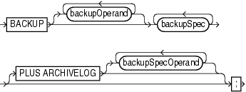

(backupOperand::=, backupSpec::=, backupSpecOperand::=)
(deviceSpecifier::=, fileNameConversionSpec::=, formatSpec::=, forRecoveryOfSpec::=, keepOption::=, notBackedUpSpec::=, sizeSpec::=, skipSpec::=)

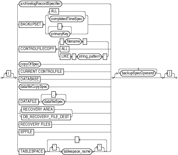

backupSpec::=
(archivelogRecordSpecifier::=, completedTimeSpec::=, copyOfSpec::=, datafileCopySpec::=, datafileSpec::=, backupSpecOperand::=)

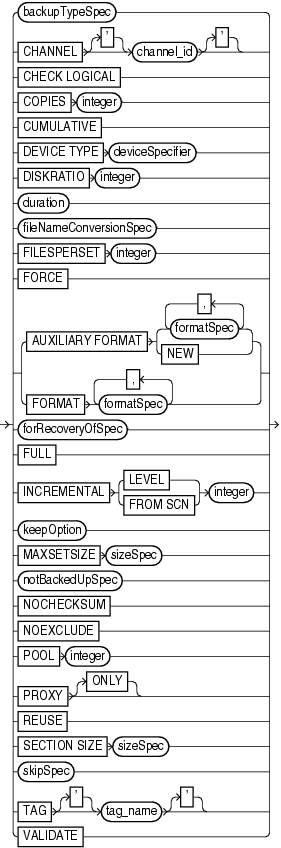

This subclause specifies options such as the device type and output format. Refer to backupOperand::= for the syntax diagram.
| Syntax Element | Description |
| backupTypeSpec | Specifies the type of backup being created, either backup sets ( ) or image copies ().See Also:  |
| CHANNELchannel_id | Specifies the case-sensitive name of a channel to use when creating backups. Use any meaningful name, for example ch1ordev1. The database uses the channel ID to report I/O errors. If you do not set this parameter, then RMAN dynamically assigns the backup sets to any available channels during execution.As shown in Example 2-23, you can use  Note: You can also specify this parameter in the  |
| CHECK LOGICAL | Tests data and index blocks that pass physical corruption checks for logical corruption (see Example 2-25). This option typically adds 1-3% overhead. Examples of logical corruption are corruption of a row piece or index entry. If RMAN finds logical corruption, then it logs the block in the alert log and server session trace file. The  By default, the  If  |
| COPIESinteger | Sets the number of identical backups ( 1-4) that RMAN creates. The default value is1.You can use multiple format strings to specify different names and locations for the copies. Example 2-22 illustrates a duplexed backup to different locations on disk. RMAN can duplex backups to either disk or tape, but cannot duplex backups to tape and disk simultaneously. When backing up to tape, ensure that the number of copies does not exceed the number of available tape devices. Also, if  You can specify duplexing on more than one command. The order of precedence is as follows, with settings higher on the list overriding lower settings: Note: This option does not apply with  Note: Duplexing cannot be used when creating files in the flash recovery area. |
| CUMULATIVE | Copies the data blocks used since the most recent level 0 backup (see Example 2-16). Note: This option does not apply with  |
| DEVICE TYPEdeviceSpecifier | Allocates automatic channels for the specified device type only. For example, if you configure disk and tape channels, then configure sbtas the default device type, then the following command allocates disk channels only:BACKUP DEVICE TYPE DISK DATABASE; The  Note: You cannot specify  See Also:  |
| DISKRATIOinteger | Directs RMAN to populate each backup set with datafiles from at least integer disks. This parameter is only enabled when you are backing up datafiles or control files, and when the operating system can give RMAN disk contention and node affinity data. To manually disable this feature, set  For example, assume that datafiles are distributed across 10 disks. If the disks supply data at 10 bytes/second, and if the tape drive requires 50 bytes/second to keep streaming, then set  If you set  The
 Note: Do not spread I/O over more than the minimum number of disks required to keep the tape streaming. Otherwise, you increase restore time for a file without increasing performance. |
| duration | Specifies options related to the maximum time for a backup command to run. See Also:  |
| fileNameConversionSpec | This option is valid only when BACKUPis creating image copies. Files being copied are renamed according to the specified patterns. If a file being backed up has a name that does not match any of the specified rename patterns, then RMAN usesFORMATto name the output image copies. If noFORMATis specified, then RMAN uses the default format.See Also:  |
| FILESPERSETinteger | Specifies the maximum number of input files to include in each output backup set. This parameter is only relevant when BACKUPgenerates backup sets.RMAN backs up the files in each  The RMAN behavior is illustrated by the following  BACKUP AS BACKUPSET (DATAFILE 3, 4, 5, 6, 7) (DATAFILE 8, 9); BACKUP AS BACKUPSET DATAFILE 3, 4, 5, 6, 7, 8, 9; BACKUP AS BACKUPSET DATAFILE 3, ... 72; In the first command, RMAN places datafiles 3, 4, 5, 6, and 7 into one backup set and datafiles 8 and 9 into another backup set. In the second command, RMAN places all datafiles into one backup set. In the third command, the ellipses indicate datafiles 3 through 72. Because in this case RMAN is backing up 70 datafiles, RMAN places 64 files in one backup set and 6 in another. By default, RMAN divides files among backup sets in order to make optimal use of channel resources. The number of files to be backed up is divided by the number of channels. If the result is less than 64, then this number is the  Note: You cannot specify the number of backup pieces that should be in a backup set. |
| FORCE | Forces RMAN to ignore backup optimization. That is, even if CONFIGUREBACKUP OPTIMIZATIONis set toON, RMAN backs up all specified files and undo data for active transactions.Note: You can also specify this option in the  |
| AUXILIARY FORMAT | Copies the files on the target database to the specified location on the auxiliary instance. RMAN can only generate image copies when AUXILIARY FORMATis specified. RMAN must be connected to bothTARGETandAUXILIARYinstances and have access to auxiliary channels.You can use the  |
|    formatSpec | Specifies a pattern for naming the output image copies on an auxiliary instance. The path must be valid on the auxiliary host. See Also:  |
|    NEW | Creates an image copy in the directory specified in the DB_CREATE_FILE_DESTinitialization parameter of the auxiliary instance. The image copy is an Oracle-managed file. |
| FORMATformatSpec | Specifies a pattern for naming the output backup pieces or image copies (see Example 2-17). For , if one or more of the directories mentioned in the specified format does not exist, then RMAN signals an error.The default location for disk backups depends on whether a flash recovery area is enabled and whether
 To create RMAN backups in the flash recovery area with names in Oracle Managed Files format, do not specify the  Note: You cannot specify an Oracle Managed Files filename as the format for a backup. For example, if  Backup pieces must have unique names. The maximum length of a backup piece filename is platform-specific. For backups to a media manager, the length is also limited by the limit in the supported version of the media management API. Vendors supporting SBT 1.1 must support filenames up to 14 characters. Some SBT 1.1 vendors may support longer filenames. Vendors supporting SBT 2.0 must support filenames up to 512 characters. Some SBT 2.0 vendors may support longer filenames. You cannot specify multiple, identical  Note: If you are making an archival backup with the  See Also:  |

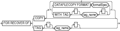

| forRecoveryOfSpec | Identifies the backup being created as an incremental backup to be used in rolling forward an image copy. See Also:  |
| FULL | Creates a backup of all blocks of datafiles included in the backup. FULLis the opposite ofINCREMENTAL. RMAN makes full backups by default if neitherFULLnorINCREMENTALis specified.A full backup has no effect on subsequent incremental backups and is not considered a part of any incremental backup strategy. A full image copy backup can be incrementally updated, however, by applying incremental backups with the  Note: Unused block compression, which is described in the entry for  |
| INCREMENTAL LEVELinteger | Copies only those data blocks that have changed since the last incremental integerbackup, whereintegeris0or1(see Example 2-16).See "Incremental Backups" for an explanation of incremental backups. |
| INCREMENTAL FROM SCNinteger | Creates an incremental backup of all specified datafiles that includes all datafile blocks changed at SCNs greater than or equal to the specified SCN. One use of this option is to refresh a standby database with changes from the primary database (see Example 2-24, and the chapter on RMAN backups in Oracle Data Guard Concepts and Administration). This backup contains all changed blocks since the standby database was created or last synchronized. At the standby database, you can use  If you are not making incremental backups based on Volume Shadow Copy Service (VSS) snapshots, then you should specify  If you specify  Note: You cannot use  See Also: Oracle Database Platform Guide for Microsoft Windows to learn about making backups with VSS |
| keepOption | Overrides any configured retention policy for this backup so that the backup is not considered obsolete, as shown in Example 2-26. You can use the  Note: You cannot use  With the  Note: You can use  See Also:  |
| MAXSETSIZEsizeSpec | Specifies a maximum size for a backup set (as shown in Example 2-17). RMAN limits all backup sets to this size. It is possible for a backup set to span multiple tapes, so blocks from each datafile are written to multiple tapes. If one tape of a multivolume backup set fails, then you lose the data on all the tapes rather than just one. Because a backup set always include a whole file rather than part of a file, you can use  Specify size in bytes (default), kilobytes ( The default number of files in each backup set is determined by  Note: This option results in an error message if used with  |
| notBackedUpSpec | Limits the set of archived redo log files to be backed up according to whether a specified number of backups are already present (and not obsolete), or whether the logs have been backed up since a specified date. See Also:  |
| NOCHECKSUM | Suppresses block checksums during the backup. A checksum is a number that is computed from the contents of a data block.  Note: You cannot disable checksums for datafiles in the  By default, the  When restoring a backup datafile, RMAN honors the  Note: You can turn off checksum checking by specifying  See Also: Oracle Database Reference for more information about the  |
| NOEXCLUDE | When specified on a BACKUPDATABASEorBACKUP COPY OF DATABASEcommand, RMAN backs up all tablespaces, including any for which aCONFIGUREEXCLUDEcommand has been entered. This option does not overrideSKIPOFFLINEorSKIP READONLY. |
| POOLinteger | Specifies the media pool in which the backup should be stored. Consult your media management documentation to see whether POOLis supported.Note: This option does not work with  |
| PROXY | Backs up the specified files by means of the proxy copy functionality, which gives the media management software control over the data transfer between storage devices and the datafiles on disk. The media manager—not RMAN—decides how and when to move data. When you run
 Note: If you specify  Note: This option does not work with  |
|    ONLY | Causes the database to issue an error message when it cannot proxy copy rather than creating conventional backup sets. If you do not want RMAN to try a conventional copy when a proxy copy fails, use the ONLYoption |
| REUSE | Enables RMAN to overwrite an already existing backup or copy with the same filename as the file that BACKUPis currently creating. |
| SECTION SIZEsizeSpec | Specifies the size of each backup section produced during a datafile or datafile copy backup. By setting this parameter, RMAN can create a multisection backup. In a multisection backup, RMAN creates a backup piece that contains one file section, which is a contiguous range of blocks in a file. All sections of a multisection backup are the same size. File sections enable RMAN to create multiple steps for the backup of a single large datafile. RMAN channels can process each step independently and in parallel, with each channel producing one section of a multisection backup set. If you specify a section size that is larger than the size of the file, then RMAN does not use multisection backup for the file. If you specify a small section size that would produce more than 256 sections, then RMAN increases the section size to a value that results in exactly 256 sections. Note: Depending on where you specify this parameter in the RMAN syntax, you can specify different section sizes for different files in the same backup job. Note: You cannot use  |
| skipSpec | Excludes datafiles or archived redo logs from the backup if they are inaccessible, offline, or read-only. See Also:  |
| TAGtag_name | Specifies a user-specified tag name for a backup set, proxy copy, datafile copy, or control file copy. The tag is applied to the output files generated by the BACKUPcommand.The tag name is not case-sensitive. The name must be 30 characters or less. The characters are limited to the characters that are valid in filenames on the target file system. For example, ASM does not support the use of the hyphen ( Typically, a tag name is a meaningful name such as  If you do not specify a tag name, then by default RMAN creates a tag for backups (except for control file autobackups). The default tag uses the format  You can also specify the tag at the
 Note: A tag is an attribute of each backup piece in a given copy of a backup set (for  |
| VALIDATE | Scans the specified files and verifies their contents, testing whether this file can be backed up and whether the data blocks are corrupt. RMAN creates no output files. This option is equivalent to using the  If you do not specify  You can use the  If you execute  Note: You cannot validate backups of backup sets. |
This subclause specifies a list of one or more objects to be backed up. Each backupSpec clause generates one or more backup sets (AS BACKUPSET) or image copies (AS COPY). For AS BACKUPSET, the backupSpec clause generates multiple backup sets if the number of datafiles specified in or implied by its list of objects exceeds the default limit of 4 datafiles or 16 archived logs in each backup set. Refer to backupSpec::= for the syntax diagram.
| archivelogRecordSpecifier | Specifies a range of archived redo logs to be backed up. When backing up archived redo logs, RMAN can perform archived log failover automatically. RMAN backs up the log when at least one archived log corresponding to a given log sequence number and thread is available. Also, if the copy that RMAN is backing up contains corrupt blocks, then it searches for good copies of these blocks in other copies of the same archived logs. RMAN does not signal an error if the command finds no logs to back up, since this situation probably exists because no new logs were generated after the previous  If you specify  If the database is open when you run  Note: If you run  See Also:  |
| BACKUPSET | Specifies a backup of backup sets. Use this parameter in conjunction with the DEVICE TYPEsbtclause to offload backups on disk to tape (as shown in Example 2-21). You cannot back up from tape to tape or from tape to disk: only from disk to disk or disk to tape.If you specify the  RMAN performs backup set failover when backing up backup sets. RMAN searches for all available backup copies when the copy that it is trying to back up is corrupted or missing. This behavior is similar to RMAN's behavior when backing up archived logs that exist in multiple archiving destinations. If backup optimization is enabled when you back up a backup set, and if the identical backup set has already been backed up to the same device type, then RMAN skips the backup of this backup set. Note: You can duplex backups of backup sets with  Note: When you use  |
|    ALL | Specifies all backup sets. |
|    completedTimeSpec | Identifies backup sets according to completion time. See Also:  |
|    integer | Specifies backup sets according to primary key. You can obtain the primary keys for backup sets from the output of the LISTBACKUPcommand. |
| CONTROLFILECOPY | Specifies one or more control file copies for backups. A control file copy can be created with the  Note: A control file autobackup is not a control file copy. |
|    'filename' | Specifies a control file copy by filename. |
|    ALL | Specifies all control file copies. |
|    LIKE'string_pattern' | Specifies a control file copy by a filename pattern. The percent sign ( %) as a wildcard meaning 0 o r more characters; an underscore (_) is a wildcard meaning 1 character. |
| copyOfSpec | Makes a backup of previous image copies of datafiles and possibly control files. See Also:  |
| CURRENT CONTROLFILE | Specifies the current control file. |
| DATABASE | Creates a backup of all datafiles in the database. If generating a backup set, then RMAN can include only datafiles and control files: it cannot include archived redo logs. If the  If the  Full database backups should usually be either image copies or compressed backup sets. Image copies are more flexible than backup sets for some purposes (such as use in an incrementally updated backups strategy), and compressed backup sets make more efficient use of storage space, if the CPU overhead involved in creating them is tolerable. Note: To force RMAN to include the current control file in the backup when  See Also: The  |

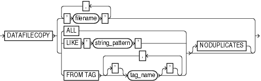

| datafileCopySpec | Specifies the filenames of one or more datafile image copies. See Also:  |
| DATAFILEdatafileSpec | Specifies a list of one or more datafiles. Refer to description of BACKUPDATABASEfor RMAN behavior when datafile 1 is backed up.See Also:  |
| RECOVERY AREA | Backs up recovery files created in the current and all previous flash recovery area destinations. The backup must go to SBT. Recovery files are full and incremental backup sets, control file autobackups, datafile copies, and archived redo logs. If an archived redo log file is missing or corrupted, then RMAN looks outside of the recovery area for a good copy of the log that it can use for the backup. Flashback logs, the current control file, and online redo logs are not backed up. By default, backup optimization is enabled for this command even if the  Note: If the flash recovery area is not enabled but has been enabled in the past, then files created in the previous flash recovery area location are backed up. |
| DB_RECOVERY_FILE_DEST | RECOVERY AREAandDB_RECOVERY_FILE_DESTare synonyms. |
| RECOVERY FILES | Backs up all recovery files on disk, whether they are stored in the flash recovery area or other locations on disk. The backup must go to SBT. Recovery files include full and incremental backup sets, control file autobackups, archived redo log files, and datafile copies. By default, backup optimization is enabled for this command even if the  |
| SPFILE | Specifies that the server parameter file should be included in a backup set. The AS COPYoption is not supported for server parameter file backups.RMAN backs up the server parameter file currently in use by the target database. RMAN cannot back up the server parameter file when the instance was started with an initialization parameter file. RMAN cannot make incremental backups of the  |
| TABLESPACEtablespace_name | Specifies the names of one or more tablespaces. RMAN translates tablespace names internally into a list of datafiles, then backs up all datafiles that are currently part of the tablespaces. If the SYSTEMtablespace (and thus datafile 1) is included in the backup, and ifCONTROLFILE AUTOBACKUPis not configured, then RMAN also creates a copy of the control file.You cannot back up locally-managed temporary tablespaces, although you can back up dictionary-managed tablespaces. If the following conditions are met, then RMAN can back up transportable tablespaces that have not been made read/write after being transported:
 If any of the preceding conditions is not met, then RMAN automatically skips transportable tablespaces that have not yet been made read/write. Note that if you specify a transportable tablespace explicitly when any of the conditions is not met, then RMAN issues an error saying that the tablespace does not exist. Note: If you rename a tablespace, then RMAN detects that the tablespace has changed its name and updates the recovery catalog on the next resynchronization. |
| backupSpecOperand | The backupSpecOperandthat follows aspecifies options that apply to the. |

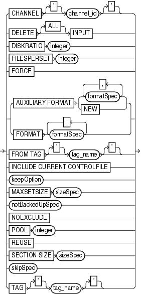

This subclause specifies a variety of options and parameters that affect the backupSpecbackupOperand. Options that are not shared in common with backupOperand are listed here. Refer to backupSpecOperand::= for the syntax diagram.
| DELETE [ALL] INPUT | Deletes the input files after successfully backing them up. Specify this option only when backing up archived redo logs, datafile copies ( Specifying the  The  Note: The database retains archived redo logs in the flash recovery as long as possible and deletes them automatically when additional disk space is required. You can use the  |
| FROM TAGtag_name | Identifies files by tag name (see Example 2-18). Defined in context with several other commands. |
| INCLUDE CURRENT CONTROLFILE | Creates a snapshot of the current control file and places it into one of backup sets produced by the BACKUPcommand.Note: This option does not apply with  |

This subclause specifies datafile copies. Refer to datafileCopySpec::= for the syntax diagram.
| 'filename' | Specifies the filenames of one or more datafile image copies. |
| ALL | Specifies that all datafile image copies should be backed up. |
| LIKE'string_pattern' | Specifies a filename pattern. The percent sign ( %) is a wildcard that means zero or more characters; an underscore (_) is a wildcard that means one character. |
| FROM TAGtag_name | Specifies a list of one or more datafile copies, identified by the tag name. If multiple datafile copies with this tag exist, then RMAN backs up only the most current datafile copy of any particular datafile. Tags are not case sensitive. |
|    NODUPLICATES | Prevents the inclusion of identical datafile copies in a backup operation (Example 2-29). For each set of duplicate datafile copies, the file with the most recent timestamp will be selected. |

This subclause specifies that a backup should be used in an incrementally updated backup strategy. You must specify INCREMENTAL LEVEL 1 when specifying FOR RECOVER OF. Refer to forRecoveryOfSpec::= for the syntax diagram.
| FOR RECOVER OF COPY | Specifies that this incremental backup should contain all changes since the SCN of a specified datafile copy (level 0 incremental backup) of the target database (see Example 2-20). A  The datafile copies should be identified with either a  See Also: Oracle Database Backup and Recovery User's Guide to learn how to make incrementally updated backups |
|    WITH TAGtag_name | Specifies the tag of the level 0 incremental backup serving as the basis of the incremental backup. If no level 0 backup with the tag specified in the  By using the  |
|    DATAFILECOPY   FORMATformatSpec | Specifies a pattern for naming the output image copies. |
| FOR RECOVER OF TAGtag_name | Backs up the archived redo log files or incremental backups that are intended to recover the level 0 incremental backup specified by tag_name.For example, the  |
