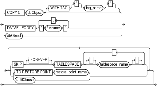

This subclause specifies which files to recover. Refer to recoverObject::= for the syntax diagram.
| Syntax Element | Description |
COPY OF dbObject |
Applies incremental backups to the specified image copy to roll it forward to any time equal to or before the most recent incremental backup of the file. The existing image copy is overwritten and remains in a fuzzy state during the recovery. RMAN makes an autobackup after recovering the image copy.
 This command updates a datafile copy and is not a media recovery of a current database file. This command is meant to be used in conjunction with the  The following requirements must be met:
 RMAN selects one suitable copy if there are multiple possible copies to which the incremental backups can be applied to carry out the operation. Note: RMAN issues a warning (not an error) if it cannot recover to the specified time because no incremental backups are available.  |
   WITH TAG tag_name |
Specifies a tag name to identify the image copy to be rolled forward. |
DATAFILECOPY 'filename' |
Applies incremental backups to the specified datafile image copy (see Example 2-98). Refer to description of RECOVER COPY OF. |
dbObject |
Specifies the data blocks that require recovery.
 See Also:   |
SKIP |
Takes the datafiles in the specified tablespaces offline before starting media recovery. These files are left offline after the media recovery is complete.
 This option is useful for avoiding recovery of tablespaces containing only temporary data or for postponing recovery of some tablespaces.  |
   FOREVER |
Takes the datafiles offline with the DROP option (see Example 2-97). Use SKIP FOREVER TABLESPACE when you intend to drop the specified tablespaces after opening the database with the RESETLOGS option.
Note: If you perform incomplete recovery, then   |
   TABLESPACE   tablespace_name |
Specifies the name of the tablespace to take offline. |
TO RESTORE POINTrestore_point_name |
Specifies a restore point for termination of the RECOVER command, with the SCN at which the restore point was created as the upper, inclusive limit. Because the limit is inclusive, RMAN selects only files that can be used to recover up to and including the SCN corresponding to the restore point. |
untilClause |
Specifies a past time, SCN, or log sequence number for termination of the RECOVER command.
When used with one or more tablespaces, the clause indicates a tablespace point-in-time recovery (TSPITR) operation for the named tablespaces. The clause cannot be used with  See Also:   |

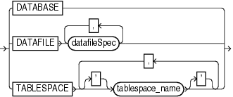

This subclause specifies whether to recover the database or a subset of the database. Refer to dbObject::= for the syntax diagram.
DATABASE |
Specifies that the entire database is to be recovered (see Example 2-97). The database must be mounted but not open.
 By default, the  When recovering after the loss of control files, RMAN automatically updates the control file to point to the actual location of the datafiles on disk (see Example 2-99). Note: If the RMAN encounters redo for adding a datafile, then RMAN automatically creates a new datafile unless the tablespace containing the added datafile is skipped during recovery. This situation can arise when a backup control file is restored prior to recovery and the backup control file does not contain a record of the recently-added datafile.  |
DATAFILE datafileSpec |
Specifies a list of one or more datafiles to recover by either filename or absolute datafile number. The target database must be mounted or open. If the database is open, then the datafiles to be recovered must be offline.
 If you are not using a recovery catalog, then the filename must be the name of the datafile as recorded in the control file. If you are using a recovery catalog, then the filename of the datafile must be the most recent name recorded in the catalog, even if the name in the control file has been updated more recently. For example, assume that a datafile was renamed in the control file, but the instance fails before you resynchronize the catalog. Specify the old name of the datafile in the  Note: You cannot arbitrarily recover individual datafiles to different points in time, although you can recover the whole database to a single point in time or recover wholly contained tablespaces to a point in time different from the rest of the database (TSPITR). For more information on TSPITR, see the procedure described in Oracle Database Backup and Recovery User's Guide. See Also:   |
TABLESPACEtablespace_name |
Specifies a list of one or more tablespaces to recover (see Example 2-95 and Example 2-96). The target database must be mounted or open. If the database is open, then the tablespaces to be recovered must be offline.
 Note: If the RMAN encounters redo for adding a datafile, then RMAN automatically creates a new datafile. This situation can arise when a backup control file is restored prior to recovery and the backup control file does not contain a record of the recently-added datafile.  |

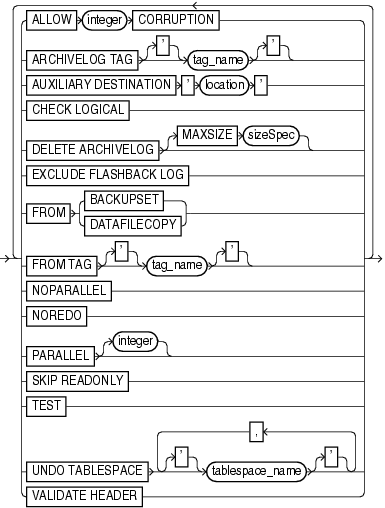

This subclause specifies various recovery options. Refer to recoverOptionList::= for the syntax diagram.
ALLOW integer CORRUPTION |
Specifies the number of corrupt blocks that can be tolerated while allowing recovery to proceed.You can set this parameter in case of redo log corruption. |
ARCHIVELOG TAG tag_name |
Specifies the tag for an archived log backup to be used during recovery. Tag names are not case sensitive and display in all uppercase. If the tagged backup does not contain all the necessary archived redo logs for recovery, then RMAN uses logs or incremental backups as needed from whatever is available. |
AUXILIARY DESTINATION'location' |
Specifies a location where auxiliary set datafiles, control files, and online redo logs are created during TSPITR if another location for an individual file is not explicitly specified.
 If you do not specify  See also: The chapter on TSPITR in Oracle Database Backup and Recovery User's Guide for more details about the auxiliary destination  |
CHECK LOGICAL |
Tests data and index blocks that pass physical corruption checks for logical corruption, for example, corruption of a row piece or index entry. If RMAN finds logical corruption, then it logs the block in the alert.log and server session trace file.
The  If the total number of physical and logical corruptions detected for a file is less than its   |
DELETE ARCHIVELOG |
Deletes archived logs restored from backups or copies that are no longer needed. RMAN does not delete archived logs that were already on disk before the RESTORE command started. If you do not specify MAXSIZE, then RMAN deletes restored archived logs as they are applied.
Note: If archived redo logs are restored to the flash recovery area, then the   |
   MAXSIZE sizeSpec |
Does not use more than sizeSpec amount of disk space for restored archived redo logs. If recovery requires the restore of a log larger than the MAXSIZE value, then RMAN reports an error indicating that you should increase the MAXSIZE value. If MAXSIZE is smaller than the backup set containing the logs, then RMAN must read the backup set more than once to extract the logs. In this situation, RMAN issues a warning that MAXSIZE should be increased. |
EXCLUDE FLASHBACK LOG |
Specifies that the flashback logs should not be searched for blocks to restore. By default, RMAN searches the flashback logs if Flashback Database is enabled. |
FROM BACKUPSET |
Specifies that only backup sets should be restored. |
FROM DATAFILECOPY |
Specifies that only datafile image copies should be restored. |
FROM TAG tag_name |
Specifies the tag for an incremental backup to be used during recovery. If the tagged backup does not contain all the necessary incrementals for recovery, then RMAN uses logs or incremental backups as needed from whatever is available. Tag names are not case sensitive and display in all uppercase.
 See Also:   |
NOPARALLEL |
Specifies that media recovery should not be performed in parallel. Parallel execution is the default for RECOVER (see the description of the RECOVER ... PARALLEL option). |
NOREDO |
Suppresses the application of redo logs during recovery. Only incremental backups are applied.
 One use of this option is to use incremental backups to update full backups of  Note: Incremental backups of  Another use is to update standby or duplicate databases. Incremental backups created with the   |
PARALLEL |
Specifies parallel recovery (default).
 By default, the database uses parallel media recovery to improve performance of the roll forward phase of media recovery. To override the default behavior of performing parallel recovery, use the  In parallel media recovery, the database uses a "division of labor" approach to allocate different processes to different data blocks while rolling forward, thereby making the operation more efficient. The number of processes is derived from the  Typically, recovery is I/O-bound on reads from and writes to data blocks. Parallelism at the block level may only help recovery performance if it increases total I/Os, for example, by bypassing operating system restrictions on asynchronous I/Os. Systems with efficient asynchronous I/O see little benefit from parallel media recovery. Note: The  See Also: The description of the   |
   integer |
Specifies the integer degree of parallelism.
Each parallel thread may use one or two parallel execution servers. Typically, it is not necessary for you to specify the degree of parallelism.  |
SKIP READONLY |
Omits read-only files from the recovery. |
TEST |
Initiates a trial recovery.
 A trial recovery is useful if a normal recovery procedure has encountered a problem. It enables the database to look ahead into the redo stream to detect possible problems. The trial recovery applies redo in a way similar to normal recovery, but it does not write changes to disk and it rolls back its changes at the end of the trial recovery. Note: You can use this clause only if you have restored a backup taken since the last   |
UNDO TABLESPACEtablespace_name |
Specifies a list of tablespaces with undo segments at the target time. Only for use with RECOVER TABLESPACE.
During TSPITR, RMAN needs information about which tablespaces had undo segments at the TSPITR target time. This information is usually available in the recovery catalog, if one is used. If there is no recovery catalog, or if the information is not found in the recovery catalog, then RMAN proceeds assuming that the set of tablespaces with undo segments at the target time is the same as the set of tablespaces with undo segments at the present time. If this assumption is not correct, TSPITR fails with an error. In such a case, you can use   |
VALIDATE HEADER |
Reports and validates—but does not restore—the backups that RMAN could use to restore files needed for the recovery.
 When you run  See Also: The description of the   |
