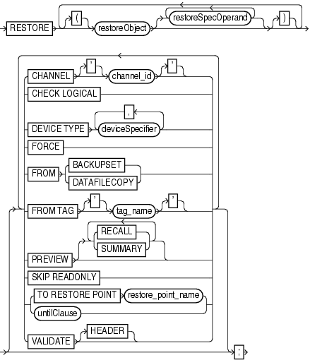

restore::=
(restoreObject::=, restoreSpecOperand::=, deviceSpecifier::=, untilClause::=)
(archivelogRecordSpecifier::=, datafileSpec::=)
This clause enables you to select which files you want to restore and specify parameters that control the behavior of the restore operation.
| Syntax Element | Description |
| restoreObject | Specifies the files to be restored. |
| restoreSpecOperand | Specifies options for the restoreObjectclause. |
| CHANNELchannel_id | Refer to the restoreSpecOperandclause. |
| CHECK LOGICAL | Tests data and index blocks that pass physical corruption checks for logical corruption, for example, corruption of a row piece or index entry. If RMAN finds logical corruption, then it logs the block in the alert log and server session trace file. If the total number of physical and logical corruptions detected in a file is less than its  When restoring a backup datafile, RMAN honors the  Note: The  |
| DEVICE TYPEdeviceSpecifier | Allocates automatic channels for the specified device type only. For example, if you configure automatic disk and tape channels, and issue RESTORE ... DEVICE TYPE DISK, then RMAN allocates only disk channels. You must have already configured a device type by usingCONFIGURE(except forDISK, which is preconfigured) before specifying theDEVICE TYPEoption.Note: You cannot manually allocate channels within a  See Also:  |
| FORCE | Overrides the restartable restore feature and restores all files regardless of whether they need to be restored. If you do not specify FORCE, then RMAN restores a file only if its header information does not match the information in the control file. |
| FROM BACKUPSET | Specifies that RMAN should restore from backup sets only. By default RESTOREchooses the file copy or backup set that needs the least media recovery.If you use the  |
| FROM DATAFILECOPY | Specifies that RMAN should restore datafile copies only. By default RESTOREchooses the file copy or backup set that needs the least media recovery. If you use theFROM DATAFILECOPYoption, then the allocated channels must be ofDEVICE TYPE DISK. |
| FROM TAGtag_name | Refer to the restoreSpecOperandclause. |
| PREVIEW | Reports—but does not restore—the backups and archived redo logs that RMAN could use to restore and recover the database to the specified time. RMAN queries the metadata and does not actually read the backup files. The  Some media managers provide status information to RMAN about which backups are offsite. Offsite backups are stored in a remote location, such as a secure storage facility, and cannot be used without retrieving media. Offsite backups are marked as  If a needed backup is stored offsite, but the media manager does not support offsite backups, then your options are:
 See Also:  |
|    RECALL | Instructs the media manager to retrieve the backup media needed for the specified restore operation from offsite storage (see Example 2-119). Note: This option only works if your media manager supports this functionality. You can use  |
|    SUMMARY | Summarizes the backups that RMAN would restore. The output is in the same format as the output of the LIST BACKUPS ... SUMMARYcommand. |
| SKIP READONLY | Does not restore read-only files. |
| TO RESTORE POINTrestore_point_name | Specifies a restore point, with the SCN at which the restore point was created as the upper, inclusive limit. Because the limit is inclusive, RMAN selects only files that can be used to restore files up to and including the SCN corresponding to the restore point. |
| untilClause | Limits the selection to backup sets or file copies that are suitable for a point-in-time recovery to the specified time, SCN, or log sequence number. In the absence of any other criteria, RMAN selects the most current file copy or backup set to restore. Note that the time specified in the  See Also:  |
| VALIDATE | Specifies that RMAN should decide which backup sets, datafile copies, and archived redo log files need to be restored, and then validate them (see Example 2-120). No files are restored. For files on both disk and tape, RMAN reads all blocks in the backup piece or image copy. RMAN also validates offsite backups. The validation is identical to a real restore operation except that RMAN does not write output files. Note: If you use  See Also:  |
|    HEADER | Reports and validates—but does not restore—the backups that RMAN could use to restore to the specified time. When you specify this option, RMAN performs the same functions as when you run  See Also: The descriptions of the  |

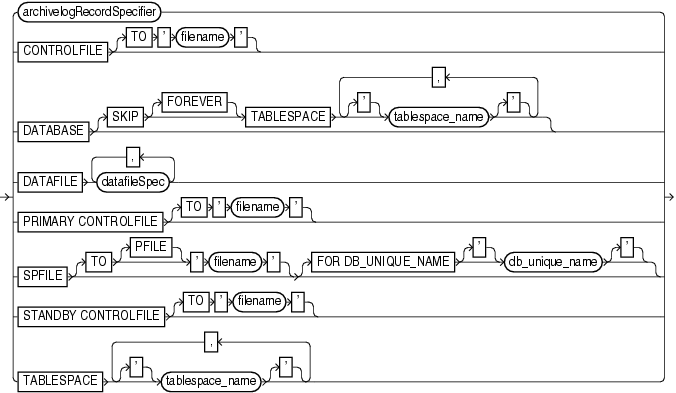

This subclause specifies the objects to be restored: control files, datafiles, archived redo logs, or the server parameter file. Note that RMAN does not support backup and recovery of the change tracking file. RMAN re-creates the change tracking file after database restore and recovery; the next incremental backup after any recovery is able to use the file. Thus, restore and recovery has no user-visible effect on change tracking.
| archivelogRecordSpecifier | Restores the specified range of archived redo logs. The default restore location is  Because the  Note: The database can be started, mounted, or open for this operation. See Also:  |
| CONTROLFILE | Restores either a standby or backup control file depending on the target database role. If the control file is lost, then restore the control file (see Table 2-36) and restore the database after mounting the restored control file. You must always run the  Note: If the target database is not mounted, and if RMAN is not connected to a recovery catalog, then you must specify the  When you run  |
|    TO'filename' | Restores the control file to the specified filename. Table 2-36 explains RMAN behavior when restoring the control file with the  |
| DATABASE | Restores all datafiles in the database except those that are offline. By default, RMAN restores datafiles in read-only tablespaces. Unlike  Note: To restore offline datafiles you must use  |
|    SKIP [FOREVER]   TABLESPACE   tablespace_name | Excludes the specifies tablespaces from the restore operation. This option is useful to avoid restoring tablespaces containing temporary data. Specifying the  |
| DATAFILEdatafileSpec | Restores the datafiles specified by filename or absolute datafile number (see Example 2-113). Note: Do not specify a datafile more than once in a restore job. For example, the following command is invalid because datafile 1 is both specified explicitly and implied by the  RESTORE TABLESPACE SYSTEM DATAFILE 1; See Also:  |
| PRIMARY CONTROLFILE | Restores a control file for a primary database in a Data Guard environment. RMAN restores either a normal or standby control file as appropriate, depending on the most recent database role known to the recovery catalog ( Assume that you perform a switchover from primary database  |
| SPFILE | Restores a primary or standby server parameter file to the location from which it was backed up. RMAN cannot overwrite a server parameter file currently in use by the target database. By default RMAN restores the most current server parameter file. Specify the  If the server parameter file is lost, then connect RMAN to the target database (and recovery catalog if used) and run  Note: If the target database is not mounted, and if RMAN is not connected to a recovery catalog, then you must specify the  |
|    TO [PFILE]'filename' | Restores a primary or standby server parameter file to the location specified by the TOclause. SpecifyPFILEto save the server parameter file as a text-based initialization parameter file. |
|    FOR DB_UNIQUE_NAME   db_unique_name | Specifies the DB_UNIQUE_NAMEfor the target database when the instance is not started. This parameter is only useful in a Data Guard environment.When  In a Data Guard environment, the primary and standby hosts may have different channel configurations for communicating with their associated SBT backup and disk devices. If both the primary and standby databases are known to the recovery catalog, then the configuration settings for both databases are recorded in the recovery catalog. Because the two databases have the same  Note: Using  See Also: Oracle Data Guard Concepts and Administration for a detailed procedure for restoring the server parameter file in a Data Guard environment |
|    TO'filename' | Restores the standby control file to the specified filename. Table 2-36 explains the RMAN behavior when restoring the control file with the TOclause. |
| STANDBY CONTROLFILE | Restores a control file for a standby database. RMAN can transparently restore a normal control file backup and make it usable for a standby database. RMAN restores either a normal or standby control file as appropriate, depending on the most recent database role known to the recovery catalog ( If you restore the control file of a database whose  See Also: Table 2-36 for restrictions and usage notes Note: You must always run the  |
| TABLESPACEtablespace_name | Restores all datafiles in the specified tablespaces (see Example 2-112). RMAN translates the tablespace name internally into a list of datafiles. If you rename a tablespace (for example, from  Note: RMAN can back up and restore dictionary-managed temporary tablespaces, but it cannot back up locally managed temporary tablespaces. However, RMAN automatically re-creates locally managed temporary tablespaces after restoring the database. |

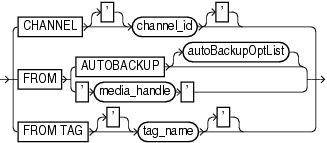

This subclause specifies options for the restoreObject clause. These parameters override the parameters with the same name at the RESTORE command level.
| CHANNELchannel_id | Specifies the case-sensitive name of a channel to use for this restore operation. If you do not specify a channel, then RESTOREuses any available channel allocated with the correct device type. |
| FROM AUTOBACKUP | Restores a control file autobackup (see Example 2-115). This option is only valid on the  RMAN begins the search on the current day or on the day specified with the  See Also: Table 2-36 for restrictions and usage notes. |
|    autoBackupOptList | Specifies parameters that control the search for a control file autobackup. |
|    'media_handle' | Specifies the name of the control file copy or backup piece containing a control file. The media_handlecan be any backup piece that contains a backup of a control file: the control file backup does not need to be an autobackup.See Also: Table 2-36 for restrictions and usage notes. |
| FROM TAGtag_name | Overrides the default selection of the most recent backups or file copy available. The tag restricts the automatic selection to backup sets or file copies created with the specified tag. If multiple backup sets or copies have a matching tag, then RMAN selects the most recent one. Tag names are not case sensitive. See Also:  |

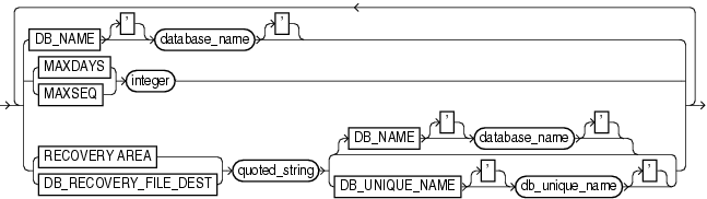

This subclause specifies parameters that control the search for a control file autobackup.
| DB_NAMEdatabase_name | Provides a DB_NAMEto be used in searching for control file autobackups. See Table 2-37 to determine when to set this parameter.The default value of the  |
| MAXDAYSinteger | Limits the search for a control file autobackup to within the specified number of days in the past. |
| MAXSEQinteger | Specifies the highest sequence number for the control file autobackup search. |
| RECOVERY AREA'pathname' | Specifies a path to the flash recovery area to search for autobackups. RECOVERY AREAandDB_RECOVERY_FILE_DESTare synonyms. See Table 2-37 to determine when to set this parameter. |
| DB_RECOVERY_FILE_DEST'pathname' | RECOVERY AREAandDB_RECOVERY_FILE_DESTare synonyms. |
|    DB_NAME   database_name | Provides a DB_NAMEto be used in searching for control file autobackups. See Table 2-37 to determine when to set this parameter.The default value of the  |
|    DB_UNIQUE_NAME   db_unique_name | Specifies the DB_UNIQUE_NAMEof the database in the specified flash recovery area that is the target of the restore operation.The default value of the  |
