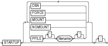

| Syntax Element | Description |
| STARTUP | If you specify only STARTUPwith no other options, then the instance starts the instance with the default server parameter file, mounts the control file, and opens the database. |
|    DBA | Restricts access to users with the RESTRICTED SESSIONprivilege. |
|    FORCE | If the database is open, then FORCEshuts down the database with aSHUTDOWNABORTstatement before re-opening it. If the database is closed, thenFORCEopens the database. |
|    MOUNT | Starts the instance, then mounts the database without opening it |
|    NOMOUNT | Starts the instance without mounting the database. If no parameter file exists, then RMAN starts the instance with a temporary parameter file. You can then run RESTORESPFILEto restore a backup server parameter file. |
|    PFILEfilename | Specifies the filename of the text-based initialization parameter file for the target database. If PFILEis not specified, then the default initialization parameter filename is used. |
