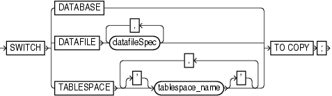

switch::=

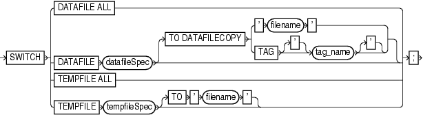

switchFile::=
(datafileSpec::=, tempfileSpec::=)
This subclause switches filenames for a database, tablespace, or datafile to the latest image copies available for the specified files. By executing this command, you avoid restoring datafiles from backups. Execute SWITCH ... TO COPY
only at the RMAN prompt.
Syntax Element | Description |
DATABASE |
Renames the datafiles and control files to use the filenames of image copies of these files. RMAN switches to the latest image copy of each database file.
After a database switch, RMAN considers the previous database files as datafile copies. |
DATAFILE datafileSpec |
Switches the specified datafiles to the latest image copies.
After the switch, the control file no longer considers the specified datafile as current. |
TABLESPACE tablespace_name |
Switches all datafiles within the specified tablespace, as with SWITCH DATAFILE ... TO COPY (see Example 2-147). |
TO COPY |
Switches the specified active database files to image copies. |
This subclause updates the names for datafiles and tempfiles for which you have issued a SET
NEWNAME
command. Use this clause only within a RUN
block.
DATAFILE ALL |
Specifies that all datafiles for which a SET NEWNAME FOR DATAFILE command has been issued in this job are switched to their new name (see Example 2-148). |
Specifies the datafile that are renaming. After the switch, the control file no longer considers the specified file as current. If you do not specify a TO option, then RMAN uses the filename specified on a prior SET NEWNAME command in the RUN block for this file as the switch target. |
TO DATAFILECOPY {' filename ' | TAG tag_name } |
Specifies the input copy file for the switch, that is, the datafile copy that you intend to rename (see Example 2-150). |
TEMPFILE ALL |
Specifies that all tempfiles for which a SET NEWNAME FOR TEMPFILE command has been issued in this job are switched to their new name. |
TEMPFILE tempfileSpec |
Specifies the tempfile that you are renaming. If you do not specify a TO option, then RMAN uses the filename specified on a prior SET NEWNAME command in the RUN block for this file as the switch target. The target database must be mounted but not open. |
TO ' filename ' |
Renames the tempfile to the specified name (see Example 2-149). The target database must be mounted but not open. |
