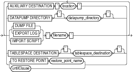

This subclause specifies optional parameters that affect the tablespace transport.
| Syntax Element | Description |
| AUXILIARY DESTINATION'location' | Specifies the location for files for the auxiliary instance. You can use  See Also: Oracle Database Backup and Recovery User's Guide for details on the interactions among the different techniques for naming the auxiliary instance files |
| DATAPUMP DIRECTORYdatapump_directory | Specifies a database directory object where Data Pump Export outputs are created (see Example 2-152). If not specified, then RMAN creates files in the location specified by TABLESPACEDESTINATION.See Also: Oracle Database Utilities for more details on Data Pump Export and database directory objects |
| DUMP FILE'filename' | Specifies where to create the Data Pump Export dump file. If not specified, the export dump file is named dmpfile.dmpand stored in the location specified by theDATAPUMP DIRECTORYclause or in the tablespace destination.Note: If a file under the name of the export dump file already in the tablespace destination, then  |
| EXPORT LOG'filename' | Specifies the location of the log generated by Data Pump Export. If omitted, the export log is named explog.logand stored in the location specified by theDATAPUMP DIRECTORYclause or in the tablespace destination. |
| IMPORT SCRIPT'filename' | Specifies the filename for the sample input script generated by RMAN for use in plugging in the transported tablespace at the destination database. If omitted, the import script is named impscript.sql. The script is stored in the tablespace destination. |
| TABLESPACE DESTINATIONtablespace_destination | Specifies the location of the datafiles for the transported tablespaces after the tablespace transport operation completes. |
| TO RESTORE POINTrestore_point_name | Specifies a restore point for tablespace restore and recovery, with the SCN at which the restore point was created as the upper, inclusive limit. Because the limit is inclusive, RMAN selects only files that can be used to restore or recover tablespaces up to and including the SCN corresponding to the restore point. |
| untilClause | Specifies a past time, SCN, or log sequence number (see Example 2-151). If specified, RMAN restores and recovers the tablespaces at the auxiliary instance to their contents at that past point in time before export. If you rename a tablespace, then you cannot use this command to create a transportable tablespace set as of a point in time before the tablespace was renamed. RMAN has no knowledge of the previous name of the tablespace. Tablespaces including undo segments as of the  |
