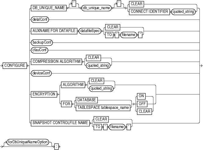

configure::=
(datafileSpec::=, backupConf::=, cfauConf::=, deviceConf::=, forDbUniqueNameOption::=)

| Syntax Element | Description |
| DB_UNIQUE_NAMEdb_unique_name{CLEAR | CONNECT IDENTIFIER'connect_string'} | Specifies the net service name for the physical standby database specified by DB_UNIQUE_NAME. TheCONNECT IDENTIFIERstring must not include the database username and password.RMAN must also be connected to the primary database as  When you run the  Note: When the target database needs to connect to other standby or primary databases, it connects as the  Suppose that you recently connected RMAN as  Note: If the database specified by  |
| delalConf | Configures an archived redo log deletion policy. |
| AUXNAME FOR DATAFILEdatafileSpecTO'filename' | Configures the auxiliary filename for the specified target datafile to 'filename'(see Example 2-44). SpecifyCLEARto unspecify the auxiliary filename.If you are performing TSPITR or using  For example, use this command during TSPITR if the datafiles are on raw disk and you must restore auxiliary datafiles to raw disk for performance reasons. Typically, you set the  When renaming files with the  See Also: Oracle Database Backup and Recovery User's Guide to learn how to perform RMAN TSPITR, and Oracle Database Backup and Recovery User's Guide to learn how to duplicate a database with RMAN |
| backupConf | Configures default backup options such as duplexing, optimization, excluding tablespaces, backup set sizes, and retention policies. |
| cfauConf | Configures control file autobackup settings. |
| COMPRESSION ALGORITHM'algorithm_name' | Specifies the algorithm that RMAN uses to create compressed backup sets. The default compression algorithm is BZIP2.The supported algorithms are  Note: The  |
| deviceConf | Configures default backup settings for devices, such as the default backup device, channel configurations for devices, default backup types for each device, and parallelism. |
| ENCRYPTION | Specifies transparent-mode encryption settings for the database or tablespaces. This configuration applies unless overridden with the  See Also: "Encryption of Backup Sets" to learn about the different modes of backup encryption, and Oracle Database Advanced Security Administrator's Guide to learn about transparent data encryption |
|    ALGORITHM   'algorithm_name' | Specifies the default algorithm to use for encryption when writing backup sets. Possible values are listed in V$RMAN_ENCRYPTION_ALGORITHMS. TheCLEARoption resets the database to the default value. |
|    FOR DATABASE   [ON | OFF | CLEAR] | Specifies whether to enable transparent encryption for the entire database. The options are as follows:
 Note: You must use the  |
|    FOR TABLESPACE   tablespace_name   [ON | OFF | CLEAR] | Specifies whether to enable transparent encryption for one or more tablespaces. Configured settings for a tablespace always override configuration set at the database level. The options are as follows:
| SNAPSHOT CONTROLFILENAME TO 'filename' | Configures the snapshot control file name and location to 'filename'. If you runCONFIGURE SNAPSHOT CONTROLFILE NAME CLEAR, then RMAN sets the snapshot control file name to its default.The default value for the snapshot control file name is platform-specific and dependent on Oracle home. For example, the default on some UNIX systems is  The snapshot control file name is valid for this database only. Assume that you configure the snapshot control file name to a nondefault value on the primary database. If you use  See Also: Oracle Database Backup and Recovery User's Guide for more information about snapshot control files |
| forDbUniqueNameOption | Creates an RMAN configuration in the recovery catalog for the database in a Data Guard environment specified by DB_UNIQUE_NAME. You can specify a single database withdb_unique_nameor useALLfor all databases in the recovery catalog that share the DBID of the target database (or DBID specified by theSETDBIDcommand).A recovery catalog is required when performing operations in a Data Guard environment. RMAN must be connected as  When you specify  Note: It is possible to run  |

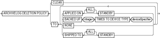

This subclause manages persistent configurations for archived redo log deletion policy.
| ARCHIVELOG DELETION POLICY | Determines when archived redo log files are eligible for deletion. The archived log deletion policy applies to all log archiving destinations, including the flash recovery area. Note that the policy does not apply to archived logs in backup sets. Only archived redo logs in the flash recovery area are automatically deleted by the database. You can execute the  In the recovery area, the database retains logs eligible for deletion as long as possible. The database deletes the oldest logs first when disk space is required. When the recovery area is under disk pressure, the database may delete archived redo logs needed by Oracle Streams. Note: The deletion policy does not apply to foreign archived redo logs, which are logs received by a logical standby database for a LogMiner session. These logs are transferred from a primary database, but unlike ordinary archived logs they have a different DBID. Foreign archived redo logs cannot be backed up or restored on a logical standby database. |
|    TO APPLIED ON   [ALL] STANDBY | Specifies that archived redo logs are eligible for deletion if both of the following conditions are met:
 Which remote destinations are considered depends on the following criteria:
 Note: It is invalid to specify the  See Also: Oracle Data Guard Concepts and Administration for details |
|    BACKED UP integer   TIMES TO DEVICE   TYPE deviceSpecifier | Specifies that archived redo logs are eligible for deletion if both of the following conditions are met:
 If you configure the deletion policy with this clause, then a  See Also:  |
|    TO NONE | Disables the archived log deletion policy. This is the default setting. Archived redo log files can be located inside or outside of the flash recovery area. Logs in any location can be deleted by manual commands. Only logs in the flash recovery area can be deleted automatically by the database. When the deletion policy is set to
 For example, suppose that archived logs have been transferred to required remote destinations. The logs are obsolete according to the recovery window retention policy, but have not been backed up. In this case, the logs are eligible for deletion. Alternatively, suppose that the logs are obsolete and have been backed up to SBT, but have not been transferred to required remote destinations. In this case, the logs are not eligible for deletion. If the deletion policy is set to  |
|    TO SHIPPED TO   [ALL] STANDBY | Specifies that archived redo logs are eligible for deletion if both of the following conditions are met:

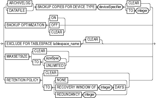

This subclause manages persistent configurations relating to the BACKUP command. One configuration is backup optimization. If you enable backup optimization, then RMAN does not back up a file to a device type if the identical file is already backed up on the device type.
Table 2-3 explains the criteria used by backup optimization to determine whether a file is identical and can potentially be skipped. The table also explains the algorithm that RMAN uses when backup optimization is enabled and it needs to determine whether to skip the backup of an identical file. If RMAN does not skip a backup, then it makes the backup exactly as specified.
Table 2-3 Backup Optimization Algorithm
| {ARCHIVELOG | DATAFILE}BACKUP COPIES FOR DEVICE TYPEdeviceSpecifierTOinteger | Specifies the number of copies of each backup set for DATAFILE(both datafiles and control files) orARCHIVELOGfiles on the specified device type (see Example 2-41). You can create from1(default) to4copies.RMAN can duplex backups to either disk or tape, but cannot duplex backups to tape and disk simultaneously. When backing up to tape, ensure that the number of copies does not exceed the number of available tape devices. Also, if  Control file autobackups are never duplexed. Also, duplexing is not permitted in the flash recovery area. If duplexing is specified in the  |
| BACKUP OPTIMIZATION[ON | OFF | CLEAR] | Toggles backup optimization ONorOFF(default). SpecifyCLEARto return optimization to its default value ofOFF.Backup optimization is enabled when all of the following conditions are met:
 Optimization prevents RMAN from backing up a file to a device type if the identical file is already backed up on the device type. RMAN does not signal an error if backup optimization causes all files to be skipped during a backup. Note that the backup retention policy has an effect on which files backup optimization skips. For two files to be identical, their content must be exactly the same, as described in Table 2-3. Note that when you create backup pieces on disk or on media managed by Oracle Secure Backup, optimization excludes undo data from the backup when the data does not belong to an active transaction. Note:  Note: You can override backup optimization with the  See Also: Oracle Database Backup and Recovery User's Guide for a description of how RMAN determines that it can skip the backup of a file |
| EXCLUDE FOR TABLESPACEtablespace_name[CLEAR] | Excludes the specified tablespace from BACKUPDATABASEcommands (see Example 2-43). Note that you cannot exclude theSYSTEMtablespace.By default, each tablespace is not excluded, that is, the exclude functionality is disabled. The exclusion is stored as an attribute of the tablespace, not the individual datafiles, so the exclusion applies to any files that are added to this tablespace in the future. If you run  You can still back up an excluded tablespace by explicitly specifying it in a  |
| MAXSETSIZE | Specifies the maximum size of each backup set created on a channel. Use the CLEARoption to returnMAXSETSIZEto the default value ofUNLIMITED.Note: This option is ignored by  |
|    TOsizeSpec | Specifies the maximum size of each backup set as integergigabytes, kilobytes, or megabytes. |
|    TO UNLIMITED | Specifies no size limit for backup sets. |
| RETENTION POLICY | Specifies a persistent, ongoing policy for backup sets and copies that RMAN marks as obsolete, that is, not needed and eligible for deletion. As time passes, RMAN marks backup sets and copies as obsolete according to the criteria specified in the retention policy. RMAN automatically deletes obsolete backup sets and copies in the flash recovery area when space is needed. RMAN does not automatically delete obsolete files outside the flash recovery area: you must manually execute  For backups, the basic unit of the retention policy is a backup set (not a backup piece) or image copy. For example,  Note: Use the  |
|    TO NONE | Disables the retention policy feature. RMAN does not consider any backup sets or copies as obsolete. |
|    TO RECOVERY WINDOW   OF integer DAYS | Specifies a time window in which RMAN should be able to recover the database. The window stretches from the current time ( Note: The  |
|    TO REDUNDANCYinteger | Specifies that RMAN should retain integerfull or level 0 backups of each datafile and control file. The default retention policy setting isREDUNDANCY 1.If more than  The following scenario illustrates how redundancy works in an incremental backup strategy. Assume that the redundancy level is 1. You run a level 0 database backup at noon Monday, a level 1 cumulative backup at noon on Tuesday and Wednesday, and a level 0 backup at noon on Thursday. Immediately after each daily backup you run a  Note: The  |

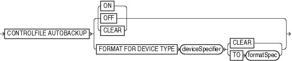

This subclause creates persistent configurations relating to control file autobackups.
| CONTROLFILE AUTOBACKUP | Controls the control file autobackup feature. Note: You should enable control file autobackup feature when using RMAN without a recovery catalog. |
|    ON | Specifies that RMAN should perform a control file autobackup in the following circumstances:
 The first channel allocated during the backup or copy job creates the autobackup and places it into its own backup set; for post-structural autobackups, the default disk channel makes the backup. RMAN writes the control file and server parameter file to the same backup piece. After the control file autobackup completes, the database writes a message containing the complete path of the backup piece and the device type to the alert log. The default location for the autobackup on disk is the flash recovery area (if configured) or a platform-specific location (if not configured). RMAN automatically backs up the current control file using the default format of  You cannot configure RMAN to write the autobackup to multiple locations. To create multiple control file backups, you can make the last command in your backup job a  Note: The
 You can configure the autobackup format even when  |
|    OFF | Disables the autobackup feature (default). Any  |
|    CLEAR | Returns this configuration to its default setting of OFF. |
|    FORMAT FOR   DEVICE TYPE   deviceSpecifier   TO formatSpec | Configures the default location and filename format for the control file autobackup on the specified device type (see Example 2-45). By default, the format is  If a flash recovery area is enabled, and if the format is the default  The string  The  CONFIGURE CONTROLFILE AUTOBACKUP FOR DEVICE TYPE DISK TO '+dgroup1'; See Also:  |

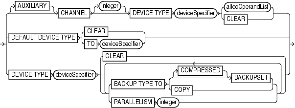

This subclause creates persistent configurations relating to channels and devices.
RMAN determines the names for configured channels. RMAN uses the following convention: ORA_devicetype_n, where devicetype refers to the user device type (such as DISK or sbt_tape) and n refers to the channel number. Channel names beginning with the ORA_ prefix are reserved by RMAN for its own use. You cannot manually allocate a channel with a name that begins with ORA_.
Thesbt and sbt_tape device types are synonymous, but RMAN output always displays sbt_tape whether the input is sbt or sbt_tape.RMAN names the first DISK channel ORA_DISK_1, the second ORA_DISK_2, and so on. RMAN names the first sbt channel ORA_SBT_TAPE_1, the second ORA_SBT_TAPE_2, and so on. When you parallelize channels, RMAN always allocates channels in numeric order, starting with 1 and ending with the parallelism setting (CONFIGURE DEVICE TYPE ... PARALLELISM n).
To run BACKUP or RESTORE jobs on specific configured channels, use the system-generated channel names. If you specify channel numbers in the CONFIGURE CHANNEL command (see the deviceConf clause), then RMAN uses the same numbers in the system-generated channel names.
Automatic channel allocation also applies to maintenance commands. If RMAN allocates an automatic maintenance channel, then it uses the same naming convention as any other automatically allocated channel.
Configured Channels in an Oracle RAC Environment
As long as the SYSDBA password for all Oracle RAC instances is the same, then you never need to put passwords in the CONNECT option of the ALLOCATE CHANNEL or CONFIGURE command. If you use a connect string of the form user@database, then RMAN automatically uses the same password that was used for the TARGET connection when the RMAN session was started (see Example 2-43).
| [AUXILIARY] CHANNEL [integer]DEVICE TYPEdeviceSpecifier | Specifies the standard or AUXILIARYchannel that you are configuring or clearing, as well as the device type of the channel.Note: Channels allocated with  Either configure a generic channel or specify a channel number, where  If  You must specify at least one channel option. For example, you cannot issue a command such as  For generic channels of a specified device type, a new command erases previous settings for this device type. Assume that you run these commands: CONFIGURE CHANNEL DEVICE TYPE sbt MAXPIECESIZE 1G; CONFIGURE CHANNEL DEVICE TYPE sbt FORMAT 'bkup_%U'; The second command erases the  Note: RMAN does not simultaneously allocate automatic channels for multiple device types in the  See Also: Oracle Database Backup and Recovery User's Guide to learn how configure automatic channels specified by channel number |
|    allocOperandList | Specifies control options for the configured channel. If you configure channels by using the nondefault  Note that the  CONFIGURE CHANNEL DEVICE TYPE DISK FORMAT '+dgroup1'; See Also:  |
|    CLEAR | Clears the specified channel. For example, CONFIGURE CHANNEL 1 DEVICE TYPE DISK CLEARreturns only channel 1 to its default, whereasCONFIGURE CHANNEL DEVICE TYPE DISK CLEARreturns the generic disk channel to its default. Note that you cannot specify any other channel options (for example,PARMS) when you specifyCLEAR. |
| DEFAULT DEVICE TYPE TOdeviceSpecifier | Specifies the default device type for automatic channels. By default, DISKis the default device type.CLEARreturns the default device type toDISK.By default, the  The  |
| DEVICE TYPEdeviceSpecifier | Specifies the device type (disk or sbt) to which to apply the settings specified in this CONFIGUREcommand. TheCLEARoption resets backup type and parallelism settings for this device to their defaults.If you run the  CONFIGURE DEVICE TYPE sbt PARALLELISM 1; BACKUP DEVICE TYPE sbt DATABASE; In effect, RMAN does the following when executing this backup:
RUN
  ALLOCATE CHANNEL ORA_SBT_TAPE_1 DEVICE TYPE sbt;
  BACKUP DATABASE;
|    BACKUP TYPE TO   [[COMPRESSED]   BACKUPSET | COPY] | Configures the default backup type for disk or tape backups. For SBT devices the COPYoption is not supported. The default for disk isBACKUPSET.If  The default location for disk backups is the flash recovery area, if one is configured; otherwise, RMAN stores backups in a platform-specific location. The default format for backup filenames is  |
|    PARALLELISMinteger | Configures the number of automatic channels of the specified device type allocated for RMAN jobs. By default, PARALLELISMis set to1.Note: The  Suppose you set  Note: If you configure  To change the parallelism for a device type to  CONFIGURE DEVICE TYPE sbt PARALLELISM 3; CONFIGURE DEVICE TYPE sbt PARALLELISM 2; |

The following SHOW command displays the persistent device type configurations for the database whose unique name is dgprod3:
RMAN> SHOW DEVICE TYPE FOR DB_UNIQUE_NAME dgprod3; RMAN configuration parameters for database with db_unique_name DGPROD3 are: CONFIGURE DEVICE TYPE 'SBT_TAPE' PARALLELISM 2 BACKUP TYPE TO BACKUPSET; CONFIGURE DEVICE TYPE DISK PARALLELISM 1 BACKUP TYPE TO BACKUPSET; # default
The following SHOW command displays the persistent configurations for all databases known to the recovery catalog whose DBID is 3257174182 (the value specified by the preceding SET DBID command):
SHOW ALL FOR DB_UNIQUE_NAME ALL;
Example 2-47 Optimizing Backups
This scenario illustrates the backup optimization behavior described in Table 2-3. Assume that backup optimization is disabled. At 9 a.m., you back up three copies of all existing archived logs to tape. Note that the BACKUP_TAPE_IO_SLAVES initialization parameter must be true when duplexing backups to tape.
BACKUP DEVICE TYPE sbt COPIES 3 ARCHIVELOG ALL;
At 11 a.m., you enable backup optimization:
CONFIGURE BACKUP OPTIMIZATION ON;
At noon, you run the following archived redo log backup:
BACKUP DEVICE TYPE sbt COPIES 2 ARCHIVELOG ALL; Starting backup at 19-JAN-07 current log archived using channel ORA_SBT_TAPE_1 skipping archived log file /d1/db1r_605ab325_1_34_612112605.arc; already backed up 3 time(s) skipping archived log file /d1/db1r_605ab325_1_35_612112605.arc; already backed up 3 time(s) skipping archived log file /d1/db1r_605ab325_1_36_612112605.arc; already backed up 3 time(s) skipping archived log file /d1/db1r_605ab325_1_37_612112605.arc; already backed up 3 time(s) skipping archived log file /d1/db1r_605ab325_1_38_612112605.arc; already backed up 3 time(s) skipping archived log file /d1/db1r_605ab325_1_39_612112605.arc; already backed up 3 time(s) channel ORA_SBT_TAPE_1: starting archived log backup set channel ORA_SBT_TAPE_1: specifying archived log(s) in backup set input archived log thread=1 sequence=40 RECID=170 STAMP=612270506 channel ORA_SBT_TAPE_1: starting piece 1 at 19-JAN-07 channel ORA_SBT_TAPE_1: finished piece 1 at 19-JAN-07 with 2 copies and tag TAG20070119T110827 piece handle=2hi7t0db_1_1 comment=API Version 2.0,MMS Version 10.1.0.0 piece handle=2hi7t0db_1_2 comment=API Version 2.0,MMS Version 10.1.0.0
In this case, the BACKUP ... COPIES setting overrides the CONFIGURE ... COPIES setting, so RMAN sets n=2. RMAN skips the backup of a log only if at least two copies of the log exist on the sbt device. Because three copies of each log exist on sbt of all the logs generated on or before 9 a.m., RMAN skips the backups of these logs. However, RMAN backs up two copies of all logs generated after 9 a.m. because these logs have not yet been backed up to tape.
