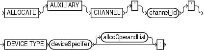

(deviceSpecifier::=, allocOperandList::=)
Syntax Element | Description |
AUXILIARY |
Specifies a connection between RMAN and an auxiliary database instance.
An auxiliary instance is used when executing the See Also: |
CHANNEL channel_id |
Specifies a connection between RMAN and the target database instance. The channel_id is the case-sensitive name of the channel. The database uses the channel_id to report I/O errors.
Each connection initiates an database server session on the target or auxiliary instance: this session performs the work of backing up, restoring, or recovering RMAN backups. You cannot make a connection to a shared server session. Whether Each channel operates on one backup set or image copy at a time. RMAN automatically releases the channel at the end of the job. Note: You cannot prefix |
DEVICE TYPE deviceSpecifier |
Specifies the type of storage for a backup. Query the V$BACKUP_DEVICE view for information about available device types and names.
Note: When you specify See Also: |
allocOperandList |
Specifies control options for the allocated channel. Note that the channel parameters for sequential I/O devices are platform-specific (see Example 2-6).
See Also: |
