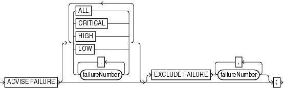

advise::=
| Syntax Element | Description |
| ADVISE FAILURE | Displays information for all CRITICALandHIGHpriority failures recorded in the automatic diagnostic repository.You can only use  Note: If a new failure has been recorded in the diagnostic repository since the last  |
|    ALL | Lists options that repair all open failures together. |
|    CRITICAL | Lists options that repair only critical failures. |
|    HIGH | Lists options that repair only failures with HIGHpriority. |
|    LOW | Lists options that repair only failures with LOWpriority. |
|    failureNumber | Lists options that repair only the specified failures. |
|    EXCLUDE FAILURE   failureNumber | Excludes the specified failures from the list. |
