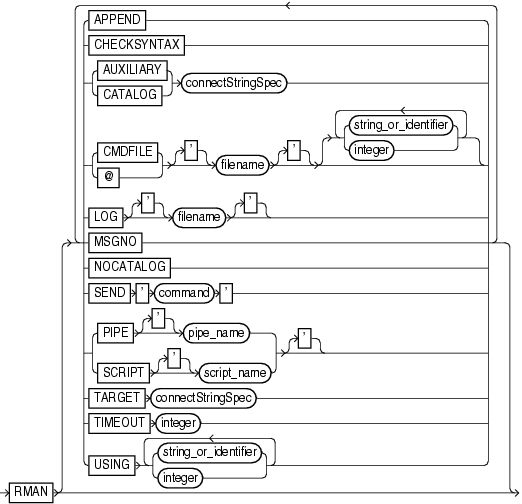

cmdLine::=
| Syntax Element | Description |
| APPEND | Causes new output to be appended to the end of the message log file. If you do not specify this parameter, and if a file with the same name as the message log file already exists, then RMAN overwrites it. |
| CHECKSYNTAX | Causes RMAN to start in a mode in which commands entered are checked for syntax errors, but no other processing is performed (see Example 2-129). If used with a CMDFILEor@argument, then the RMAN client starts, checks all commands in the file, then exits. If used without specifying a command file, then RMAN prompts the user for input and parses each command until the user exits the RMAN client.RMAN reports an  |
| AUXILIARYconnectStringSpec | Specifies a connect string to an auxiliary database, for example, AUXILIARYSYS@dupdb.See Also:  |
| CATALOGconnectStringSpec | Specifies a connect string to the database containing the recovery catalog, for example, CATALOGcatowner@inst2.See Also:  |
| CMDFILEfilename | Parses and compiles all RMAN commands in a file and then sequentially executes each command in the file. RMAN exits if it encounters a syntax error during the parse phase or if it encounters a run-time error during the execution phase. If no errors are found, then RMAN exits after the job completes. If the first character of the filename is alphabetic, then you can omit the quotes around the filename. The contents of the command file should be identical to commands entered at the RMAN prompt. Note: If you run a command file at the RMAN prompt rather than as an option on the operating system command line, then RMAN does not run the file as a single job. RMAN reads each line sequentially and executes it, only exiting when it reaches the last line of the script. |
| @filename | Equivalent to CMDFILE. |
|    {string_or_identifier   |integer} | Equivalent to options specified after USINGsyntax. |
| LOGfilename | Specifies the file where RMAN records its output, that is, the commands that were processed and their results. RMAN displays command input at the prompt but does not display command output, which is written to the log file. By default RMAN writes its message log file to standard output. RMAN output is also stored in the  The  Note: The easiest way to send RMAN output both to a log file and to standard output is to use the Linux  % rman | tee rman.log |
| MSGNO | Causes RMAN to print message numbers, that is, RMAN-xxxx, for the output of all commands. By default, RMAN does not print theRMAN-xxxxprefix. |
| NOCATALOG | Indicates that you are using RMAN without a recovery catalog. |
| SEND'command' | Sends a vendor-specific command string to all allocated channels. See Also: Your media management documentation to determine whether this feature is supported, and  |
| PIPEpipe_name | Invokes the RMAN pipe interface. RMAN uses two public pipes: one for receiving commands and the other for sending output. The names of the pipes are derived from the value of the PIPEparameter. For example, you can invoke the RMAN pipe interface with the following options:PIPE rpi TARGET /.RMAN opens the following pipes in the target database: All messages on both the input and output pipes are of type  See Also: Oracle Database Backup and Recovery User's Guide to learn how to pass commands to RMAN through a pipe |
| SCRIPTscript_name | Specifies the name of a stored script. After connecting to a target database and recovery catalog (which must be specified with the  The single quotes around the stored script name are required when the script name either begins with a number or is an RMAN reserved word (see "RMAN Reserved Words"). You should avoid creating script names that begin with a number or that match RMAN reserved words. See Also:  |
| TARGETconnectStringSpec | Specifies a connect string to the target database, for example, TARGET /.See Also:  |
| TIMEOUTinteger | Causes RMAN to exit automatically if it does not receive input from an input pipe within integerseconds. ThePIPEparameter must be specified when usingTIMEOUT.See Also: Oracle Database Backup and Recovery User's Guide to learn how to pass commands to RMAN through a pipe |
| USING{string_or_identifier|integer} | Specifies one or more values for use in substitution variables in a command file. As in SQL*Plus, &1indicates where to place the first value,&2indicate where to place the second value, and so on. Example 2-128 illustrates how to pass values specified in aUSINGclause to an RMAN command file.The substitution variable syntax is  See Also:  |
