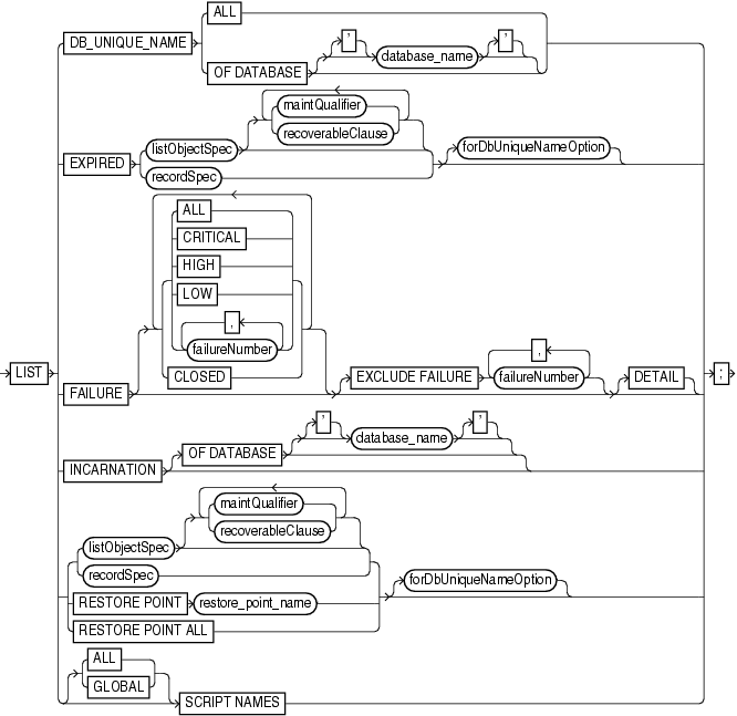

Use the LIST command to display backups and information about other objects recorded in the RMAN repository.
See Also:
Oracle Database Backup and Recovery User's Guide to learn how to make lists and reports, andRMANExecute LIST only at the RMAN prompt. Either of the following conditions must be met:
RMAN must be connected to a target database. If RMAN is not connected to a recovery catalog, and if you are not executing the LIST FAILURE command, then the target database must be mounted or open. If RMAN is connected to a recovery catalog, then the target database instance must be started.
RMAN must be connected to a recovery catalog and SET DBID must have been run.
With the exception of LIST FAILURE, the LIST command displays the backups and copies against which you can run CROSSCHECK and DELETE commands. The LIST FAILURE command displays failures against which you can run the ADVISE FAILURE and REPAIR FAILURE commands.
"RMAN Backups in a Data Guard Environment" explains how RMAN handles backups in a Data Guard environment. In general, RMAN considers tape backups created on one database in the environment as accessible to all databases in the environment, whereas disk backups are accessible only to the database that created them. In a Data Guard environment, LIST displays those files that are accessible to the connected target database.
RMAN prints the LIST output to either standard output or the message log, but not to both at the same time.
list::=
(listObjectSpec::=, recordSpec::=, maintQualifier::=, forDbUniqueNameOption::=, untilClause::=)

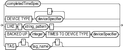

(completedTimeSpec::=, deviceSpecifier::=)
(listObjList::=, listBackupOption::=, archivelogRecordSpecifier::=, foreignlogRecordSpecifier::=)
| Syntax Element | Description |
| DB_UNIQUE_NAME | Lists the DB_UNIQUE_NAMEof one or more databases registered in the recovery catalog.RMAN must be connected to a recovery catalog. RMAN must also be connected to a mounted or open target database, or you must identify the target database with the  See Also: Table 2-27 for a description of the output |
|    ALL | Lists the DB_UNIQUE_NAMEof every database registered in the RMAN repository. |
|    OF DATABASE   database_name | Lists the DB_UNIQUE_NAMEof every database with the specifiedDB_NAME. |
| EXPIRED | Displays backup sets, proxy copies, and image copies marked in the repository as EXPIRED, which means they were not found. See Table 2-8, "List of Backup Sets (for datafile backup sets)" for a description of the output.To ensure that  |
|    listObjectSpec | Specifies the type of expired object or objects that you are listing. See Also:  |
|    maintQualifier | Restricts the range of the listing. See Also:  |
|    recordSpec | Specifies the expired object or objects that you are listing. See Also:  |
|    forDbUniqueNameOption | Lists the expired files in listObjectSpecorrecordSpecthat are exclusively associated with the specifiedDB_UNIQUE_NAMEin a Data Guard environment.You can specify a database with  RMAN must be connected to a recovery catalog. RMAN must also be connected to a mounted or open target database, or you must have run the  See Also:  |
| FAILURE | Lists failures recorded by the Data Recovery Advisor. The database to which RMAN is connected must be a single-instance database and must not be a physical standby database. See Also: "Oracle RAC and Data Recovery Advisor" The Data Recovery Advisor can detect and repair a wide variety of physical problems that cause data loss and corruption. Physical corruptions are typically caused by faulty I/O subsystems or human error. The Data Recovery Advisor may not detect or handle some types of logical corruptions. Corruptions of this type require help from Oracle Support Services. In the context of Data Recovery Advisor, a failure is a persistent data corruption that is mapped to a set of repair actions. Data failures are detected by checks, which are diagnostic procedures that assess the health of the database or its components. Each check can diagnose one or more failures, which are mapped to a set of repairs. The typical use case is to run  If no options are specified on  The  See Also: Table 2-26 for an explanation of the column headings of the  |
|    ALL | Lists failures with all priorities and status OPEN. |
|    CRITICAL | Lists only critical failures with status OPEN. |
|    HIGH | Lists only failures with HIGHpriority and statusOPEN. |
|    LOW | Lists only failures with LOWpriority with statusOPEN. |
|    failureNumber | Specifies the failures by failure number. |
|    CLOSED | Lists only closed failures. |
|    EXCLUDE FAILURE   failureNumber | Excludes the specified failures from the list. |
|    DETAIL | Lists failures by expanding the consolidated failure. For example, if multiple block corruptions existed in a file, then specifying the DETAILoption would list each of the block corruptions. |
| INCARNATION | Displays information about the incarnations of a database. Whenever you open a database with the  The  See Also: Table 2-23 for an explanation of the column headings of the  |
|    OF DATABASE   database_name | Specifies the name of the database. If you do not specify the OF DATABASEoption, thenLISTdisplays all databases registered in the recovery catalog. |
|    recoverableClause | Restricts the list to datafile backups or copies whose status in the repository is AVAILABLEand which can be used for restore and recovery in the current incarnation of the target database.See Also:  |
| recordSpec | Specifies the object or objects that you are listing. See Also:  |
|    untilClause | Specifies an end time, SCN, or log sequence number. See Also:  |
| RESTORE POINT | Displays restore points known to the RMAN repository. See Also: Table 2-25 for an explanation of the column headings of the  |
|    restore_point_name | Displays the specified restore point. |
|    ALL | Displays all restore points known to the RMAN repository. |
|    forDbUniqueNameOption | Lists the backups and restore points that are exclusively associated with the specified DB_UNIQUE_NAMEin a Data Guard environment.You can specify a database with  RMAN must be connected to a recovery catalog. RMAN must also be connected to a mounted or open target database. See Also:  |
| ALL SCRIPT NAMES | RMAN lists all global and local scripts defined for all databases in the connected recovery catalog, along with any descriptive comments. You must be connected to a recovery catalog, but you do not need to be connected to a target database. |
| GLOBAL SCRIPT NAMES | RMAN lists only global scripts defined in the connected recovery catalog, along with any descriptive comments. You must be connected to a recovery catalog, but you do not need to be connected to a target database. |
| SCRIPT NAMES | Lists local and global scripts that can be executed on the current target database. You must be connected to a target database and a recovery catalog to use this form of the command. See Also: Table 2-24 for a description of the output and Example 2-107 for an illustration |

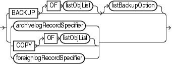

This subclause specifies the type of object or objects that you are listing.
| BACKUP | Displays information about backup sets (including detail on backup pieces) and proxy copies. See Also: Table 2-8 for a description of  |
|    OFlistObjList | Restricts the list of objects operated on to the object type specified in the listObjListclause. If you do not specify an object, thenLISTdefaults toOF DATABASE CONTROLFILE ARCHIVELOG ALL.Note: The  See Also:  |
|    listBackupOption | Specifies whether to list summary information about backups or detailed information. |
| archivelogRecordSpecifier | Displays information about a range of archived redo logs. |
| COPY | Displays only information about datafile copies, archived redo logs, and image copies of archived redo logs. By default, LIST COPYdisplays copies of all database files and archived redo logs. Both usable and unusable image copies are included in the output, even those that cannot be restored or are expired or unavailable.See Also: Table 2-20 and Table 2-22 for an explanation of the column headings of the  |
|    OFlistObjList | Restricts the list of objects operated on to the object type specified in the listObjListclause.See Also:  |
| foreignlogRecordSpecifier | Displays information about a range of foreign archived redo logs. |
