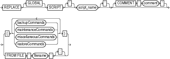

Use the REPLACE SCRIPT command to replace an existing script stored in the recovery catalog. If the script does not exist, then REPLACE SCRIPT creates it.
See Also:
CREATE SCRIPT to learn how to create stored scriptsExecute REPLACE SCRIPT only at the RMAN prompt. RMAN must be connected to a target database and a recovery catalog. The recovery catalog database must be open.
If you are replacing a local script, then you must be connected to the target database that you connected to when you created the script.
Substitution Variables in Stored Scripts
RMAN supports the use of substitution variables in a stored script. &1 indicates where to place the first value, &2 indicate where to place the second value, and so on. Special characters must be quoted.
The substitution variable syntax is &integer followed by an optional period, for example, &1.3. The optional period is part of the variable and replaced with the value, thus enabling the substitution text to be immediately followed by another integer. For example, if you pass the value mybackup to a command file that contains the substitution variable &1.3, then the result of the substitution is mybackup3. Note that to create the result mybackup.3, you would use the syntax &1..3.
When you create a stored script with substitution variables, you must provide example values at create time. You can provide these values with the USING clause when starting RMAN (see RMAN) or enter them when prompted (see Example 2-60).
(backupCommands::=, maintenanceCommands::=, miscellaneousCommands::=, restoreCommands::=)
| Syntax Element | Description |
| GLOBAL | Identifies the script as global. Note: A virtual private catalog has read-only access to global scripts. Creating or updating global scripts must be done while RMAN is connected to the base recovery catalog. See Also: "Usage Notes" for an explanation of the difference between global and local scripts |
| SCRIPT script_name | Identifies the local or global script being replaced. |
|    COMMENT'comment' | Associates an explanatory comment with the stored script in the recovery catalog. The comment is shown in the output of LISTSCRIPT NAMES. |
| backupCommandsmaintenanceCommandsrestoreCommandsmiscellaneousCommands | Specifies commands to include in the stored script. The commands allowable within the brackets of the REPLACE SCRIPT'script_name'{...}command are the same commands supported within aRUNblock. Any command that is valid within aRUNcommand is permitted in the stored script. The following commands are not permitted within stored scripts:RUN,@ (at sign), and@@ (double at sign). |
| FROM FILE'filename' | Reads the sequence of commands to define the script from the specified file. The file should look like the body of a valid stored script. The first line of the file must be a left brace ( |
