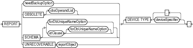

report::=
(needBackupOption::=, atClause::=, reportObject::=, obsOperandList::=, deviceSpecifier::=)

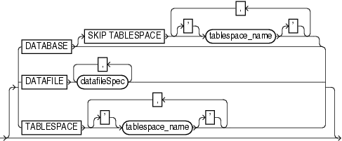

reportObject::=

This clause specifies the type of report.
| Syntax Element | Description |
| needBackupOption | Lists files that require backups. See Also:  |
| OBSOLETEobsOperandList | Lists full backups, datafile copies, and archived redo logs recorded in the RMAN repository that can be deleted because they are no longer needed. See Table 2-33 for description of output. The command works in two steps:
 The subclause  Note: A backup made with the  |
| SCHEMA | Lists the names of all datafiles (permanent and temporary) and tablespaces for the target database at the specified point in time. See Table 2-28 for description of output. For  |
|    forDbUniqueNameOption | Reports the names of all datafiles and tablespaces for the database specified by its DB_UNIQUE_NAME.You can specify a database with  RMAN must be connected to a recovery catalog. RMAN must be connected to a target database or  See Also:  |
|    atClause | Specifies an SCN, log sequence number, or time. |
| UNRECOVERABLEreportObject | Lists all unrecoverable datafiles. See Table 2-34 for description of output. A datafile is considered unrecoverable if an unrecoverable operation has been performed against an object residing in the datafile since the last backup of the datafile. In an unrecoverable operation, redo is not generated. Examples are direct load of table data and updates with the  Note: The nonexistence of any backup of a datafile is not sufficient reason to consider it unrecoverable. Such datafiles can be recovered through the use of the  |
|    DEVICE TYPE   deviceSpecifier | Specifies the type of storage device. RMAN only considers backups and copies available on the specified device for its report. |

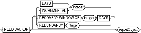

This clause reports only on files that need backups.
| NEED BACKUP | Lists all datafiles in the specified reportObjectthat require a new backup.The report assumes that you will restore the most recent backup. If you do not specify any option, then RMAN uses the current retention policy configuration. If the retention policy is disabled ( |
|    DAYS integer | Lists all datafiles requiring more than the specified number of days' worth of archived redo log files for complete recovery. For example, REPORT NEED BACKUP DAYS 7 DATABASEshows the datafiles whose recovery requires more than seven days' worth of archived redo logs. See Table 2-29 for description of output.If the target database control file is mounted and current, then RMAN makes the following optimizations to this report:
|    INCREMENTAL integer | Specifies a threshold number of incremental backups required for recovery (see Example 2-109). If complete recovery of a datafile requires more than integerincremental backups, then the datafile requires a new full backup. See Table 2-30 for description of output.Note: Files for which no backups exist will not appear in this list: issue the  |
|    RECOVERY WINDOW   OFintegerDAYS | Reports datafiles for which there are not sufficient backups to satisfy a recovery window-based retention policy for the specified number of days, that is, datafiles without sufficient backups for point-in-time recovery to any point back to the time SYSDATE -integer. See Table 2-31 for description of output. |
|    REDUNDANCYinteger | Specifies the minimum number of backups or copies that must exist for a datafile to be considered not in need of a backup. In other words, a datafile needs a backup if there are fewer than integerbackups or copies of this file. For example,REDUNDANCY 2means that if there are fewer than two copies or backups of a datafile, then it needs a new backup. See Table 2-32 for description of output. |
| reportObject | Specifies the object for which you are generating the report. |
This subclause specifies the datafiles to be included in the report. The report can include the entire database (optionally skipping certain tablespaces), a list of tablespaces, or a list of datafiles. Note that RMAN includes objects from prior incarnations.
| DATABASE | Lists backups or datafile copies of all files in the database. Note: Specify  |
| DATAFILE datafileSpec | Lists the specified datafiles. RMAN reports on backups or datafile copies that contain at least one of the specified datafiles. |
| TABLESPACEtablespace_name | Lists datafiles in the specified tablespace. RMAN reports on backups or datafile copies that include at least one datafile from a specified tablespace. |
