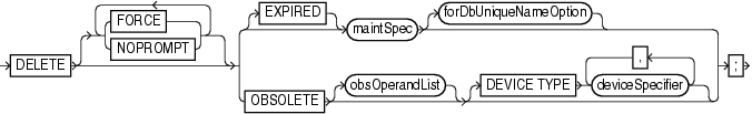

(maintSpec::=, obsOperandList::=, deviceSpecifier::=)

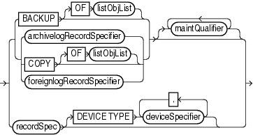

maintSpec::=
(listObjList::=, archivelogRecordSpecifier::=, maintQualifier::=, deviceSpecifier::=, recordSpec::=)
| Syntax Element | Description |
FORCE |
Deletes specified files—whether or not they exist on the media—and removes repository records (see Example 2-66).
RMAN ignores any I/O errors for the deleted objects. RMAN also ignores any |
NOPROMPT |
Deletes specified files without first listing the files or prompting for confirmation. The DELETE NOPROMPT command displays each item as it is deleted. |
EXPIRED |
Removes only files whose status in the repository is EXPIRED (see Example 2-63). RMAN marks backups and copies as expired when you run a CROSSCHECK command and the files are absent or inaccessible. To determine which files are expired, run a LIST EXPIRED command.
If for some reason a backup marked |
maintSpec |
Deletes backups and copies.
You can set rules for the deletion with the Note: See Also: |
forDbUniqueNameOption |
Deletes the backups and copies in maintSpec that are exclusively associated with the specified DB_UNIQUE_NAME in a Data Guard environment.
Note: The If RMAN successfully deletes tape backups associated with the specified Note: You cannot use See Also: |
OBSOLETE |
Deletes datafile backups and copies recorded in the RMAN repository that are obsolete, that is, no longer needed (see Example 2-64). RMAN also deletes obsolete archived redo log files and log backups.
RMAN determines which backups and copies of datafiles are no longer needed, which in turn determines when logs (and backups of logs) are no longer needed. RMAN considers the creation of a datafile as a backup when deciding which logs to keep. RMAN first uses the options specified with Note: Note: If you make a backup with the |
obsOperandList |
Specifies the criteria for determining which backups and copies are obsolete.
See Also: |
DEVICE TYPE deviceSpecifier |
Restricts the deletion to obsolete backups and copies created on the specified device type only.
See Also: |
