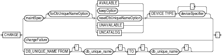

change::=
(maintSpec::=, forDbUniqueNameOption::=, keepOption::=, deviceSpecifier::=)
maintSpec::=
(listObjList::=, archivelogRecordSpecifier::=, maintQualifier::=, recordSpec::=, deviceSpecifier::=)
This clause enables you to change the status of RMAN repository records. To obtain the primary keys of RMAN repository records whose status you want to change, run a LIST command or query the recovery catalog views.
| Syntax Element | Description |
| maintSpec | Specifies which files you want to CHANGE.See Also:  |
|    forDbUniqueNameOption | Changes the metadata for objects that are exclusively associated with the specified DB_UNIQUE_NAMEin a Data Guard environment.See Also:  |
|    AVAILABLE | Changes the status of a backup or copy to AVAILABLEin the repository. RMAN searches for the file and verifies that it exists.This feature is useful when a previously unavailable file is made available again. You can also use this option to alter the repository status of backups and copies from prior incarnations. This is the only  If you execute  Note: You can view the status of backups in the  Note:  |
|    keepOption | Changes the exemption status of a backup or copy in relation to the configured retention policy. For example, specify CHANGE ... NOKEEPto remove theKEEPattributes for a backup, making it subject to the backup retention policy.The  See Also:  |
|    resetDbUniqueNameOption | Associates the files in maintSpecwith a different database in a Data Guard environment.See Also:  |
|    UNAVAILABLE | Changes the status of a backup or copy to UNAVAILABLEin the repository (see Example 2-34). View the status in theLISToutput or recovery catalog views.This option is useful when a file cannot be found or has migrated offsite. RMAN does not use a file that is marked
 Note: If you execute  |
|    UNCATALOG | Removes references to a datafile copy, backup piece, or archived redo log from the recovery catalog, and updates records in the target control file to status DELETED(see Example 2-35). Note that theCHANGE ... UNCATALOGcommand does not touch physical backups and copies. Use this command to notify RMAN when a file is deleted by some means other than aDELETEcommand.If you execute  Caution: If you resynchronize from a backup control file, or upgrade the recovery catalog, then records previously removed from the RMAN repository with  |
|    DEVICE TYPE   deviceSpecifier | Executes the CHANGEfor the specified device type only (seedeviceSpecifier). This option is valid only if you have configured automatic channels and have not manually allocated channels. For example, if you runCHANGE UNCATALOG ... DEVICE TYPE DISK, then RMAN only uncatalogs files on disk. |

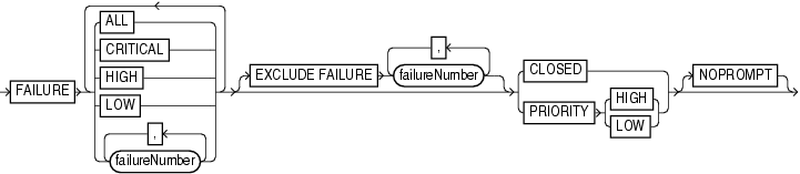

| changeFailure | Specifies changes for failures recorded by the Data Recovery Advisor. |
| DB_UNIQUE_NAMEFROMdb_unique_nameTOdb_unique_name | Updates the metadata in the recovery catalog to reflect a new DB_UNIQUE_NAMEfor a database in a Data Guard environment. The first value specifies the oldDB_UNIQUE_NAMEfor the database currently recorded in the recovery catalog, whereas the second specifies the newDB_UNIQUE_NAME.RMAN must be connected to a recovery catalog and a mounted target database. The target database should not have the  Typically, you use this command after you have already changed the  Assume that you have changed the
 In the scenario in which only the old name is listed, execute  In the scenario in which both the old and new names are listed, RMAN automatically executes the following commands when you run
 Thus, RMAN changes the association of all backups for the  |

This clause enables you to change the status of failures. Use the LIST FAILURE command to show the list of failures.

Example 2-37 Changing the Status of a Failure
In the following example, the LIST FAILURE command shows that a datafile has corrupt blocks. The failure number is 5 and has a priority of HIGH. You decide to change the priority of this failure to low.
RMAN> LIST FAILURE; List of Database Failures Failure ID Priority Status Time Detected Summary ---------- -------- --------- ------------- ------- 5 HIGH OPEN 11-DEC-06 datafile 8 contains corrupt blocks RMAN> CHANGE FAILURE 5 PRIORITY LOW; List of Database Failures Failure ID Priority Status Time Detected Summary ---------- -------- --------- ------------- ------- 5 HIGH OPEN 11-DEC-06 datafile 8 contains corrupt blocks Do you really want to change the above failures (enter YES or NO)? YES changed 1 failures to LOW priority
