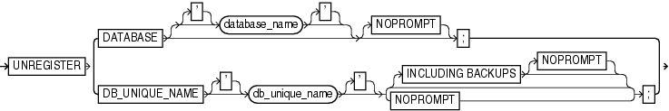

Use the UNREGISTER command to remove the RMAN metadata for one or more registered databases from the recovery catalog.
See Also:
DROP DATABASE to learn how to delete a database and unregister it with one commandExecute this command only at the RMAN prompt. RMAN must be connected to a recovery catalog. The database that you want to unregister must be currently registered in this catalog.
| Syntax Element | Description |
DATABASE |
Specifies a primary database to be unregistered. RMAN unregisters the primary database as well as any of its associated standby databases (see Example 2-153).
 If
   database_name |
Specifies the name of the primary database that you are unregistering.
 This database name must be unique in the recovery catalog. Because the database name is unique, RMAN does not need to be connected to a target database or use the   |
DB_UNIQUE_NAMEdb_unique_name |
Specifies the removal of all metadata except backup metadata for the Data Guard database specified by db_unique_name.
The specified database can be either a primary or standby database, although typically you use this clause to unregister a standby database (see Example 2-155). You can use this clause only when RMAN is connected to a mounted or open target database or the  The backups of a database have the   |
   INCLUDING BACKUPS |
Specifies that backup metadata should also be removed for the database specified by db_unique_name.
Note: Physical backups will not be deleted by the   |
   NOPROMPT |
Does not prompt for confirmation before unregistering the database. |
