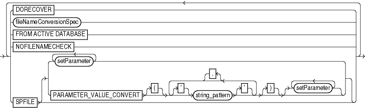

This subclause specifies options that only apply when creating a standby database. Refer to the dupsbyOptionList::= diagram for the syntax.
| Syntax Element | Description |
| DORECOVER | Specifies that RMAN should recover the standby database after creating it. If you specify an untilClause, then RMAN recovers to the specified SCN or time and leaves the database mounted.RMAN leaves the standby database mounted after media recovery is complete, but does not place the standby database in manual or managed recovery mode. After RMAN creates the standby database, you must resolve any gap sequence before placing it in manual or managed recovery mode, or opening it in read-only mode. The checkpoint SCN of the control file must be included in an archived redo log that is either available at the standby site or included in an RMAN backup. For example, assume that you create the standby control file and then immediately afterward archive the current log, which has a sequence of 100. In this case, you must recover the standby database up to at least log sequence 100, or the database signals an  |
| fileNameConversionSpec | Specifies how to convert original datafile names to new datafile names in the standby database. See Also:  |
| FROM ACTIVE DATABASE | Specifies that the files for the standby database should be provided directly from the source database and not from a backup of the source database (see Example 2-71). See Also: "Prerequisites Specific to Active Database Duplication" for command prerequisites |
| NOFILENAMECHECK | Prevents RMAN from checking whether datafiles of the source database share the same names as the standby database files that are in use. The  See Also: The description of  |
| SPFILE | Copies the server parameter file from the source database to the operating system-specific default location for this file on the standby database. RMAN uses the server parameter file to start the auxiliary instance for standby database creation. Any remaining options of the  If you execute  If  See Also: Example 2-70 and Example 2-71 for examples of  |
|    setParameter | Sets the specified initialization parameters to the specified values. Refer to setParameter. |
|    PARAMETER_VALUE_CONVERT   string_pattern   [setParameter] | Replaces the first string with the second string in all matching initialization parameter values. Note that DB_FILE_NAME_CONVERTandLOG_FILE_NAME_CONVERTare exceptions to this rule and are not affected.You can use  Note: Parameter values are case-sensitive in  |

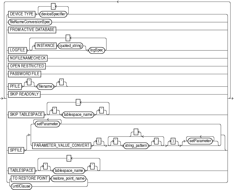

This subclause includes options that control aspects of the duplication such as naming the files and determining an end point for the duplication. Refer to the dupOptionList::= diagram for the syntax.
Several options in this clause are identical to options in the dupsbyOptionList. Descriptions of these options are not repeated here.Specify new filenames or convert source database filenames for the datafiles and online redo logs when the filenames of the duplicate database must be different from the filenames of the source database (as when the destination host and source host are the same). If you do not specify filenames for the online redo logs and datafiles of the duplicate database, then RMAN uses the datafile names from the source database.
| DEVICE TYPEdeviceSpecifier | Allocates automatic channels for the specified device only (for example, DISKorsbt).This option is valid only if you have configured automatic channels and have not manually allocated channels. For example, if you  See Also:  |
| fileNameConversionSpec | Specifies one or more patterns to map source database filenames to duplicate database filenames (see Example 2-72).
 If a file in the specification list is not affected by the conversion parameter in  Note: If you specify the SPFILE clause, then  See Also:  |
| FROM ACTIVE DATABASE | Specifies that the files for the duplicate database should be provided directly from the source database and not from a backup of the source database (see Example 2-70). If you do not specify an UNTILtime, then RMAN chooses an end time for the duplication based on when the online datafiles are copied.See Also: "Prerequisites Specific to Active Database Duplication" for command prerequisites |
| LOGFILE | Specifies options for creating online redo logs when creating a duplicate database that is not a standby database (see Example 2-72). |
|    INSTANCE 'inst_name' | Creates online redo logs for the specified instance in a Real Applications Cluster (Oracle RAC) database. The instance name is a string of up to 80 characters. RMAN automatically uses the thread mapped to the specified instance. If no  This clause is relevant when you use  |
|    logSpec | Specifies the filenames and groups for the online redo log files. See Also:  |
| NOFILENAMECHECK | Prevents RMAN from checking whether the datafiles and online redo logs files of the source database are in use when the source database files share the same names as the duplicate database files (see Example 2-73). You are responsible for determining that the duplicate operation will not overwrite useful data. This option is necessary when you are creating a duplicate database in a different host that has the same disk configuration, directory structure, and filenames as the host of the source database. For example, assume that you have a small database located in the  /oracle/dbs/system_prod1.dbf /oracle/dbs/users_prod1.dbf /oracle/dbs/rbs_prod1.dbf Assume that you want to duplicate this database to  If duplicating a database on the same host as the source database, then make sure that  RMAN-10035: exception raised in RPC: ORA-19504: failed to create file "/oracle/dbs/tbs_01.f" ORA-27086: skgfglk: unable to lock file - already in use SVR4 Error: 11: Resource temporarily unavailable Additional information: 8 RMAN-10031: ORA-19624 occurred during call to DBMS_BACKUP_RESTORE.RESTOREBACKUPPIECE |
| OPEN RESTRICTED | Enables a restricted session in the duplicate database by issuing the following SQL statement: ALTER SYSTEM ENABLE RESTRICTED SESSION. RMAN issues this statement immediately before the duplicate database is opened. |
| PASSWORD FILE | Specifies that RMAN should use the password file on the source database to overwrite the password file currently used by the auxiliary instance (see Example 2-70). This option is only valid when FROM ACTIVE DATABASEis specified; otherwise, RMAN signals an error.If  |
| PFILEfilename | Specifies a text-based initialization parameter file used by the auxiliary instance (see Example 2-72). RMAN automatically shuts down and restarts the auxiliary instance during duplication. If the auxiliary does not use a server parameter file in the default location, then you must specify the text-based initialization parameter file that RMAN should use when starting the auxiliary instance. The initialization parameter file must reside on the same host as the RMAN client used to perform the duplication. If the auxiliary instance uses a server parameter file in the default location, then you do not need to specify  |
| SKIP READONLY | Excludes datafiles in current read-only tablespaces from the duplicate database (see Example 2-73). By default RMAN duplicates current read-only tablespaces. If a tablespace is currently read/write, but you use  Note: A record for the skipped read-only tablespace still appears in  |
| SKIP TABLESPACEtbs_name | Excludes the specified tablespace from the duplicate database (see Example 2-72). Note that you cannot exclude the SYSTEMtablespace,SYSAUXtablespace, undo tablespaces, and tablespaces with rollback segments.If you need to duplicate a database when some backups of the source database do not exist, then
 RMAN does not check for completeness. For example, you can duplicate a data tablespace but not the tablespace containing the index for the data, or duplicate a tablespace that contains only one partition of a partitioned table. |
| SPFILE | Copies the server parameter file from the source database to the duplicate database. Refer to the description of SPFILEindupsbyOptionList. |
|    PARAMETER_VALUE_CONVERT   string_pattern   [setParameter] | Replaces the first string with the second string in all matching initialization parameter values. Refer to the description of PARAMETER_VALUE_CONVERTindupsbyOptionList. |
| TABLESPACEtablespace_name | Specifies which tablespaces should be included in the specified database. Unlike SKIP TABLESPACE, which specifies which tablespaces should be excluded from the duplicate database, this option specified which tablespaces should be included and then skips the remaining tablespaces.Note: RMAN automatically includes the  |
| TO RESTORE POINTrestore_point_name | Specifies a restore point for backup-based duplication, with the SCN at which the restore point was created as the upper, inclusive limit. Because the limit is inclusive, RMAN selects only files that can be used to duplicate a database up to and including the corresponding SCN. Note: The same restrictions that apply to  |
| untilClause | Sets the end time, SCN, or log sequence number for point-in-time recovery in backup-based duplication (see Example 2-72). The UNTILclause is not supported in active database duplication.You can achieve the same result by running
 See Also:  |
