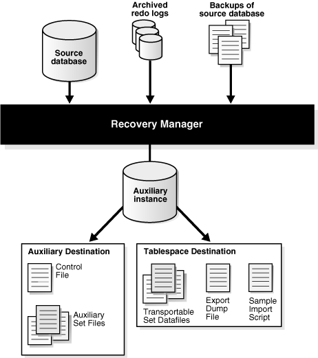

You must have a backup of all needed tablespaces and archived redo log files available for use by RMAN that can be recovered to the target point in time for the TRANSPORT
TABLESPACE
operation. Figure 24-1 illustrates the basic process of transportable tablespace creation.
Figure 24-1 RMAN Transportable Tablespace From Backup: Architecture
The process shown in Figure 24-1 occurs in the following phases:
RMAN starts an auxiliary instance.
An auxiliary instance is created by RMAN on the same host as the source database to perform the restore and recovery of the tablespaces. RMAN automatically creates an initialization parameter file for the auxiliary instance and starts it NOMOUNT
RMAN restores a backup of the source database control file to serve as the auxiliary instance control file and mounts this control file.
RMAN restores auxiliary set and transportable set datafiles from the backups of the source database.
The auxiliary set includes datafiles and other files required for the tablespace transport but which are not themselves part of the transportable tablespace set. The auxiliary set typically includes the SYSTEM
and SYSAUX
tablespaces, tempfiles, and datafiles containing rollback or undo segments. The auxiliary instance has other files associated with it, such as its own control file, parameter file, and online logs, but they are not part of the auxiliary set.
RMAN stores the auxiliary datafiles in the selected auxiliary destination. The auxiliary destination is a disk location where RMAN can store auxiliary set files such as the parameter file, datafiles (other than those in the transportable set), control files, and online logs of the auxiliary instance during the transport. If the transport succeeds, then RMAN deletes these files.
RMAN stores the transportable set files in the tablespace destination. The tablespace destination is a disk location that by default contains the datafile copies and other output files when the tablespace transport command completes.
RMAN performs database point-in-time recovery (DBPITR) at the auxiliary instance.
The recovery updates auxiliary and transportable set datafiles to their contents as of the target time specified for the TRANSPORT
DATABASE
command. If no target time is specified, then RMAN recovers with all available redo. RMAN restores archived redo logs from backup as necessary at the auxiliary destination (or other location) and deletes them after they are applied.
RMAN opens the auxiliary database with the RESETLOGS
options.
The datafiles now reflect the tablespace contents as of the target SCN for the tablespace transport operation.
RMAN places the transportable set tablespaces of the auxiliary instance into read-only mode. RMAN also invokes Data Pump Export in transportable tablespace mode to create the export dump file for the transportable set.
By default, the dump file is located in the tablespace destination. To specify the dump file location, see "Specifying Locations for Data Pump Files".
RMAN also generates the sample Data Pump import script for use when plugging in the transported tablespaces at a target database. The contents of this script are written to a file named impscript.sql
in the tablespace destination. The commands for the script are also included in the RMAN command output.
If the preceding steps are successful, then RMAN shuts down the auxiliary instance and deletes all files created during TRANSPORT
TABLESPACE
except for the transportable set files, the Data Pump Export file, and the sample import script.
