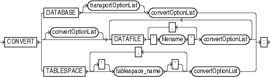

Oracle Database Administrator's Guide to learn how to transport tablespacesconvert::=
(transportOptionList::=, convertOptionList::=)

This clause specifies the objects to be converted: datafiles, tablespaces, or database.
| Syntax Element | Description |
| DATABASE | Converts the datafiles to the format of the destination platform and ensures the creation of other required database files. You use  Depending on the situation, you can use
 When using
|    transportOptionList | Specifies options that control the transport. See Also:  |
| [convertOptionList]DATAFILE 'filename'convertOptionList | Specifies the name of a datafile to be transported into a destination database (see Example 2-52). The  Use  You can use  SELECT NAME FROM V$DATAFILE_COPY WHERE CONVERTED_FILE='YES'; The
| TABLESPACEtablespace_nameconvertOptionList | Specifies the name of a tablespace in the source database that you intend to transport into the destination database on a different platform (see Example 2-51). Specify this option to produce datafiles for the specified tablespaces in the format of a different destination platform. You can then transport the converted files to the destination platform. You can only use  Use  The  Note: To convert the datafiles of a tablespace on the source host, use  |
| convertOptionList | Specifies options that control the conversion. See Also:  |

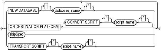

This clause specifies options for the datafiles, tablespaces, or database to be transported.
| NEW DATABASEdatabase_name | Specifies the DB_NAMEfor the new database produced by theCONVERTDATABASEcommand. |
| ON DESTINATION PLATFORM | Generates a convert script of CONVERT DATAFILEcommands (seeCONVERT SCRIPTparameter) that you can run on the destination host to create the database.Note: When this option is specified,  This option is useful for avoiding the overhead of the conversion on the source platform, or in cases in which you do not know the destination platform. For example, you may want to publish a transportable tablespace to be used by recipients with many different target platforms. When you run  |
|    CONVERT SCRIPT   script_name | Specifies the location of the file to contain the convert script generated by CONVERT DATABASE ... ON TARGET PLATFORM.If not specified, the convert script is not generated. |
| skipSpec | Specifies that CONVERT DATABASEshould skip inaccessible, offline, or read-only datafiles during the conversion process. |
| TRANSPORT SCRIPTscript_name | Specifies the location of the file to contain the transport script generated by CONVERT DATABASE. If omitted, the transport script is not generated. |
