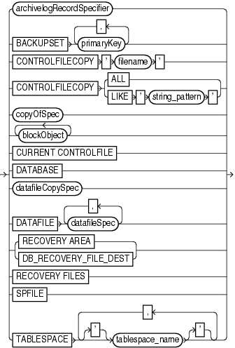

This subclause specifies database files for validation. Refer to validateObject::= for syntax.
| Syntax Element | Description |
archivelogRecordSpecifier |
Validates a range of archived redo logs. VALIDATE ARCHIVELOG is equivalent to BACKUP VALIDATE ARCHIVELOG. |
BACKUPSET primary_key |
Checks that the backup sets specified by primary_key exist and can be restored.
You can obtain the primary keys of backup sets by executing a The Use If you do not have automatic channels configured, then manually allocate at least one channel before executing Note: If multiple copies of a backup set exist, then RMAN validates only the most recent copy. The |
CONTROLFILECOPY{'filename' | ALL |LIKE 'string_pattern'} |
Validates control file copies. You can specify a control file copy in one of the following ways:
The control file copy can be created with the |

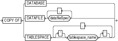

copyOfSpec |
Validates image copies of datafiles and control files.
See Also: |

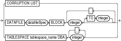

blockObject |
Validates individual data blocks.
See Also: |
CURRENT CONTROLFILE |
Validates the current control file. |
DATABASE |
Validates the database.
RMAN validates all datafiles and control files. If the database is currently using a server parameter file, then RMAN validates the server parameter file. Note: The online redo log files and tempfiles are not validated. |
datafileCopySpec |
Validates one or more datafile image copies.
When validating datafile copies, RMAN checks for block corruption but does not terminate the validation if corruption is discovered. Unlike See Also: |
DATAFILE datafileSpec |
Specifies a list of one or more datafiles that contain blocks requiring validation.
Note: You do not have to take a datafile offline if you are validating it. See Also: |
RECOVERY AREA |
Validates recovery files created in the current and all previous flash recovery area destinations. Recovery files are full and incremental backup sets, control file autobackups, archived redo logs, and datafile copies. Flashback logs, the current control file, and online redo logs are not validated. |
DB_RECOVERY_FILE_DEST |
Semantically equivalent to RECOVERY AREA. |
RECOVERY FILES |
Validates all recovery files on disk, whether they are stored in the flash recovery area or other locations on disk. Recovery files include full and incremental backup sets, control file autobackups, archived redo log files, and datafile copies. Flashback logs are not validated. |
SPFILE |
Validates the server parameter file currently used by the database. RMAN cannot validates other copies of the server parameter file, and cannot validate the server parameter file when the instance was started with an initialization parameter file. |
TABLESPACEtablespace_name |
Validates the specified tablespaces. RMAN translates tablespace names internally into a list of datafiles, then validates all datafiles that are currently part of the tablespaces. RMAN validates all datafiles that are currently members of the specified tablespaces. |
