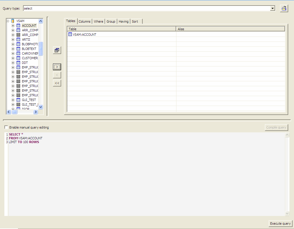

Connection test: This tests the physical connection to the data source.
Query test: This test runs an SQL SELECT query against the data source.
These tests are described in the following procedures.
See Also:
Setting Up a VSAM Data Source for information on how to add a data source.To test the physical connection to the data source
Open Oracle Studio for IMS, VSAM, and Adabas Gateways.

To test the VSAM data source by query
Expand the node of the required computer.
Expand the node of the required binding.
Expand the Data sources node.
Right-click the required data source entity, and select Query Tool.
The Select Workspace screen opens.
Select Navigator and click OK.
The Query Tool opens in the Editor pane, with the Build Query tab displayed (see Figure 4-1).
Select the required query type from the Query Type list. The default is a SELECT-type query.
Locate and expand the node of the required data source entity.
The data source tables are listed.
Select the required table and move it to the Table column by using the arrow button.
Click Execute query.
The Query Result tab opens, displaying the results of the query.
Close the Query Tool in the Editor pane.
