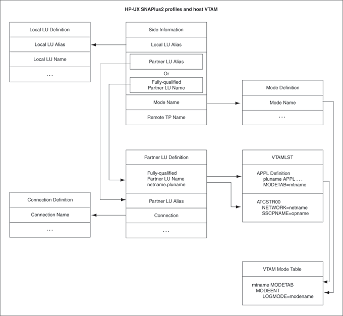

Ensure that your connection is working. Do this by starting the SNAPlus2 Node and then starting the individual link stations.
Figure 8-1 shows the relationship between SNAPlus2 definitions and the VTAM definitions on the remote host.
Figure 8-1 Relationship Between SNAPlus2 Definitions and Remote Host Definitions
