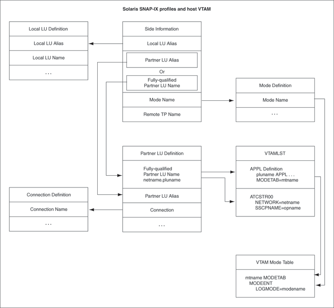

From the Services menu, select APPC and New Local LU. In the local LU dialog box, enter the name of the local LU and an alias. This name must correspond to the VTAM definitions on the remote gateway server host for the UNIX host.

Now define a Partner LU that represents the LU that the gateway server is using to communicate.
From the Services menu, select APPC and New Partner LUs and Partner LU on Remote Node.
In the Partner LU dialog box, enter the Partner LU name and characteristics. The Partner LU name contains the SNA Network Name as well as the LU name of the remote LU. Enable parallel session support. The location is the name as the Remote Node name. You can click Location for a list.
Click OK.

Now that the Mode has been defined, create the CPI-C Side Information Profile, which the gateway uses as a connection name. From the menu, select APPC and CPI-C.
In the CPI-C destination names dialog box, click New to add a new Profile.
In the CPI-C destination dialog box, enter the Profile name, Local LU name, Partner TP, Partner LU and mode, and Security option. The partner TP name is the name of the host transaction program or a dummy value to be overridden in the TIP.
For the Local LU, you may specify a specific LU or choose the default LU. For the Partner LU, enter either the full LU name or the alias created previously.
Enter ORAPLU62
for the mode name. Choose the type of security for these sessions to use. This affects how session authorization is done.

Figure 9-1 shows the relationship between SNAP-IX definitions and the VTAM definitions on the remote host.
Figure 9-1 Relationship Between SNAP-IX Definitions and Host VTAM Definitions
