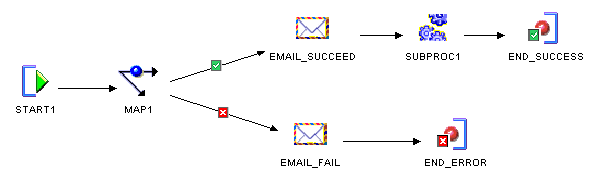

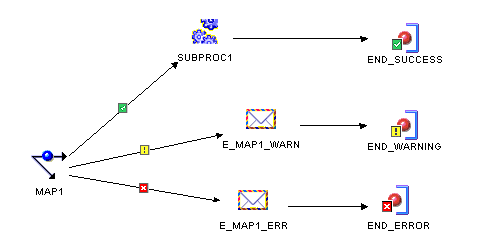

Figure 20-1 shows an example of a process flow that starts a mapping MAP1. If the mapping completes successfully, then Warehouse Builder sends an email notification EMAIL_SUCCEED and starts another process flow SUBPROC1. If the mapping fails, then Warehouse Builder sends an email EMAIL_FAIL and ends the process flow.
When you design a process flow in Warehouse Builder, you use an interface known as the Process Flow Editor. Alternatively, you can create and define process flows using the Warehouse Builder scripting language, OMB Scripting Language, as described in the Oracle Warehouse Builder API and Scripting Reference.
Process flow modules allow you to group process flow packages. Process flow packages, in turn, allow you to group process flows. Together, the process flow modules and packages provide two levels to manage and deploy process flows. You can validate, generate, and deploy process flows at either the module or the package level.
You can design a process flow that starts other process flows as long as they are in the same module. You can copy process flows from one package to another package in the same or a different module and you can copy packages to a different module. To do so, use the Copy and Paste commands available under Edit on the Design Center main menu.
For example, Figure 20-1 shows a process flow PROC1 that includes process flow SUBPROC1. For PROC1 to run successfully, SUBPROC1 and PROC1 can be in the same or separate packages but must be contained within the same module.

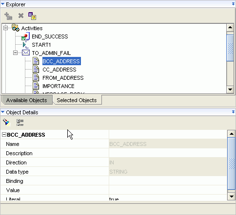

The editor lists the activity on the explorer pane located at the left side of the editor and in the object details pane along the left side.

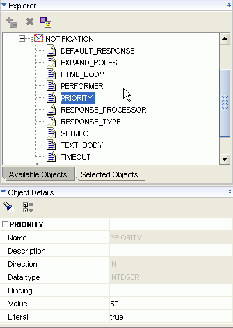

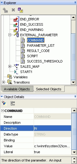

In Object Details pane, enter the parameters for the activity.
These parameters vary according to the type of activity. For each parameter, Warehouse Builder defines a read-only Name, Direction, and Data Type. And for each parameter, you can specify values for Binding, Literal, Value, and Description.
For example, Figure 20-2 shows the parameters for a notification activity which includes DEFAULT_RESPONSE, EXPANDED_ROLES, HTML_BODY, PERFORMER, PRIORITY, RESPONSE_PROCESSOR, RESPONSE_TYPE, SUBJECT, TEXT_BODY, and TIMEOUT.
Figure 20-2 The Parameters for a Notification Activity
Each parameter has the following properties:
This is a name property of the activity parameter. For information about a specific parameter, look up the activity by name under "Using Activities in Process Flows".
The direction property is read-only for parameters that are not created by the user. A direction of IN indicates that the parameter is an input parameter for the activity.
The data type property is read-only for parameters that are not created by the user. Warehouse Builder assigns the appropriate data type for all default parameters.

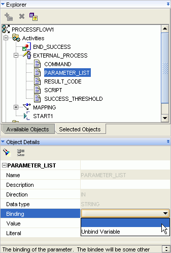

Use the binding property to pass in parameters from outside the process flow for parameters that are not created by the user. If you assign a parameter in Binding, then it overrides any text you assign to Value.
If you type in a value for the parameter in the field Value, then indicate whether the value is a literal or an expression. The literal data types follow the PL/SQL literal value specification except for calendar data types. These data types are represented in a standard format as the process flow interacts with data sources from different locations.

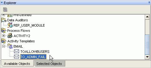

In designing process flows you may want to reuse existing activities. For example, each time a mapping fails in a process flow, you may want to send an email to the same group of administrators. You create a template for the email activity once and then use and edit the activity in many process flows.
To create an activity template:
In the Project Explorer, navigate to the Activity Templates node under the Process Flows node.
To create a folder for containing templates, right-click the Activity Templates node and select New.
Assign a name for the folder.
Consider creating a folder for each type of template you plan to create. For instance, you could create separate folders to contain email and ftp templates.
The Create Activity Template Wizard is displayed.
If the wizard does not appear automatically, then right-click a folder and select New.Follow the prompts in the Create Activity Template Wizard to complete the Name and Description Page, the Parameters Page, and the wizard summary page.
See "Using Activity Templates" for instructions about how to use the template in a process flow.

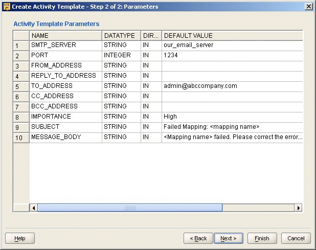

The wizard displays parameters based on the type of activity you previously selected in the Activity Templates.
Enter default values for the activity. When you use the activity template in a process flow, you can retain or edit the default values.
In Figure 20-3, for example, you could edit the default values for the email subject and message body to contain the name of the mapping.
Figure 20-3 Parameters Page for Email Activity Template

In the Process Flow Editor, click the Available Objects tab in the Explorer panel and expand Activity Templates.
Figure 20-4 displays the Explorer window with the activity template expanded.
Figure 20-4 Explorer Panel with an Activity Template Selected
Drag and drop the activity template onto the canvas.
Activity templates in a process flow acts like regular activities.
To edit the activity, be sure to click the Selected Objects tab in the Explorer window and then edit the activity in the Object Details panel.
Figure 20-5 displays the Explorer panel with the BCC_ADDRESS parameter of the EMAIL activity selected.

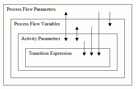

Process flows and activities support the PL/SQL parameter passing concept, allowing data to be passed and reused through parameterization. This is accomplished through data stores, which are implemented as either parameters or variables. Process flow allows the data to be passed between data stores.
Parameters allow passing of data between a process flow and its activities or subprocesses.
Variables allow the storage of transient data, which is then maintained for the lifetime of running the process flow. Variables are used to pass data between activities.
Figure 20-6 shows the direction in which the data is passed.
Figure 20-6 Relationship between the scope and the direction in which the data is passed
Process flows follow the following rules for allowing the data to be passed between data stores:
Process flow variables can be initialized from flow parameters, but the reverse is not allowed.
Activity parameters can pass data bidirectionally between process flow variables and process flow parameters.
Transition expressions can be evaluated against their source activity parameters, process flow parameters, and process flow variables.
A data store cannot be accessed from another data store within the same scope.
The namespace allows a data store of an inner scope to hide the data store of an outer scope, similar to PL/SQL. By qualifying the data store name with the process flow name or activity, you can reference the hidden data store name. For example:
My_PROC.VAR1
The namespace does not allow referencing of data from another data store within the same scope.
A data store may be bound to another data store in an outer scope, which supports the passing of data in both directions.
Process flow bindings follow the same semantics as PL/SQL with the following rules:
All the data is passed within the process flow by value.
Variables can be initialized through a binding. They cannot return a value.
An INOUT parameter can be bound to an IN parameter in an outer scope. The output value, which is passed by value, is audited and then discarded.
A variable may not pass data out to a Process Flow parameter. So, this is accomplished by the use of an Assign operator, which can be bound to the variable and the parameter.

Figure 20-7 shows a portion of a process flow in which different activities are triggered based on the three possible completion states of MAP1. Because only one of these conditions can be satisfied at a time, there is no conflict. If you attempt to add an unconditional transition or another conditional transition, two transition conditions would be true and the process flow would be invalid.
Figure 20-7 Outgoing Transition Conditions

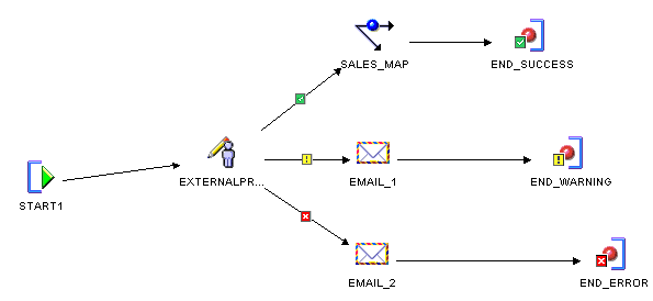

Process Activity: You design a process flow named OWF_EXT to execute batch commands in DOS that copies the generated file, saves it as s_data.dat, and deletes the originally generated file.
Your objective is to create logic that ensures the generated flat file is renamed appropriately before it triggers the execution of a mapping.
To extract data from a generated flat file with a name that varies with each generation, refer to the following sections:
Create a process flow that starts a mapping on the condition that the external process activity completes successfully. Your process flow should resemble Figure 20-8. For more information on creating the process flow, refer to "Instructions for Defining Process Flows".
Figure 20-8 Process Flow with External Process Transitioning to a Mapping
This section describes how to specify the DOS commands for renaming the generated file. The DOS commands you issue from the external process activity should be similar to the following:
copy c:\staging_files\sales*.* c:\staging_files\s_data.dat del c:\staging_files\sales*.*
The first command copies the temporary file into a file with a fixed name s_data.dat. The second command deletes the originally generated file.

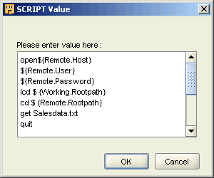

You can either direct Warehouse Builder to a file containing the script of commands or you can store the commands in the Warehouse Builder user interface. Choose one of the following methods:
Choose this method when you want to maintain the script in Warehouse Builder. Consider using this method when the script is small and need not be very flexible.
For this method, write or copy and paste the script into the Value column of the SCRIPT parameter. In the COMMAND parameter, type the path to the DOS shell command such as c:\winnt\system32\cmd.exe. Also, type the ${Task.Input} variable into the Value column of the PARAMETER_LIST parameter. Your Activity View should resemble Figure 20-9.
Figure 20-9 External Process Parameters When Script Maintained in this Product
Although this case study does not illustrate it, you can use substitution variables in the script when you maintain it in Warehouse Builder. This prevents you from having to update activities when server files, accounts, and passwords change.

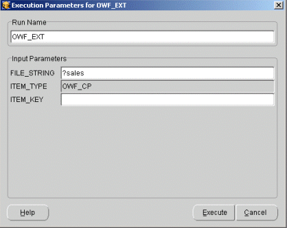

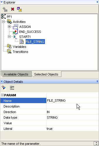

Select the start activity on the canvas to view and edit activity parameters in the Available Objects tab of the Explorer panel displayed in the Process Flow Editor.
To add a start parameter, click Add on the upper left corner of the Explorer pane in the Available Objects tab. Create a start parameter named FILE_STRING as shown in Figure 20-10. During execution, Warehouse Builder will prompt you to type a value for FILE_STRING to pass on to the %1 parameter in the rename_file.bat script.
Figure 20-10 Start Activity in the Activity View
Select the external process activity on the canvas and edit its parameters as shown in Figure 20-11.
For the COMMAND parameter, type the path to the script in the column labeled Value. If necessary, use the scroll bar to scroll down and reveal the column. For this example, type c:\staging_files\rename_file.bat.
For PARAMETER_LIST, click the row labeled Binding and select the parameter you defined for the start activity, FILE_STRING
Accept the defaults for all other parameters for the external process. Your Activity View for the external process activity should resemble Figure 20-11.
Figure 20-11 External Process Parameters When Calling an Outside Script

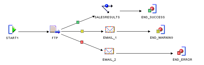

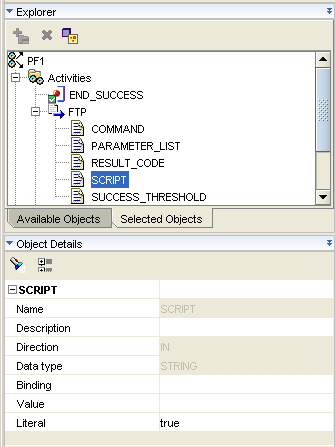

In Warehouse Builder, you can design a process flow that executes file transfer protocol (FTP) commands and then starts a mapping. For the process flow to be valid, the FTP commands must involve transferring data either from or to the server with the Runtime Service installed. To move data between two computers, neither of which host the Runtime Service, first transfer the data to the Runtime Service host computer and then transfer the data to the second computer.
You can design the process flow to start different activities depending upon the success or failure of the FTP commands.

Use the Process Flow Editor to create a process flow with an FTP activity that transitions to the salesresults mapping on the condition of success. Your process flow should appear similar to Figure 20-13.
Figure 20-13 Process Flow with FTP Transitioning to a Mapping

To define a script within the FTP activity:
Select the FTP activity on the canvas to view and edit activity parameters in the Available Objects tab of the Explorer panel in the Process Flow Editor.
For the COMMAND parameter, type the path to the FTP executable in the column labeled Value. If necessary, use the scroll bar to scroll to the right and reveal the column labeled Value.
For windows operating systems, the FTP executable is often stored at c:\winnt\system32\ftp.exe.
For the PARAMETER_LIST parameter, type the Task.Input variable.
When defining a script in Warehouse Builder and using Windows FTP, you must type ?"-s:${Task.Input}"? into PARAMETER_LIST.
For UNIX, type ?"${Task.Input}"?.
Navigate and highlight the SCRIPT parameter. Your Available Objects tab should display similar to Figure 20-14.
Figure 20-14 Activity View for FTP Activity Using a Script
Click the Ellipses displayed to the right of the Value field displayed in the Object Details panel.
Warehouse Builder displays the SCRIPT Value editor. Write or copy and paste FTP commands into the editor.
Figure 20-14 shows a script that opens a connection to the remote host, changes the directory to the local computer, changes the directory to the remote host, transfers the file, and closes the connection.
Notice that the script in Figure 20-15 includes ${Remote.User} and ${Remote.Password}. These are substitution variables. Refer to "Using Substitution Variables" for more details.
Figure 20-15 SCRIPT Value Editor Using Substitution Variables

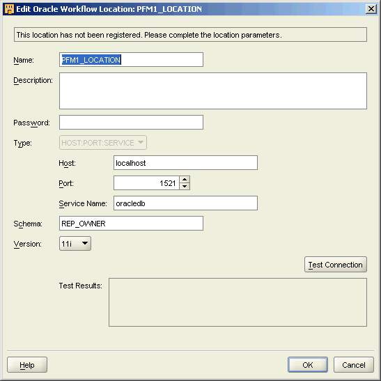

Figure 20-16 shows the registration information for the REMOTE_LOCATION. For the LOCAL_FILES, only the root path is required.
Figure 20-16 Example Location Registration Information
Now you can run the process flow.
