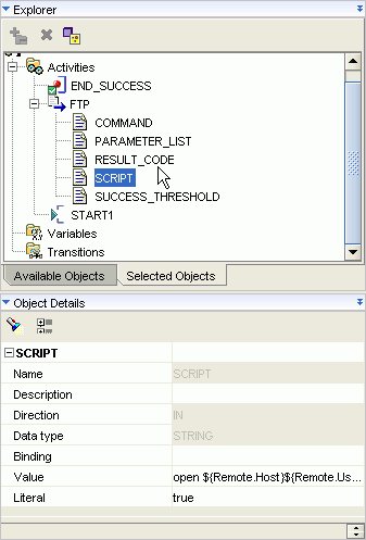

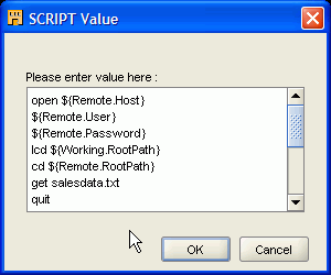

Starts a file transfer protocol command during a process flow. For example, use the FTP activity to move data files to the computer where a mapping runs. |

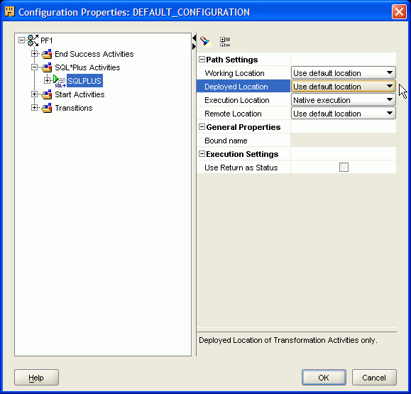

Runs a SQL*Plus script in a process flow. |
Represents an activity that is not predefined and enables you to incorporate it into a process flow. |
Because it is not desirable to allow a user have complete control over OS activities, Warehouse Builder allows you to determine which OS activities can be initiated by a process flow. This is primarily achieved by constraining the user's ability to execute operating system commands either by granting or revoking direct execution or by mandating that execution be performed through a third party, as described in Setting a Security Constraint. Further access control can be achieved using a proxy command and parameters, which can be used to secure all executions.
This security feature is controlled by setting properties in the Runtime.properties file in the $owb_home/owb/bin/admin directory. This file contains Control Center property values that run the Control Center service. This file is set to read-only at Control Center service startup. If you make changes to the file, then you must restart the Control Center service for the changes to take effect.
By default, security_constraint for the OS activity commands are set to DISABLED:
property.RuntimePlatform.0.NativeExecution.FTP.security_constraint = DISABLED property.RuntimePlatform.0.NativeExecution.Shell.security_constraint = DISABLED property.RuntimePlatform.0.NativeExecution.SQLPlus.security_constraint = DISABLED
To enable an OS activity, you must set security_constraint to NATIVE_JAVA or Scheduler.
property.RuntimePlatform.0.NativeExecution.FTP.security_constraint = NATIVE_JAVA property.RuntimePlatform.0.NativeExecution.Shell.security_constraint = NATIVE_JAVA property.RuntimePlatform.0.NativeExecution.SQLPlus.security_constraint = NATIVE_JAVA
NATIVE_JAVA allows direct execution by the Control Center service and SCHEDULER forces execution through DBMS_SCHEDULER.
For each activity type, USER DEFINED (Shell), FTP, and SQLPlus, there are two properties. The proxy_command property and the proxy_parameter_list property (optional).
If a proxy command is specified, then that command is run instead of the user's specified command and parameters. The user specified command and parameters are passed as parameters to the proxy command following the proxy parameters. The proxy command then becomes the context in which the user's command is run.
The proxy_command property allows the proxy command to be specified.
To set a proxy command for the activities, set the proxy command as well as the proxy parameter list (optional) using the following command:
property.RuntimePlatform.0.NativeExecution.FTP.proxy_command property.RuntimePlatform.0.NativeExecution.FTP.proxy_parameter_list property.RuntimePlatform.0.NativeExecution.Shell.proxy_command property.RuntimePlatform.0.NativeExecution.Shell.proxy_parameter_list property.RuntimePlatform.0.NativeExecution.SQLPlus.proxy_command property.RuntimePlatform.0.NativeExecution.SQLPlus.proxy_parameter_list
For example, to set a proxy command for Shell:
property.RuntimePlatform.0.NativeExecution.Shell.proxy_command = /bin/proxy_sh property.RuntimePlatform.0.NativeExecution.Shell.proxy_parameter_list = ?-v?-n?

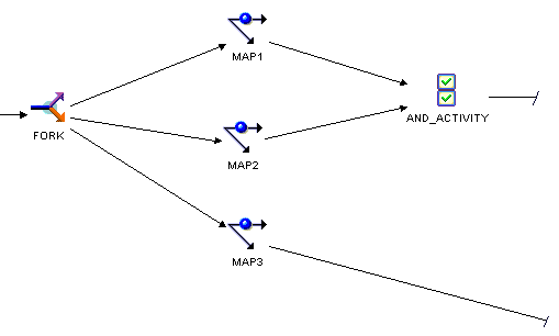

The AND activity can have two or more incoming transitions. To correctly design process flows with an AND activity, you must place a FORK activity upstream of the AND. Also, the number of transitions going into the AND activity must be less than or equal to the number of outgoing transitions from the upstream FORK. The FORK is the only activity that enables you to assign multiple unconditional transitions and therefore ensure the completion of multiple activities as required by the AND activity.
The AND activity enables you to aggregate the outcome of the upstream activities. If all the upstream activities return SUCCESS, then the AND activity returns SUCESSES. If any upstream activity returns an ERROR, then the AND activity returns ERROR, else a WARNING is returned. Any activity that does not have an outcome is considered to have returned SUCCESS. Use the SET_STATUS activity to force an outcome. The feature is particularly useful to test if a set of mappings that are running in parallel have all successfully completed.
Figure 21-1 shows the AND and FORK activities in a process flow. In this example, AND_ACTIVITY triggers downstream activities based on the completion of MAP1 and MAP2. The process flow is valid because the FORK activity has three outgoing transitions while AND_ACTIVITY has two incoming transitions. The process flow would also be valid if the transition and activities associated with MAP3 were deleted.
Figure 21-1 AND Activity in a Process Flow

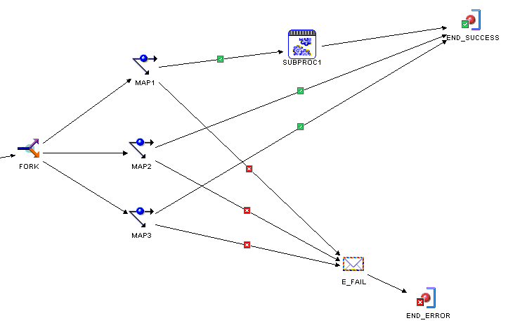

In Figure 21-2, END_SUCCESS has three incoming transitions, each dependent on the successful completion of upstream activities. END_ERROR has one incoming transition from an email activity that runs when any of the upstream mapping activities completes with errors.
Figure 21-2 End Activities in a Process Flow

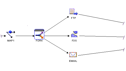

Use the FORK activity to start multiple, concurrent activities after the completion of an activity.
You can assign multiple incoming transitions to a FORK activity. The FORK activity is the only activity that enables you to assign multiple unconditional outgoing transitions for parallel process. For example, in Figure 21-3, the process flow carry out the activities named FTP, FDS, and EMAIL in parallel after completing MAP1.
Figure 21-3 FORK Activity Ensures Parallel Process

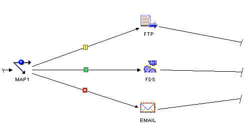

Figure 21-4 shows the same activities without the FORK activity. In this case, only one of the activities runs based on the completion state of MAP1.
Figure 21-4 Absence of FORK Activity Results in Conditional Process

SCRIPT |
You can type the required script for FTP in this parameter. To type or paste text, select Value at the bottom of the Object Details panel. The Process Flow Editor does not limit you on the amount of text you can enter. Each carriage return in the script is equivalent to pressing the |
Figure 21-5 shows an example of the FTP activity parameter settings for calling a script written within Warehouse Builder.
Figure 21-5 Activity View for FTP Activity Using a Script
Figure 21-6 shows the first line of the script in the VALUE column of the SCRIPT parameter. To view the entire script, click the Colon button to the right of the Value column. Warehouse Builder displays the SCRIPT Value editor that you can use to write or copy and paste a FTP script such as the script displayed in Figure 21-6.
Figure 21-6 SCRIPT Value Editor Using Substitution Variables
Notice that the script inFigure 21-6 includes ${Remote.User} and ${Remote.Password}. These are substitution variables. See "Using Substitution Variables" for more details.
Substitution variables are available only when you choose to write and store the FTP script in Warehouse Builder.
Use substitution variables to prevent having to update FTP activities when server files, accounts, and passwords change. For example, consider that you create 10 process flows that utilize FTP activities to access a file on salessrv1 under a specific directory. If the file is moved, without the use of substitution variables, you must update each FTP activity individually. With the use of substitution variables, you need only update the location information.
Substitution variables are also important for maintaining password security. When an FTP activity is run with substitution variables for the server passwords, it resolves the variable to the secure password you entered for the associated location.

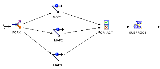

Use the OR activity to start an activity based on the completion of one or multiple number of upstream activities. You can assign multiple incoming transitions and only one unconditional outgoing transition to an OR activity.
The OR activity has similar semantics to the AND activity except that the OR activity propagates the SUCCESS, WARNING, or ERROR outcome of the first upstream activity that is completed.
An OR activity in a process flow ensures that downstream activities are triggered only once for each run of a process flow.
Figure 21-7 The OR activity in an process flow
The Process Flow Editor enables you to omit the OR activity and assign transitions from each of the three Mapping activities to SUBPROC1 shown in Figure 21-7. However, this logic would start SUBPROC1 three times within the same run of a process flow. Avoid this by using an OR activity.

The Process Flow in SQLPlus activity is carried out by the configuration item in the Deployed Location.
To set the location that will run the SQLPlus activity:
In Project Explorer, expand the Process Flow module.
In the Process Flow module, select Process Flow.
Right-click Process Flow and select Configure.
In Configuration Properties window, expand SQL*Plus activity.
Select SQLPLUS.
Figure 21-8 Configuring the Deployed Location
Under Path Settings, set the Deployed Location option to the location that will run the SQLPLUS Activity.

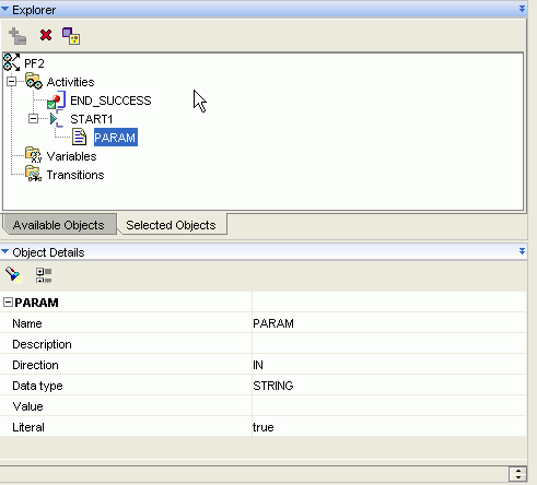

By default, each process flow includes one start activity. You can set input parameters for the start activity that become the input parameters for the complete process flow.
To add parameters to a Start activity:
In Project Explorer, double-click the Process Flow to open the Process Editor.
In Explorer pane, click Selected Objects tab.
In Selected Objects tab, expand the Activities folder.
Select Start activity and click create button (the tiny green "Plus" button at the left top corner) on the Explorer pane.
The Process Flow Editor adds a parameter under the Start activity.
Figure 21-9 Parameter added to a Start activity
In Object Details pane, set the properties for the parameter.
Change the parameter name and data type as necessary. You cannot alter its direction. The direction is IN, indicating that the parameter is an input parameter only. For value, type the parameter value. You can overwrite this value at runtime.
You can now use the parameter as input to other activities in the process flow.

Table 21-19 lists the parameters you set for the FTP activity.
Table 21-19 User Defined Process Activity Parameters
| Parameter | Description |
Command |
The command to carry out the user defined process you defined. Type the path and file name such as |
Parameter List |
The list of parameters to be passed to the user defined process. Type the path and file name such as The Process Flow Editor interprets the first character you type to be the separator. For example, the Process Flow Editor interprets the following entry as
Use the backslash as the escape character. For example, the Process Flow Editor interprets the following entry as /-l/-s/\// You can also enter the substitution variables listed in Table 21-20. |
Success Threshold |
Designates the completion status.Type in the highest return value from the operating system that indicates a successful completion. When the operating system returns a higher value, it indicates that the command failed. The default value is |
Script |
You can enter a script here or type in a file name for a script. If you type in a file name, use the ${Task.Input} variable in the parameter list to pass the file name. To type in or paste text, select Value at the bottom of the Activity panel. The Process Flow Editor does not limit you on the amount of text you can enter. Each carriage return in the script is equivalent to pressing the |
Table 21-20 lists the substitute variables you can enter for the FTP activity.
Table 21-20 Substitute Variables for the User Defined Process Activity
| Variable | Value |
${Working.Host} |
The host value for the location of the Control Center Service host. |
${Working.User} |
The user value for the location of the Control Center Service host. |
${Working.Password} |
The password value for the location of the Control Center Service host. |
${Working.RootPath} |
The local working directory. |
${Task.Input} |
A temporary file created from the SCRIPT parameter. Enter the Task.Input variable to direct Warehouse Builder to the script you write in the SCRIPT parameter. For Windows, enter into Parameter_List ?"-s:${Task.Input}"? and for UNIX, enter into Parameter_List ?"${Task.Input}"? where the question mark as the separator. |
