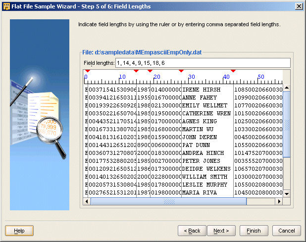

The Flat File Sample Wizard enables you to view a sample of the flat file and define record organization and file properties. The wizard enables you to sample and define common flat file formats such as string and ascii.
For files with complex record structures, the Flat File Sample Wizard may not be suitable for sampling the data. In such cases, see "Adding Existing Binary Files to the Workspace".

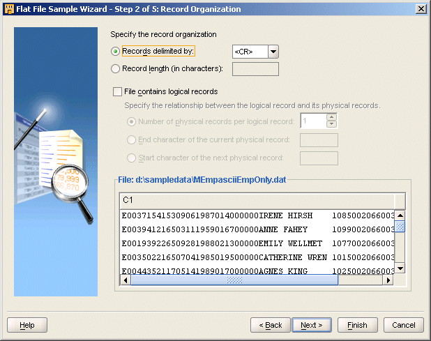

Indicate how to organize the records in the file. Select between the two options to indicate how the length of each record in the file is determined:
Records delimited by: Select this option to designate the end of each record by a delimiter. Then specify that record delimiter. You can accept the default record delimiter, new line (\n), or you can type in a new value.
Record length (in characters): Select this option to create a file with all records having the same length. Then specify the number of characters in each record. For files with multibyte characters, count a multibyte character as one character.
By default, the wizard creates a file in which each physical record corresponds to one logical record. You can override the default to create a file composed of logical records that correspond to multiple physical records.
Number of physical records for each logical record: The data file contains a fixed number of physical records for each logical record.

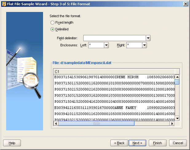

Select between Fixed Length and Delimited formats for the file.
To create a delimited file, specify the following properties:
Field delimiter: Field delimiters designate where one field ends and another begins. You can type in a field delimiter or select one from the list. The list displays common field delimiters. However, you may type in any character as a delimiter except the ones used for enclosures. The default is the comma (,).
Enclosures (Left and Right): Some delimited files contain enclosures that denote text strings within a field. If the file contains enclosures, enter an enclosure character in the text box or select one from the list. The list displays common enclosures. However, you may type in any character. The default for both the left and right enclosure is the double quotation mark (").

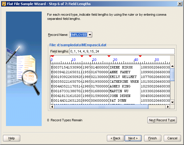

Indicate whether the file you create is to contain a single record type or multiple record types. If the file should contain only one type of record, select Single Record.
If the file should contain more than one record type, select Multi Record. Use multiple record types to create a flat file with more than one record type. For each record type you want to create, specify values under Record Type Location and then its type value and record name.
Valid entries for Record Type Location depend the field format you selected on the File Properties page, fixed length or delimited fields. For example, if you specified the fields are delimited, indicate the start position and length for the record type. For fixed-length files, indicate the field position.

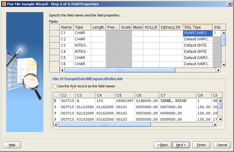

Use the Field Properties page to define properties for each field.
Since you can use a flat file in a mapping either directly as a flat file source or indirectly via an external table, the Field Properties page shows both SQL*Loader Properties and SQL Properties. Use the scroll bar to scroll to the right and view all the properties.
The wizard deactivates properties that do not apply to a given data type. For example, you can edit the Length for a CHAR
, but precision and scale are not available. Deactivated properties are grayed out.
The first set of properties the wizard displays are for the SQL*Loader utility. When you use the flat file directly as a source in a mapping, SQL*Loader and the properties you set here are used. SQL*Loader properties include Type, Start, End, Length, Precision, Scale, Mask, NULLIF, and DEFAULTIF.
By default, the wizard displays these properties as they appear in the source file. Edit these properties or accept the defaults to specify how the fields should be handled by the SQL*Loader.
Describes the data type of the field for the SQL*Loader. You can use the wizard to import many data types such as CHAR
, DATE
, DECIMAL
EXTERNAL
, FLOAT EXTERNAL
, INTEGER EXTERNAL
, ZONED
, and ZONED EXTERNAL
. For complete information about SQL*Loader field and data types, see Oracle Database Utilities. Currently, only portable data types are supported.
In fixed length files, indicates the field start position.
In fixed length files, indicates the field end position.
For delimited files, specifies the maximum field length to be used by SQL* Loader.
Defines precision for DECIMAL and ZONED data types.
Defines the scale for DECIMAL and ZONED data types.
The SQL*Loader uses dd-mon-yy as its default date mask. You can override this default by entering a valid date mask when you describe the file. For example, if the input data has the format DD-Mon-YYYY rather than the SQL*Loader default, you can enter the true format as a mask.
You can override the default action of the SQL*Loader by placing a NULLIF condition on a field. For example, when a character field contains all blanks, you can direct SQL*Loader to mark the field as null rather than storing the blanks. Valid syntax for this field includes =BLANKS, ='quoted string', =X'ff' to indicate hexadecimal values, and != for 'not equal to' logic.
You can override the default action of the SQL*Loader by placing a DEFAULTIF condition on a field. For example, when a numeric or DATE field contains all blanks, SQL*Loader rejects the entire record. To override this action, type =BLANKS in the DEFAULTIF property. When SQL*Loader evaluates this condition, it sets the numeric field to zeros and loads the record. Valid syntax for this field includes =BLANKS, ='quoted string', =X'ff' to indicate hexadecimal values, and != for 'not equal to' logic.
The second set of properties are the SQL properties that include SQL Type, SQL Length, SQL Precision, and SQL Scale. These properties specify how the fields in a flat file translate to the columns in a relational table for example.
The SQL properties you set here have the following implications for mapping design, validation, and generation:
External table: If you create an external table based on a single flat file record type, the columns properties are based on the SQL properties you defined for the flat file. For more information about external tables, see "Using External Tables".
Populating an Empty Mapping Table. In a mapping, if you populate an empty relational table with the metadata, the table inherits the SQL properties you defined for the flat file source.
Flat file target: If you use the flat file as a target in a mapping, the target does not inherit the SQL properties. Instead, all fields inherit the default SQL*Loader data type. For more information about using a flat file operator as a target, see "Flat File Operator".

Use the Record Organization page to indicate how records are organized in the file you are sampling.
Figure 8-1 Record Organization Page for the Flat File Sample Wizard
Records delimited by: Select this option if the end of each record is designated by a delimiter. Then specify that record delimiter. You can accept the default record delimiter, carriage return (<CR>), or you can type in a new value.
Record length (in characters): Select this option if each record in the file is the same length. Then specify the number of characters in each record. For files with multibyte characters, count a multibyte character as one character.
The Flat File Sample Wizard enables you to sample files composed of logical records that correspond to multiple physical records. If the file contains logical records, click File contains logical records. Then select one of the options to describe the file.
The wizard updates the display of the logical record in the lower panel to reflect your selection. The default selection is one physical record for each logical record.
After you complete the logical record information, click Next to continue with the wizard.

Use the File Format page to select between Fixed Length and Delimited formats for the file. The Flat File Sample Wizard does not sample multi-byte character file with a fixed record format. Instead, consider "Using the Create Flat File Wizard".
Figure 8-2 File Format Page for the Flat File Sample Wizard
When you select a file format, the wizard updates the sample displayed at the bottom of the wizard page. You can use the scroll bars to navigate the sample data.
When your file is delimited, specify the following properties:

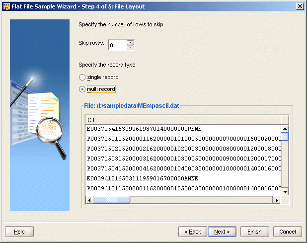

Use the File Layout page to specify the number of rows to skip and to select between a single record type versus multiple record types.
Figure 8-3 File Layout Page for the Flat File Sample Wizard
Indicate the number of records to skip in Skip rows. This is useful for skipping over unwanted header information. If one of the records includes field names, skip the preceding header records so that the record containing field names is first in the file. Later in the wizard, on the Field Properties page, you can instruct the wizard to use that record for field names if you are defining a single record file type.
Indicate whether the file contains a single record type or multiple record types.
If the file contains only one type of record, select Single.
If the file contains more than one record type, select Multiple. Later in the wizard you can instruct the wizard to scan the file for the record types. For more information about multiple record types, see "Selecting Record Types (Multiple Record Type Files Only)".

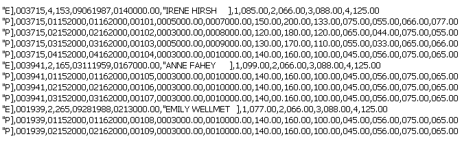

Figure 8-4 shows an example of a comma delimited file with two record types, "E" and "P". In this case, instruct the wizard to scan the first field. The wizard returns "E" and "P" as the type values.
When you use the wizard to sample flat files with multiple record types, ensure that the sample size you specified on the Name page is large enough to include each record type at least once. The default is 10,0000 characters.

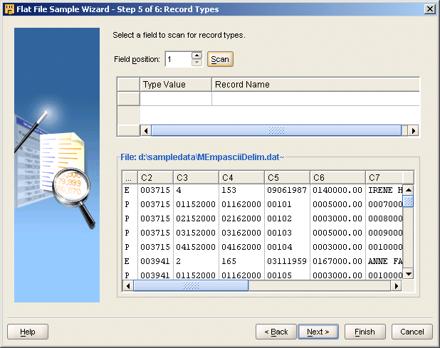

When a delimited flat file contains several different types of records, you can use the scanning feature within the Flat File Sample Wizard to search and label record types.
Figure 8-5 Record Types Page for Delimited Files
To complete the Records Type page for a delimited file:
Select the one field that identifies the record types in the file.
The wizard displays all the fields in a sample in the lower panel of the page. Select the field from the sample box. Or, in Field position, you can type in the position as it appears in the sample. Unless you specify otherwise, the wizard defaults to the first field in the file.
The wizard scans the file for the field and displays the type values. The wizard assigns default record names (RECORD1, RECORD2...) to each type value.
You can edit the record names.
Click a record name to rename it or select a different record name from the list. You can associate a record name with multiple record type values. You can also add or delete type values using the New and Delete buttons.
Click Next to continue with the wizard.

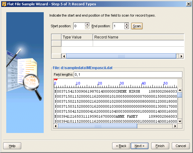

When a fixed-length flat file contains several different types of records, you can use the scanning feature within the Flat File Sample Wizard to search for record types and assign a type value to each record type.
Figure 8-6 Record Types Page for Fixed Length Files
To complete the Records Type page for a fixed-length file:
Specify the one field that identifies the record types in the file. Type in values for the Start position and End position. If you want to scan for records based on the first field, enter 0 for Start Position.
The wizard indicates the selected field with a red tick mark in the ruler in the file sample in the lower panel of the page.
Click Scan.
The wizard scans the file field and displays the type values. The wizard assigns default record names (RECORD1, RECORD2...) to each type value.
When you use the Flat File Sample Wizard to define a fixed-length flat file, you also need to define the length of each field in the file.
This step is not necessary for delimited files. Proceed to "Specifying Field Properties".You can define field lengths by typing in the field lengths or by using the ruler.
Figure 8-7 Field Lengths Page for the Flat File Sample Wizard
If you know the length of each field, type in the field length in Field Lengths. Separate each length by commas. The wizard displays the changes to the sample at the bottom of the wizard page.
To use the ruler, click any number or hash mark on the ruler. The wizard displays a red tick mark on top of the ruler and marks the boundary with a red line. If you make a mistake, double-click the marker to delete it or move the marker to another position. Use the ruler to create markers for each field in the file.
Note that when you specify a field length using the ruler, your tick markers indicate the starting and ending borders for each field. From this information, the positions occupied by each field is determined. For example, a three-character field occupying positions 6, 7, and 8 is internally identified with the beginning and ending values of '5,8'.
You can select the record type by name from Record Name. Or, you can select Next Record Type from the lower right corner of the wizard page. The number of records with unspecified field lengths is indicated on the lower left corner of the wizard page.
If the flat file contains multiple record types, the wizard prompts you to specify field lengths for each record type before continuing.
Figure 8-8 Field Lengths for Multiple Record Files page
Use the Field Properties page in the Flat File Sample Wizard to define properties for each field. The wizard assigns a name to each field. It assigns 'C1'to the first field, 'C2' to the second, and so on. To rename fields, click a field and type a new name.
For single record file types, you can instruct the wizard to use the first record in the file to name the fields. Indicate this by checking the box entitled Use the first record as the field names. If you select this option, all the field data type attributes default to CHAR
The wizard deactivates properties that do not apply to a given data type. For example, you can edit the length for a CHAR
Once you complete the Field Properties page, verify your selections on the Summary page and select Finish. The Flat File Sample Wizard returns you to the Import Metadata Wizard described in "Importing Definitions from Flat Files". You can select more files to sample or select Finish to begin the import.Figure 8-9 Field Properties Page for the Flat File Sample Wizard
, DATE
, DECIMAL EXTERNAL
, FLOAT EXTERNAL
, INTEGER EXTERNAL
, ZONED
Specifies the length of the field to be used by SQL* Loader. For delimited files, the field length is not populated, but you can manually edit it if you know the maximum length of the field.
