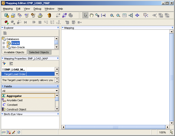

Figure 16-1 displays the Mapping Editor canvas.
The Mapping Editor has the following standard components common to most editors in Warehouse Builder:
Title Bar: At the top of the editor, the title bar displays the name of the mapping and the access privileges you have on the mapping.
Menu Bar: Below the title bar, the menu bar provides access to the editor commands. You can access the menu bar by clicking on one of its options or by using hot keys. For example, to access the Mapping menu, press Alt +M.
Toolbar: Below the menu bar, the toolbar provides icons for commonly used commands.
Canvas: The canvas provides the work space where you design and modify mappings.
Indicator Bar: Along the lower edge of the editor you can see mode icons, indicators, and descriptions.

When you first start the editor, Warehouse Builder displays the explorer in the upper left corner. The explorer provides a tree listing of all the activities on the canvas and their parameters. When you select an activity on the canvas, Warehouse Builder navigates to the activity on the explorer.
When you first start the editor, Warehouse Builder displays the properties inspector in the lower left corner. The properties inspector displays the properties for the mapping, its operators, and attributes in the operators. Select an object either from the canvas or the explorer and Warehouse Builder displays the properties in the properties inspector.
When you first start an editor, Warehouse Builder displays the palette along the left side and it contains operators that you can drag and drop onto the canvas.You can relocate the palette anywhere on the editor. You can choose to hide or display the palette by clicking on Operator Palette listed under View in the menu bar.
The Bird's Eye View enables you to move the view of the canvas with a single mouse dragging operation. You can thus reposition your view of the canvas without using the scroll bars.
The Bird's Eye View displays a miniature version of the entire canvas. It contains a blue colored box that represents the portion of the canvas that is currently in focus. In the case of mappings that span more than the canvas size, you can click the blue box and drag it to the portion of the canvas that you want to focus on.
The Data Viewer enables you to view the data stored in the data object. See "Data Viewer" for more information about the Data Viewer.
The Generation panel displays the generation and validation results for a data object. This panel is hidden when you first open the editor window. It is displayed the first time you generate or validate a data object. You can to show or hide the Generation panel by selecting Window and then Generation Results from the editor menu.
The Generation window contains two tabs: Script and Message. The Script tab displays the generated scripts to implement the data object selected in the canvas. The Message tab displays the validation messages for the selected data object. Double-click a message to view the complete message text.

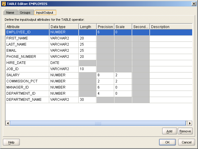

Figure 16-3 shows an Input/Output tab on the Operator Editor. In this example, the operator is a table and therefore has only the Input/Output tab. Other operators can have an Input tab and an Output tab.
Figure 16-3 Input/Output Tab on the Operator Editor
You can add, remove, and edit attributes. The Mapping Editor grays out properties that you cannot edit. For example, if the data type is NUMBER, you can edit the precision and scale but not the length.
To assign correct values for data type, length, precision, and scale in an attribute, follow PL/SQL rules. When you synchronize the operator, Warehouse Builder checks the attributes based on SQL rules.

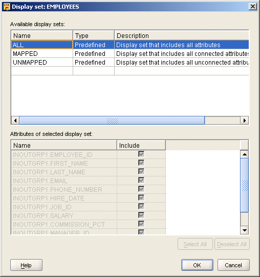

A display set is a graphical representation of a subset of attributes. Use display sets to limit the number of attributes visible in an operator and simplify the display of a complex mapping.
By default, operators contain three predefined display sets, ALL, MAPPED, and UNMAPPED. Table 16-1 describes the default display sets.
| Display Set | Description |
ALL |
Includes all attributes in an operator. |
MAPPED |
Includes only those attributes in an operator that are connected to another operator. |
UNMAPPED |
Includes only those attributes that are not connected to other attributes. |
You can define display sets for any operator in a mapping.
To define a display set:
Right-click an operator, and select Display Set.
The Display Set dialog box is displayed as shown in Figure 16-4.
Click the row below UNMAPPED and enter a name and description for the new display set.
All available attributes for the operator appear in Attributes of selected display set. The Type column is automatically set to User defined.
You cannot edit or delete a Predefined attribute set.
In the Include column, select each attribute you want to include in the display set.
Click Select All to include all attributes and Deselect All to exclude all the attributes.
Click OK.
The group for the operator now lists only those attributes contained within the Attribute Set selected for display.

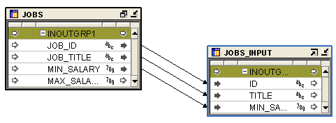

You can draw a line from a single output attribute of one operator to a single input attribute of another operator.
To connect attributes:
Click and hold down the mouse button while the pointer is positioned over an output attribute.
Drag the mouse away from the output attribute and toward the input attribute to which you want data to flow.
As you drag the mouse, a line appears on the Mapping Editor canvas to indicate a connection.
Release the mouse over the input attribute.
Repeat steps one through three until you create all the required data flow connections.
Figure 16-5 displays a mapping with attributes connected.
Figure 16-5 Connected Operators in a Mapping

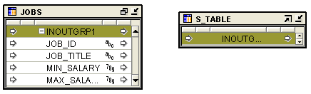

Use the Add Table Operator dialog box to select and bind the source table operator in the mapping. From the Add Table Operator dialog box, select Create unbound operator with no attributes.
The mapping should now resemble Figure 16-6 with one source table and one staging area table without attributes.
Figure 16-6 Unbound Staging Table without Attributes and Source Table
With the mouse button positioned over the group in the source operator, click and hold down the mouse button.
Drag the mouse to the staging area table group.
Warehouse Builder copies the source attributes to the staging area table and connects the two operators.

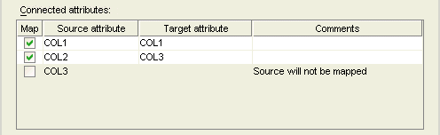

Figure 16-7 displays the Connected attributes section.
You can deselect attributes by clearing the Map check box. View the results of your selections under Comments.
When you select OK, Warehouse Builder copies the source attributes to the target group and connects the attributes.

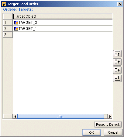

To specify the loading order for multiple targets:
Click whitespace in the mapping canvas to view the mapping properties in the Mapping Properties panel in the upper left corner.
Go to the Map Targets Load Order property and click the Ellipsis button on the right of this property.
Warehouse Builder displays the Targets Load Order dialog box which shows TARGET2 loading before TARGET1.
Figure 16-8 displays the Target Load Order dialog box.
To change the loading order, select a target and use the shuttle buttons on the right to move the target up or down on the list.
Use the Reset to Default button to instruct Warehouse Builder to recalculate the target loading order. You may want to recalculate if you made an error reordering the targets or if you assigned an order and later change the mapping design such that the original order became invalid.

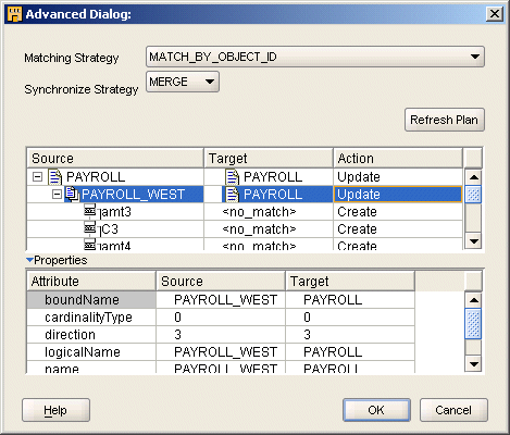

By default, Warehouse Builder selects the option for you to synchronize your selected operator with its associated object in the workspace. You can accept the default or select another workspace object from the list box.
In this step you also specify whether to perform inbound or outbound synchronization. Inbound synchronization synchronizes the data object with the mapping operator. Outbound synchronization synchronizes the mapping operator with the data object.
As an optional step, set the Matching Strategies and Synchronize strategy.
Click OK.

Use the Synchronization Plan dialog box to view and edit the details of how Warehouse Builder synchronizes your selected objects. After you select from the Matching Strategies, click Refresh Plan to view the actions Warehouse Builder takes.
In the context of synchronizing, source refers to the object from which to inherit differences and target refers to the object to be changed.
For example, in Figure 16-9, the flat file PAYROLL_WEST is the source and the flat file operator PAYROLL is the target. Therefore, Warehouse Builder creates new attributes for the PAYROLL operator to correspond to fields in the flat file PAYROLL_WEST.
Figure 16-9 Advanced Synchronizing Options
Set the matching strategies to determine how Warehouse Builder compares an operator to a workspace object. If synchronization introduces changes such as adding or deleting attributes in an operator, Warehouse Builder refreshes the Mapping Editor. If synchronizing removes an operator attribute, data flow connections to or from the attribute are also removed. If synchronizing adds an operator attribute, the Mapping Editor displays the new attributes at the end of the operator. Data flow connections between matched attributes are preserved. If you rename an attribute in the source object, it is interprets it as if the attribute were deleted and a new attribute added.
You can specify the following strategies for reconciling an object in a mapping:
This strategy compares the unique object identifiers of an operator attributes with those of a workspace object. Match by object identifier is not available for synchronizing an operator and workspace object of different types such as a view operator and a workspace table.
Use this strategy if you want the target object to be consistent with changes to the source object and if you want to maintain separate business names despite changes to physical names in the target object.
Warehouse Builder removes attributes from the source object that do not correspond to attributes in the target object. This can occur when an attribute is added to the source or removed from the workspace object without properly synchronizing the change.
This strategy matches the bound names of the operator attributes to the physical names of the workspace object attributes. Matching is case-sensitive.
Use this strategy if you want bound names to be consistent with physical names in the workspace object. You can also use this strategy with a different workspace object if there are changes in the workspace object that would change the structure of the operator.
Warehouse Builder removes attributes of the operator that cannot be matched with those of the workspace object. Attributes of the selected workspace object that cannot be matched with those of the operator are added as new attributes to the operator. Because bound names are read-only after you have bound an operator to a workspace object, you cannot manipulate the bound names to achieve a different match result.
This strategy matches operator attributes with columns, fields, or parameters of the selected workspace object by position. The first attribute of the operator is synchronized with the first attribute of the workspace object, the second with the second, and so on.
Use this strategy to synchronize an operator with a different workspace object and you want to preserve the business names in the operator attributes. This strategy is most effective when the only changes to the workspace object are the addition of extra columns, fields, or parameters at the end of the object.
If the target object has more attributes than the source object, then Warehouse Builder removes the excess attributes. If the source object has more attributes than target object, Warehouse Builder adds as new attributes.

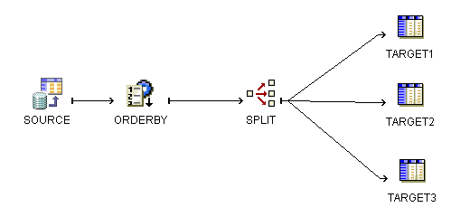

Warehouse Builder enables you to design ETL logic and load the data in the exact temporal order in which the transactions were stored at source. To achieve this result, you design a mapping that orders and conditionally splits the data before loading it into the target. Then, you configure the mapping to generate code in row-based operating mode. In row-based operating mode, Warehouse Builder generates code to process the data row by row using if-then-else constructions, as shown in the following example.

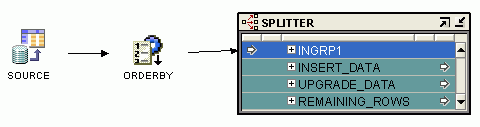

In this mapping, you move the transaction data from an external source, through an operator that orders the data, followed by an operator that conditionally splits the data before loading it into the target table. Figure 16-10 shows you how the source is ordered and split.

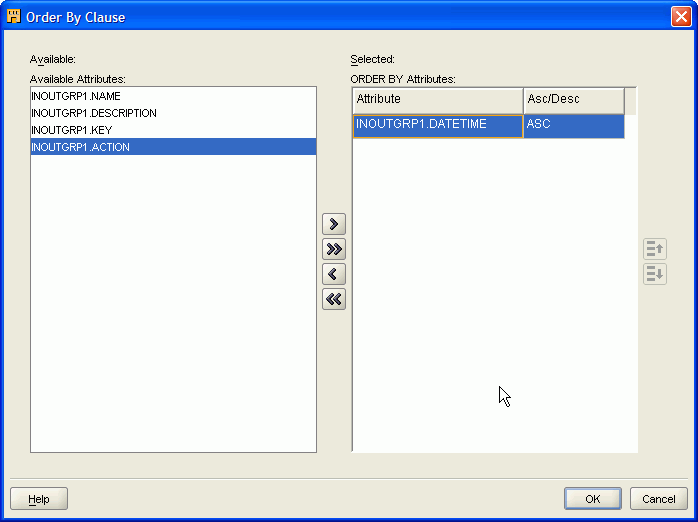

The Sorter operator enables you to order the data and process the transactions in the exact order in which they were recorded at source. The Splitter operator enables you to conditionally handle all the inserts, updates, and deletes recorded in the source data by defining a split condition that acts as the if-then-else constraint in the generated code. The data is conditionally split and loaded into the target table. In this mapping, the same target table is used three times to demonstrate this conditional loading. The mapping tables TARGET 1, TARGET 2, and TARGET 3 are all bound to the same workspace table TARGET. All the data goes into a single target table.
The following steps show you how to build this mapping.
Create a mapping called LOAD_JOURNAL_EXT using the Create Mapping dialog box. Warehouse Builder then opens the Mapping Editor where you can build your mapping.
Step 5: Add an External Table Operator
Drag and drop a mapping external table operator onto the mapping editor and bind it to the external table JOURNAL_EXT.
Add the Sorter operator to define an order-by clause that specifies the order in which the transaction data must be loaded into the target. Figure 16–11 shows you how to order the table based on the timestamp of the transaction data in ascending order.
Step 7: Define a Split Condition
Add the Splitter operator to conditionally split the inserts, updates, and deletes stored in the transaction data. This split condition acts as the if-then-else constraint in the generated code. Figure 16-12 shows how to join the SOURCE operator with the ORDERBY operator which is linked to the SPLITTER operator.
Figure 16-12 Adding the Splitter Operator
Define the split condition for each type of transaction. For outgroup INSERT_DATA, define the split condition as INGRP1.ACTION = 'I'. For UPDATE_DATA, define the split condition as INGRP1.ACTION = 'U'. In Warehouse Builder, the Splitter operator contains a default group called REMAINING_ROWS that automatically handles all Delete ('D') records.
Step 8: Define the Target Tables
Use the same workspace target table three times for each type of transaction: one for INSERT_DATA, one for UPDATE_DATA, and one for REMAINING_ROWS.
