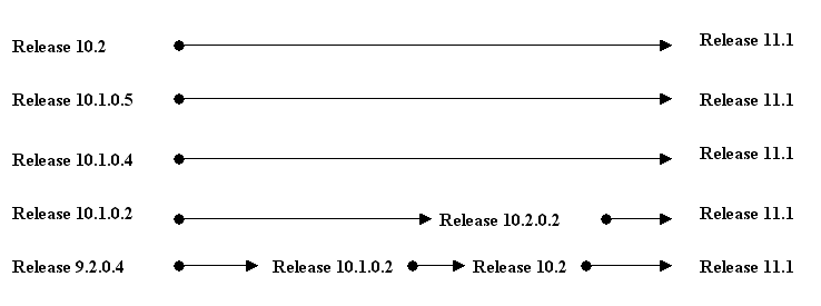

As a general rule, you can upgrade directly to the current release of Warehouse Builder from subsequent releases, beginning with Warehouse Builder 9.2.0.4 and onwards. You may encounter exceptions to this rule if you decide to migrate runtime audit data from early releases, as described in "Using the Control Center Upgrade Assistant".
To upgrade to Warehouse Builder 11g Release 1 (11.1), refer to the following sections:

Use this assistant to complete any of the scenarios illustrated in Figure 3-1. You can migrate audit data directly to Oracle Warehouse Builder release 11.1 from Oracle Warehouse Builder releases 10.2, 10.1.0.5, and 10.1.0.4.
Figure 3-1 Valid Paths for Migrating and Upgrading Runtime Audit Data

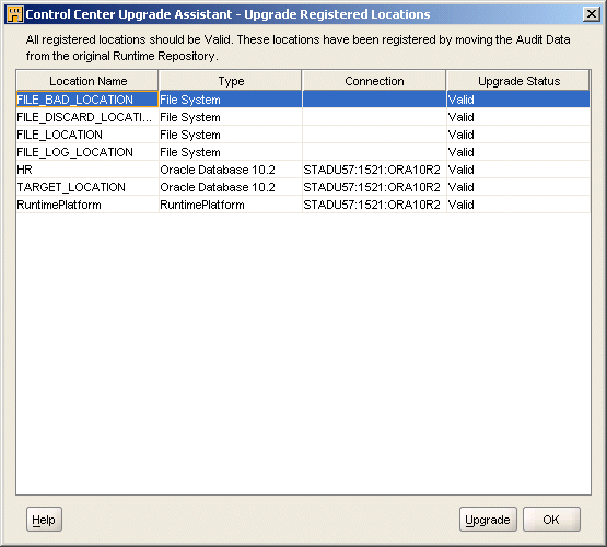

In this step, you upgrade runtime audit data so that the new control center displays the correct status, history, location details, and version numbers for objects you deployed and ran in the runtime repository or control center from the previous release.
This option is only available if the new control center does not contain any registered locations or audit data.
The assistant lists the locations registered in the new control center and displays whether they are valid or not. Figure 3-2 displays the Upgrade Registered Locations dialog.
Figure 3-2 Upgrade Registered Locations Dialog
Select a location and use this button to check and fix locations for possible errors. Ensure that all locations are valid before proceeding. Figure 3-3 displays the Registered Locations Details dialog.

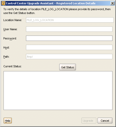

Figure 3-3 Registered Locations Details Dialog
This dialog box displays the registration details of the currently selected location. Select Get Status to evaluate its status and view the results of various tests.
For each location, the assistant checks that the password is valid and that it is the same as the registered password. The assistant verifies that the version registered for the location is the same as the actual version. If the assistant detects any errors, then you can select Upgrade to correct the errors.
