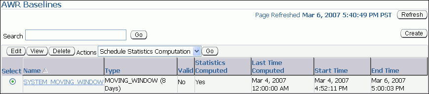

Under Statistics Management, click AWR Baselines.
The AWR Baselines page appears with a list of existing baselines displayed.

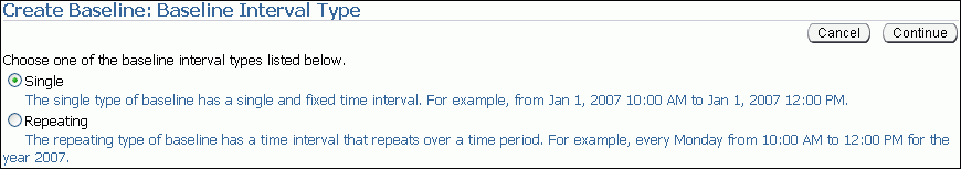

Click Create.
The Create Baseline: Baseline Interval Type page appears.
Select Single.
Click Continue.

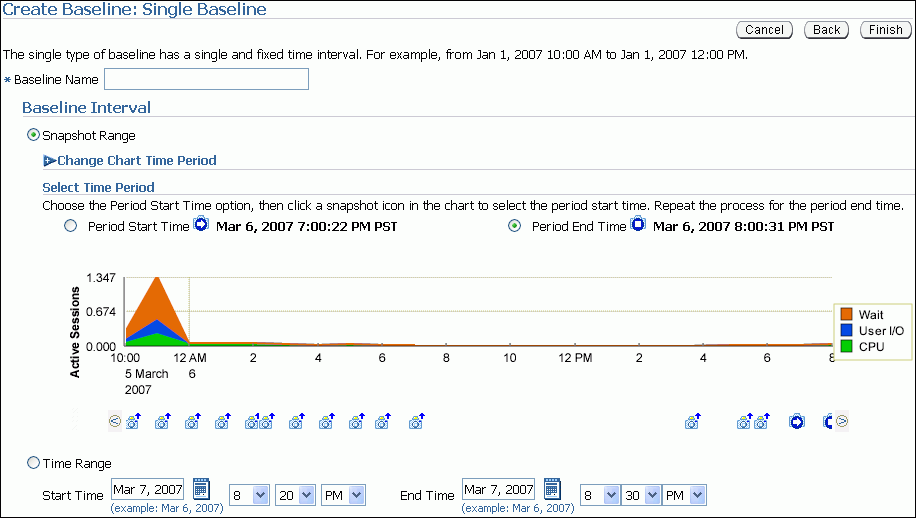

The Create Baseline: Single Baseline page appears.
In the Baseline Name field, enter a name for the baseline.

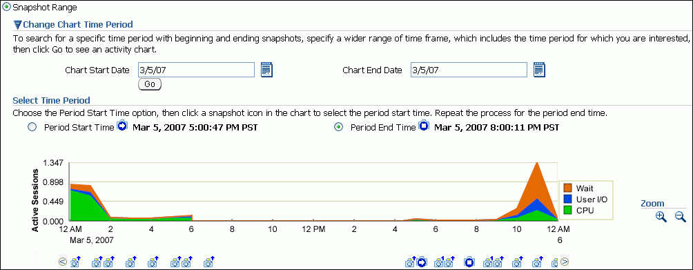

Under Baseline Interval, select whether to use a snapshot range or a time range for the baseline. Do one of the following:
To use a snapshot range, select Snapshot Range. Complete the following steps:
Optionally, to view older snapshots that are not displayed below the Active Sessions chart, expand Change Chart Time Period. Enter the desired start date in the Chart Start Date field and the desired end date in the Chart End Date field, and click Go.
Under Select Time Period, select a start time for the baseline by selecting Period Start Time and the snapshot icon below the Active Sessions chart that corresponds to the desired start time.
Select an end time for the baseline by selecting Period End Time and the snapshot icon below the Active Sessions chart that corresponds to the desired end time.
In this example, a snapshot range on March 5, 2007 from 5:00 p.m. to 8:00 p.m. is selected.

Click Create.
Select Repeating and then click Continue.

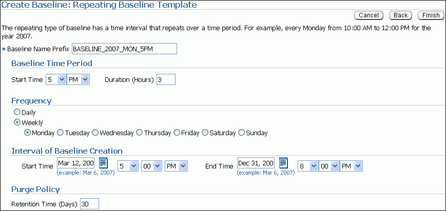

The Create Baseline: Repeating Baseline Template page appears.
In the Baseline Name Prefix field, enter a name prefix for the baseline.
Under Baseline Time Period, specify the time of the day that you want the baseline to begin collecting AWR data and the duration of the baseline collection.
Under Frequency, do one of the following:
Select Daily if you want the baseline to repeat on a daily basis.
Select Weekly if you want the baseline to repeat on a weekly basis and select the day of the week on which the baseline will repeat.
Under Interval of Baseline Creation, complete the following steps:
In the Start Time fields, select a date and time in the future when the data collection should begin.
In the End Time fields, select a date and time in the future when the data collection should end.
Under Purge Policy, enter the number of days to retain baselines that have been captured.
Click Finish.
A baseline template with the same name as the baseline name prefix will also be created. A baseline template is a specification that enables Oracle Database to automatically generate a baseline for a future time period.
In this example, a repeating baseline that repeats weekly on Mondays from 5:00 p.m. to 8:00 p.m. for the year 2007 will be created.

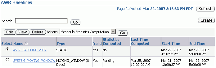

Select the baseline for which you want to compute statistics.
Select a baseline that does not already have computed statistics. These baselines are identified by No in the Statistics Computed column.
From the Actions list, select Schedule Statistics Computation, and then click Go.

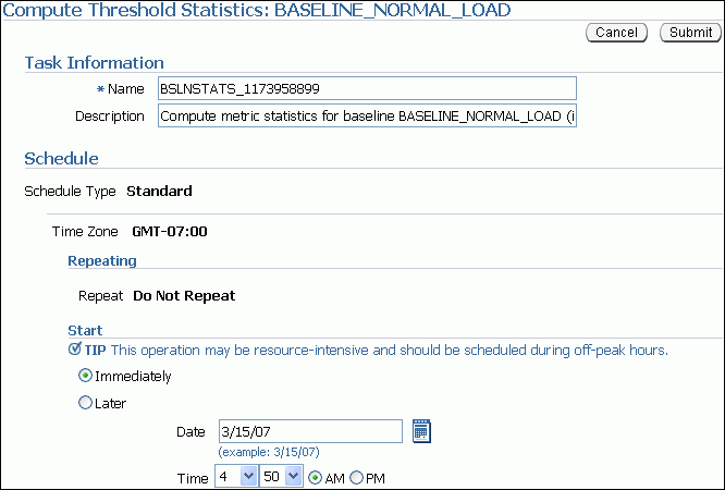

The Compute Threshold Statistics page appears.
In the Name field, enter a name for the task.
Alternatively, you can choose to use the system-generated name.
In the Description field, enter a description for the task.
Alternatively, you can choose to use the system-generated description.
Under Start, do one of the following:
Select Immediately to run the task immediately after it has been submitted.
Select Later to run the task at a later time as specified using the Date and Time fields.
Click Submit.
The AWR Baselines page appears. A message informs you that statistics computation has been scheduled for the selected baseline.

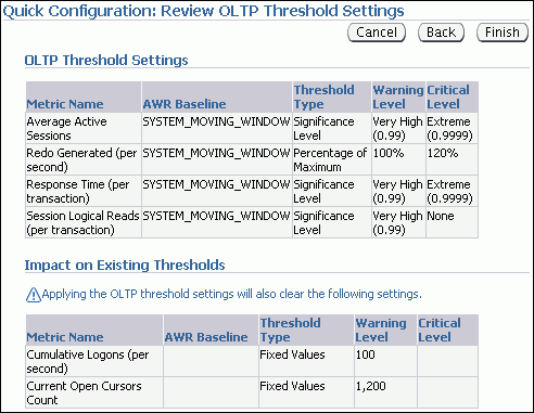

The Quick Configuration: Review OLTP Threshold Settings page appears.
Review the metric threshold settings and click Finish.

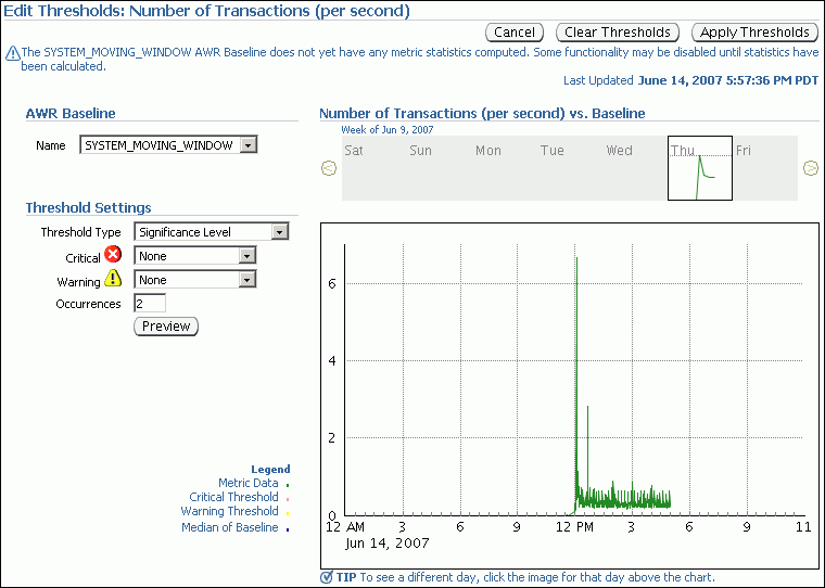

This section explains how to select a baseline and edit its thresholds. You can configure the type of threshold, for example, whether it is based on significance levels, percentage of maximum values, or fixed values. You can also configure the threshold levels that determine when the system generates critical alerts and warnings.
You can edit thresholds for the default moving baseline or a baseline that you created in the AWR Baselines page. You can select a baseline in the Edit Thresholds page after you have scheduled statistics computation from the AWR Baselines page and the statistics have finished computing on the static baseline.
To set a metric threshold for the default moving baseline:
On the Database Home page, under Related Links, click Baseline Metric Thresholds.
The Threshold Configuration tab of the Baseline Metric Thresholds page appears.
In the View list, select Basic Metrics.
The Baseline Metric Thresholds page appears.
In the Category/Name column, click the link for the metric whose threshold you want to set or change. For example, click Number of Transactions (per second).
The Edit Thresholds: Number of Transactions (per second) appears.
The charts on this page provide thumbnail and detailed views of metric activity for a 24-hour period. In the top thumbnail chart, click a day to view the value of the metric plotted against a 24-hour period.
Under AWR Baseline, in the Name list, select either the default SYSTEM_MOVING_WINDOW or the name of a baseline created in the AWR Baselines page.
A baseline appears in the AWR Baseline list after you have scheduled statistics computation from the AWR Baselines page and the statistics have finished computing on the static baseline.
In this example, select AWR_BASELINES_2007.
The page refreshes to show the charts for the baseline that you selected.
In the Threshold Settings section, complete the following steps:
In Threshold Type, leave Significance Level selected.
In Critical, select Extreme.
In Warning, select Very High.
In Occurrences, leave the current value.
Click Apply Thresholds.
You are returned to the Baseline Metric Thresholds page. This page shows the altered metric threshold settings.

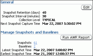

Under Statistics Management, click Automatic Workload Repository.
The Automatic Workload Repository page appears.
Under Manage Snapshots and Baselines, click the link next to Baselines.

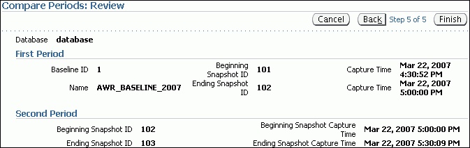

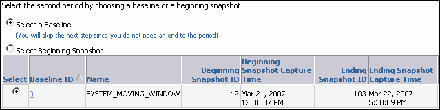

The Compare Periods: Second Period Start page appears. Under First Period, the selected baseline is displayed.
In this example, the baseline named AWR_BASELINE_2007 is selected.
Compare the baseline selected in the first period to another baseline or a pair of snapshots. Do one of the following:
To compare to another baseline, select Select a Baseline and the baseline you want to use in the second period, and then click Next.
In this example, the baseline named SYSTEM_MOVING_WINDOW is selected.
The Compare Periods: Review page appears. Go to Step 7.

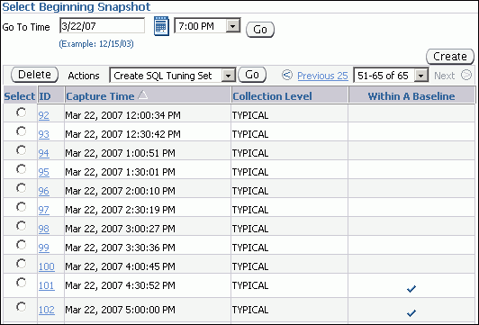

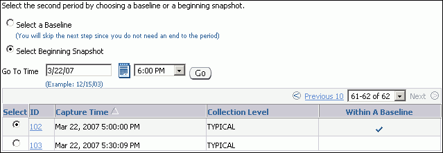

To compare to a pair of snapshots, select Select Beginning Snapshot and the beginning snapshot to use in the second period, and then click Next.
In this example, snapshot 102, taken on March 22, 2007 at 5:00 p.m., is selected.

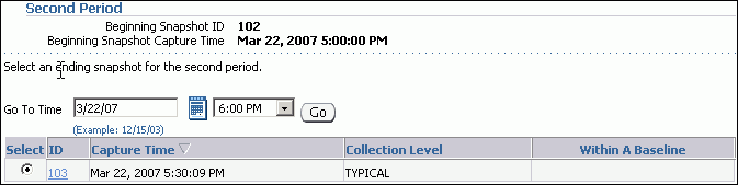

The Compare Periods: Second Period End appears. Proceed to the next step.
Select the ending snapshot for the snapshot period that will be included in the report and click Next.
In this example, snapshot 103, taken on March 22, 2007 at 5:30 p.m., is selected.
Review the periods to be included in the report and click Finish.

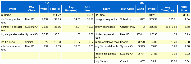

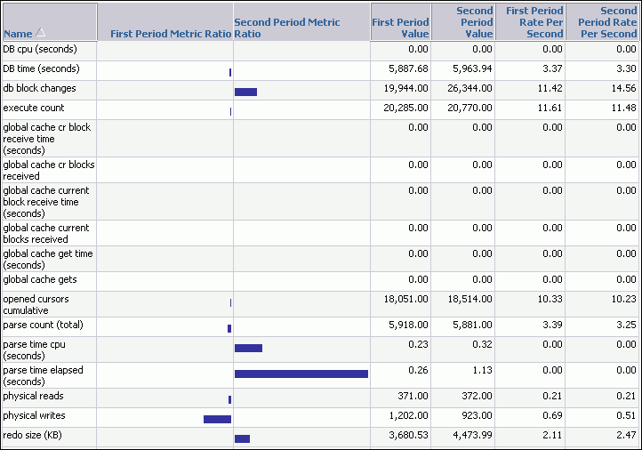

The Compare Periods: Results page appears.

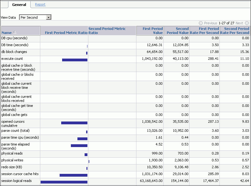

Data from the selected periods appears under the General subpage. You can view data per second or per transaction by selecting an option from the View Data list.
In this example, parse time in the second period is much higher than the first.

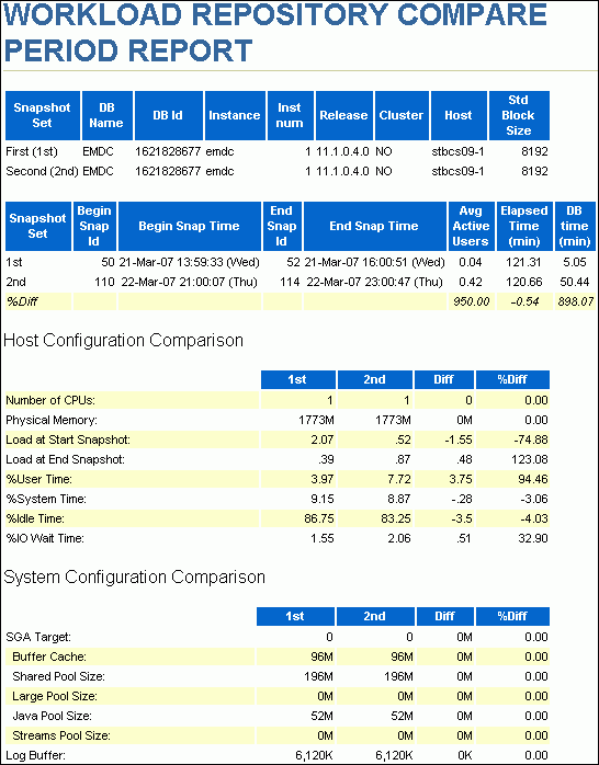

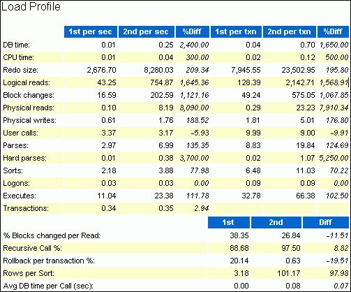

Click Report to view the report.
The Processing: View Report page appears while the report is being generated. After it completes, the report will appear. To change periods, click Change Periods. To save the report as an HTML file, click Save to File.

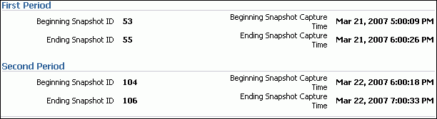

If an existing baseline is not available, then you can compare the database performance by using two arbitrary pairs of snapshots, one pair taken when the database is performing optimally, and another pair when the database is performing poorly. At least four existing snapshots must be available.
To compare performance using two pairs of snapshots:
Under Manage Snapshots and Baselines, click the link next to Snapshots.
The Snapshots page appears.
From the Go To Time list, select the time for the starting snapshot and click Go.
This action filters the snapshots and displays only the snapshot taken at the start of the comparison period. The time in this example is 5:00 p.m. on March 21, 2007.
Under Select Beginning Snapshot, select the starting point for the first snapshot period to be included in the report.
In this example, snapshot 53, taken on Mar 21, 2007 5:00 p.m., is selected.
From the Actions list, select Compare Periods and click Go.
The Compare Periods: First Period End page appears.
Select the ending point for the first snapshot period to be included in the report and click Next.
In this example, snapshot 55, taken on Mar 21, 2007 6:00 p.m., is selected.
Select the starting point for the second snapshot period to be included in the report and click Next.
In this example, snapshot 104, taken on March 22, 2007 at 6:00 p.m., is selected.
The Compare Periods: Second Period End page appears.
Select the end point for the second period that will be included in the report and click Next.
In this example, snapshot 106, taken on March 22, 2007 at 7:00 p.m., is selected.
Review the selected periods that will be included in the report and click Finish.
In this example, the first period shows significantly more activity, especially in session reads, than the second period.

Figure 8-1 shows an example of an AWR Compare Periods report.
The AWR Compare Periods report is divided into the following sections:
The report summary is at the beginning of the AWR Compare Periods report, and summarizes information about the snapshot sets and loads used in the report. The report summary contains the following sections:
The Snapshot Sets section displays information about the snapshot sets used for this report, such as instance, host, and snapshot information.
In the example shown in Figure 8-1, the first snapshot period corresponds to the time when performance was stable on March 21, 2007 from 1:59 p.m. to 4:00 p.m. The second snapshot period corresponds to the time when performance degradation occurred on March 22, 2007 from 9:00 p.m. to 11:00 p.m.
The Host Configuration Comparison section compares the host configurations used in the two snapshot sets. For example, the report compares physical memory and number of CPUs. Any differences in the configurations are quantified as percentages in the %Diff column.
The System Configuration Comparison section compares the database configurations used in the two snapshot sets. For example, the report compares the SGA and log buffer size. Any differences in the configurations are quantified as percentages in the %Diff column.
The Load Profile section compares the loads used in the two snapshot sets. Any differences in the loads are quantified as percentages in the %Diff column.
The Top 5 Timed Events section displays the five timed events or operations that consumed the highest percentage of total DB time in each of the snapshot sets.
In this example, CPU time is over eight times higher in the second period than in the first. The number of waits for the db file sequential read event in the second period is over double the number in the first.
