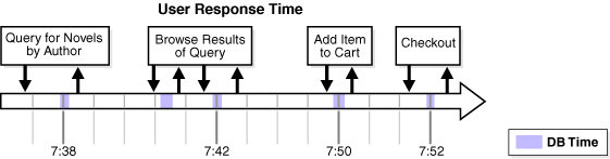

Time model statistics measure the time spent in the database by operation type. The most important time model statistic is database time, or DB time. Database time represents the total time spent in database calls, and is an indicator of the total instance workload. As shown in Figure 2-1, database time makes up a portion of an application's overall user response time.
Figure 2-1 DB Time in Overall User Response Time
A session is a specific connection of a user to an Oracle Database instance through a user process. Database time is calculated by aggregating the CPU time and wait time of all user sessions not waiting for idle wait events (user sessions that are not idle). For example, a user session may involve an online transaction made at a bookseller's Web site consisting of the actions shown in Figure 2-2.
Query for novels by author
The user performs a search for novels by a particular author. This action causes the application to perform a database query for novels by the author.
Browse results of query
The user browses the returned list of novels by the author and accesses additional details, such as user reviews and inventory status. This action causes the application to perform additional database queries.
Add item to cart
After browsing details about the novels, the user decides to add one of the novels to the shopping cart. This action causes the application to make a database call to update the shopping cart.
Checkout
The user completes the transaction by checking out, using the address and payment information previously saved at the bookseller's Web site from a previous purchase. This action causes the application to perform various database operations to retrieve the user's information, add a new order, update the inventory, and generate an E-mail confirmation.
For each of the preceding actions, the user makes a request to the database, as represented by the down arrow in Figure 2-2. The CPU time spent by the database processing the request and the wait time spent waiting for the database are considered DB time, as represented by the shaded areas. After the request is completed, the results are returned to the user, as represented by the up arrow. The space between the up and down arrows represents the total user response time for processing the request, which contains other components besides DB time, as illustrated in Figure 2-1.

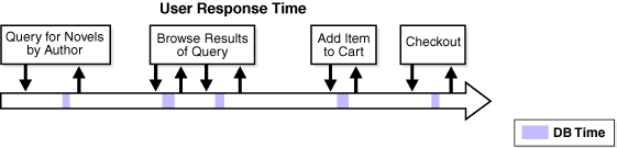

The Active Session History (ASH) statistics are samples of session activity in the database. The database samples active sessions every second and stores them in a circular buffer in the System Global Area (SGA). Any session that is connected to the database and using CPU, or is waiting for an event that does not belong to the idle wait class, is considered an active session. By capturing only active sessions, a manageable set of data is represented. The size of the data is directly related to the work being performed, rather than the number of sessions allowed on the system.
Using the DB time example described in "Time Model Statistics", samples of session activity are collected from the online transaction made at the bookseller's Web site, represented as vertical lines below the horizontal arrow in Figure 2-3.
The light vertical lines represent samples of inactive session activity that are not captured in the ASH statistics. The bold vertical lines represent samples of active sessions that are captured at:
7:38, while novels by the author are being queried
7:42, while the user is browsing the query results
7:50, when one of the novels is added to the shopping cart
7:52, during the checkout process
