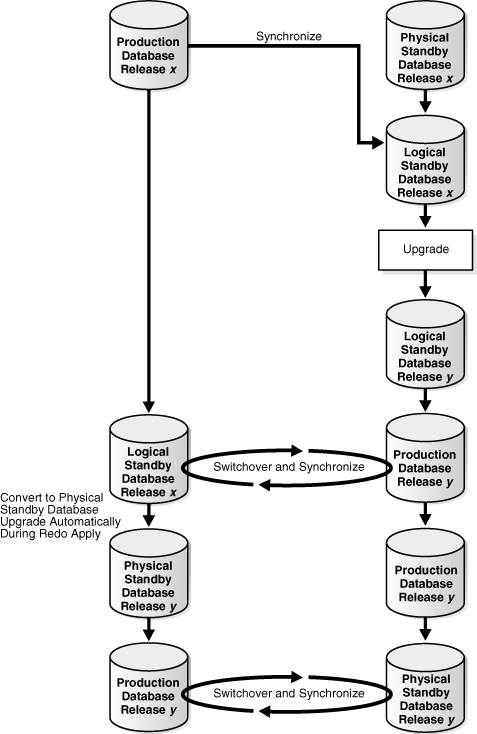

| Oracle patch set or software upgrade for the database | Oracle Database rolling upgrade with Data Guard SQL Apply (see Section 5.2.5, "Database Upgrades") | < 5 minutes |

When using SQL Apply to perform a rolling upgrade (see Section 5.2.5.2, "Data Guard SQL Apply or Transient Logical Standby Database")

Transient Logical Standby Database Rolling Upgrades
You can use a transient logical standby database to perform a rolling database upgrade using your current physical standby database by temporarily converting it to a logical standby database. Use a transient logical standby when your configuration only has a physical standby database. Performing a rolling upgrade using a transient logical standby is similar to the standard SQL Apply rolling upgrade with the following differences:
A guaranteed restore point is created on the primary database to flash the database back to a physical standby database after the switchover.
The conversion of a physical standby database to a logical standby database uses the KEEP IDENTITY clause to retain the same DB_NAME and DBID as that of its primary database.
The ALTER DATABASE CONVERT TO PHYSICAL STANDBY statement converts the original primary database from a logical standby to a physical standby database.
The original primary database is actually upgraded through Redo Apply after it is converted from the transient logical standby database role to a physical standby database.
Figure 5-1 shows the flow of processing that occurs when you perform a rolling upgrade with a transient logical standby database.
Figure 5-1 Using a Transient Logical Standby Database for Database Rolling Upgrade
This procedure is documented in Oracle Data Guard Concepts and Administration in the section about "Performing a Rolling Upgrade With an Existing Physical Standby Database."
